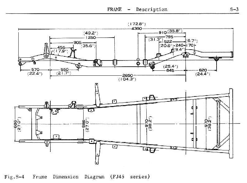

Found this on mud
attachment.php
https://forum.ih8mud.com/40-55-series-tech/120801-fj45-frame-dimensions.html
For the rest of us...translated by google...:D
