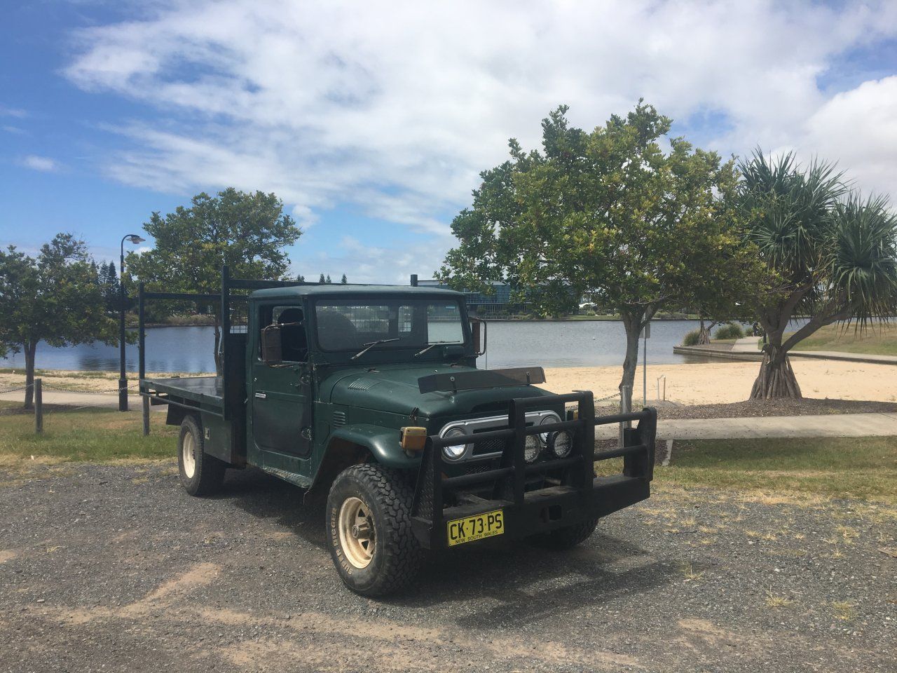

Hey guys, I've got the 2f 4.2L motor, I'm looking at Changing my gearbox and doffs to a later model landcruiser just wanting to know if any will fit straight in, or keeping the 4 speed gearbox and changing the diff centres to a later model of they will fit.
If anyone knows of anything or can help me out that would be great
