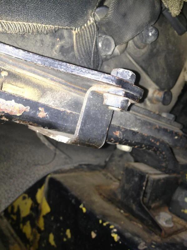

Yesterday I ran into my first question in all of this when taking a closer look at the DS seat.
The area circled in red: does a simple nut - bolt fastener go through these "tabs" to keep the sliding rail attached? Hope that makes sense, but I'm looking at diagrams on sor and other places and can't quite tell. I want to make sure I have all the pieces and parts before I dive into this and could not tell if something is suppose to be attached here.

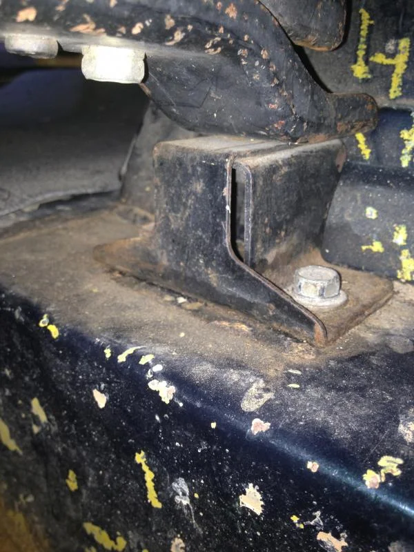

Nice seats :) did u find anybody to redo the seats?

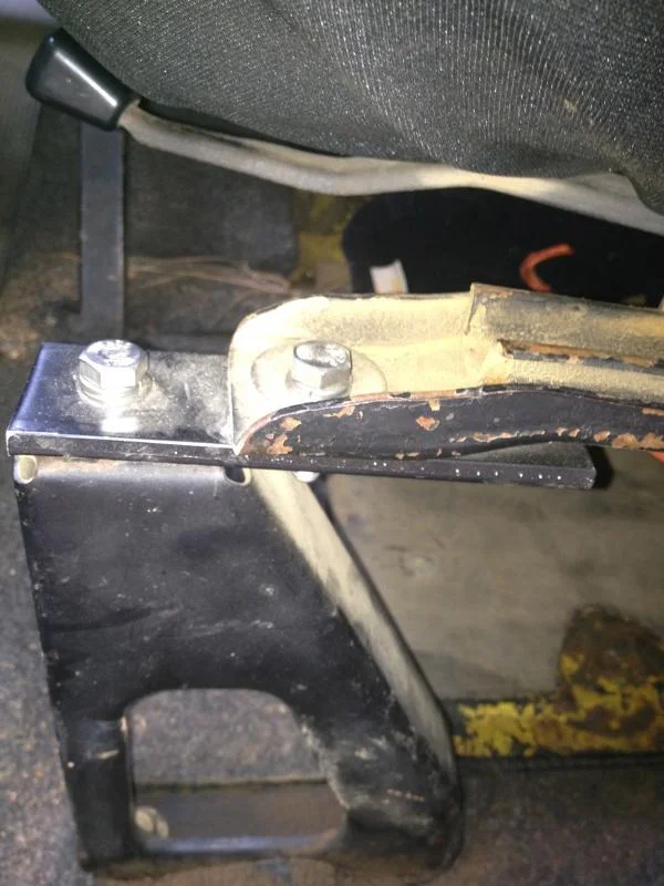

Yes, it's just a bolt to secure the two parts that wrap around the rail. I'd also recommend extending the seat track if you're 6' tall or more. I did it and now my right leg isn't so sore from the awkward foot angle on the gas. That was the biggest comfort mod I've ever done to a vehicle.
Some people span the mounts front to rear with the new metal strap but I used what I had for the time being and it works well for now. The full span would be safer, though. There are some threads on this. Hell, I might have it in my 40 thread. Here's some pics. The rear mounts get spun 180. I didn't use a height spacer to match the front and am fine. I also only did the drivers seat. I'll probably raise the seat when I redo the span piece (I have a smaller diameter steering wheel so I can probably go up an inch or so).
There are a few places in Raleigh that will redo them. I have it on the to do list to take them there for a quote and advice if I need to get sor seat foam or if they will handle all of it.

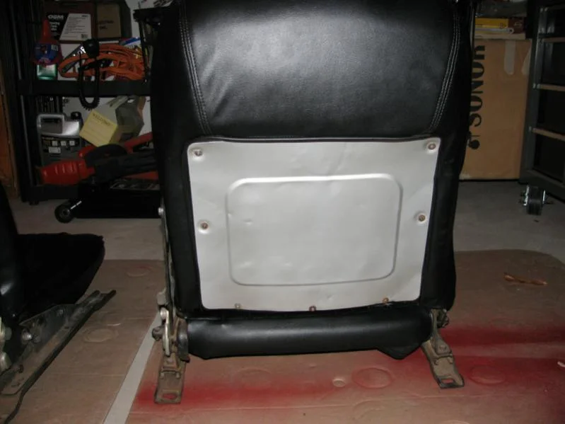

Anyone ever painted the back panels on the seats? I don't mind doing this myself, but would like to know a good color match if anyone has had good luck.
Make sure to let us know which upholstery shop you use and how they were. Do it up!

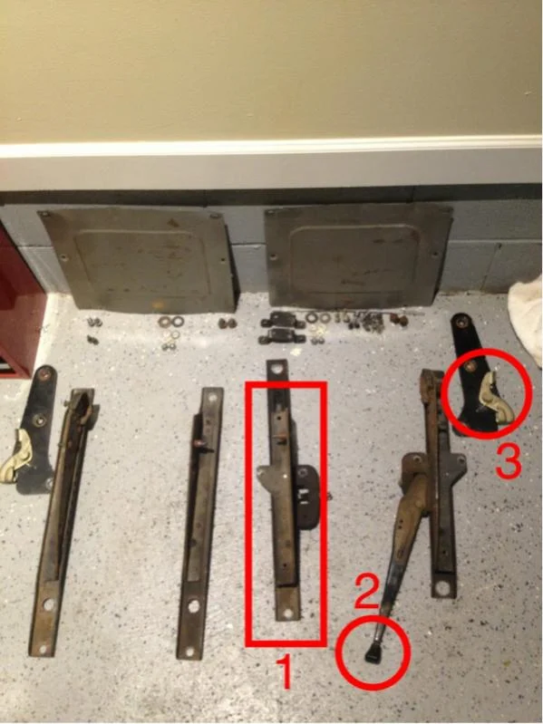

Started to tear apart the seats a bit today to prepare rails for powder coating. Ran into a few quick questions (# below correlates to picture):
1) do I need to get the DS rails separated for powder coating? Can't seem to figure out how to get completely separated other that some type of rivet since all nuts are removed. Any suggestions?
2) any concerns on leaving the plastic knob here for powder coating? How do I remove it if needed?
3) any tips on how to remove this assembly? Is this just a brute force rivet removal? Any concerns on reinstalling it? I'd like to remove if possible.

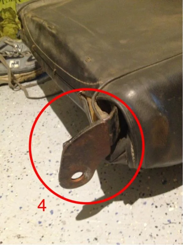

4) how do I remove this piece? Do I have to start removing the seat upholster to get to this?
Also, not numbered but wondering what thoughts are on using SS for this hardware. Is that a big no no due to softness of SS? Lots of rusty hardware in here so I usually replace with SS, but wanted some feedback.
Everything else is coming along and have the seats cushions off the rails ready for quotes or do it myself with sor or cruiser corp products.
In case #4 is hard to tell what the picture is showing , here is a picture zoomed out.

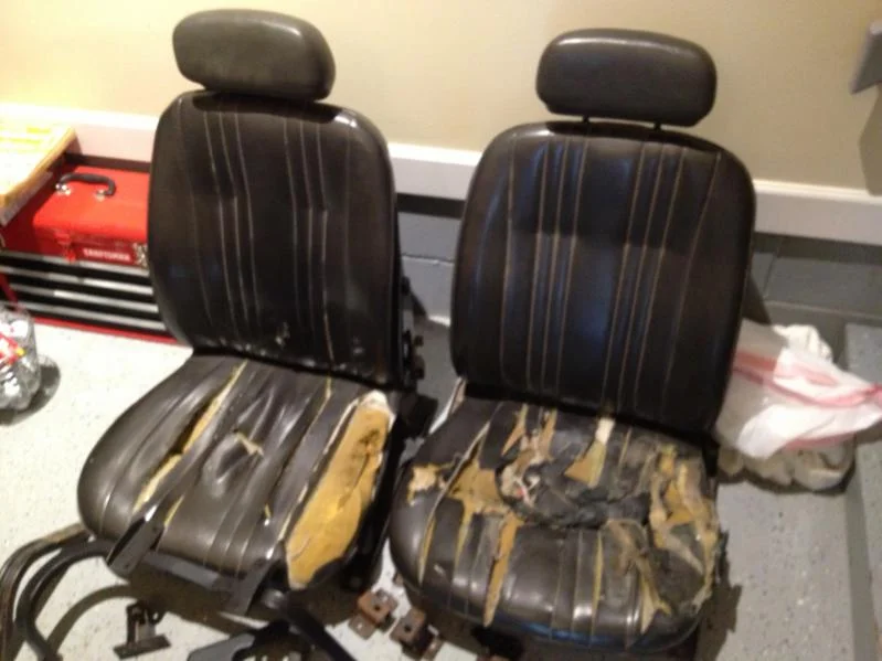

For being seats from a 78 the fabric looks pretty decent except for the front :). Looking good
Thinking the same thing on how good of shape they are in... I'm going to consider having the shop just do bottoms, but color match could be a concern.

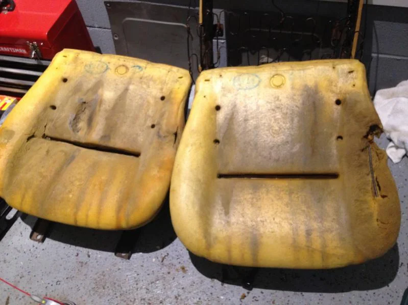

Foam bottoms aren't as bad as I thought they would be.
Doesn't man-a-free or some other company make a "patch" kit that will fill in some if these bad spots? I searched, but did not find anything.
Let me know if you know of anything.
You can always switch the DS and PS foams so the wear spots are on the other side - popular method. I've always worried about crumbly 30+yr old foam, though. The new covers might last another 30 years but I'm sure the old foam won't. I'm eagerly watching this thread. Need to refoam and recover my Spitfire seats.

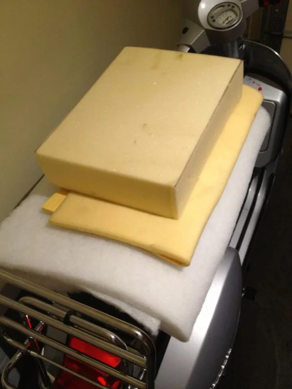

As far as the bottom cushions, I've opted to go with self repair. I spent $12 in materials and the plan is to add a layer of foam on the bottoms where the springs hit the cushions (multiple shops recommended this), cut out the bad areas and fill in and cut to shape. Then put a layer of "Dacron" sp? on the bottoms between the foam and the seat covers. Several shops said this is a good way to fill in imperfections in old seats.
