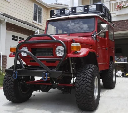

@90 Weight....thanks for the call and answering all my questions! Here's my '40 pre-restoration. Still have to tuck the exhaust up and do my suspension. I hope to have that done before the end of the month.
