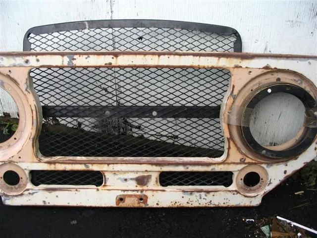

Does anyone know what the differences between these grills are? They all look the same to me...
The URL for the above list is
http://www.sor.com/sor/products2.tam?xax=7177&category.ctx=112-28&page#.ctx=112
It's easier to look at there.
Attached is a picture of the front grill from my '66.
Thanks in advance.

early to 74 I think, the emblem mounts differnt. 75-78 should be the same, they use the latter emblem. 79+ differnt yet, square bezel for one and just a different grill

Thanks for the reply.
So fair to say that E-78 the grills are all the same except for the Toyota emblem mounting?

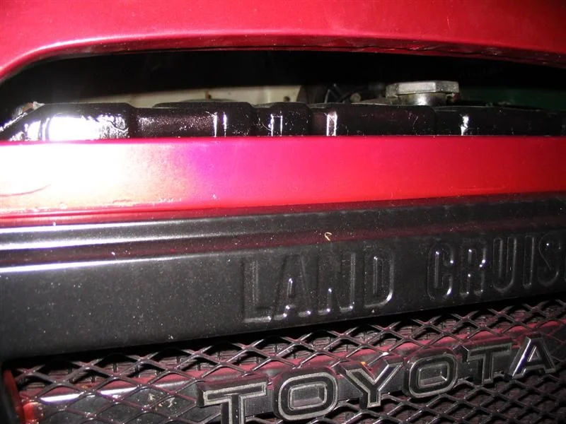

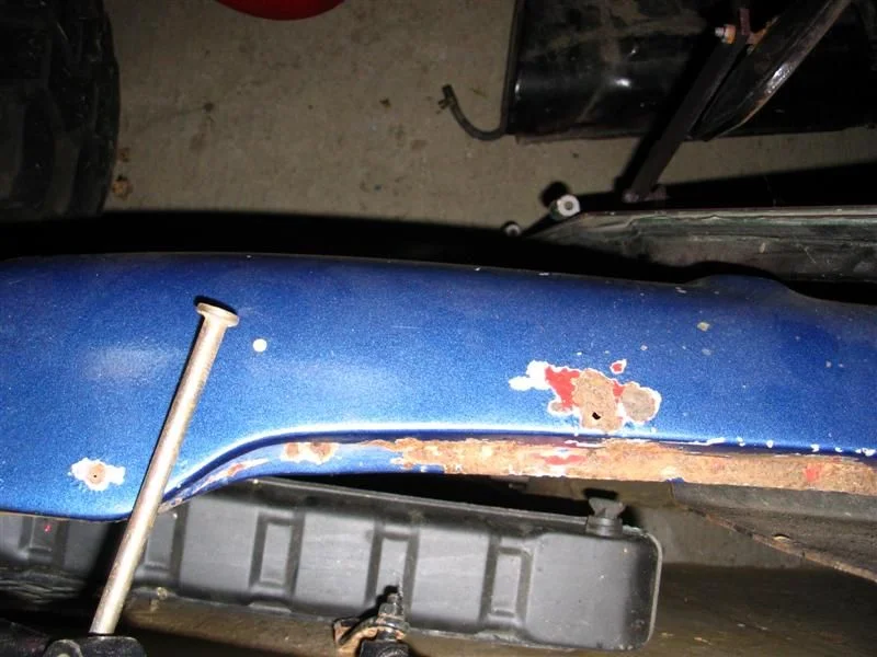

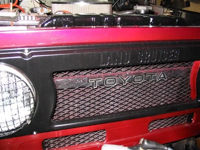

i have noticed some differences mine are canadian cruisers . anyways my 75 grill is taller to comes up into the hood area ,also my 75 hood is different no lip , my 78 grill even with top of bib , my 78 hood has a lip . never noticed if different mounting location of the emblems ,oh! maybe i had to widen the holes on the newer bib to fit an older emblem into it .the older bib emblem had a wider spread on the mounting bolts
grill picks different heights
