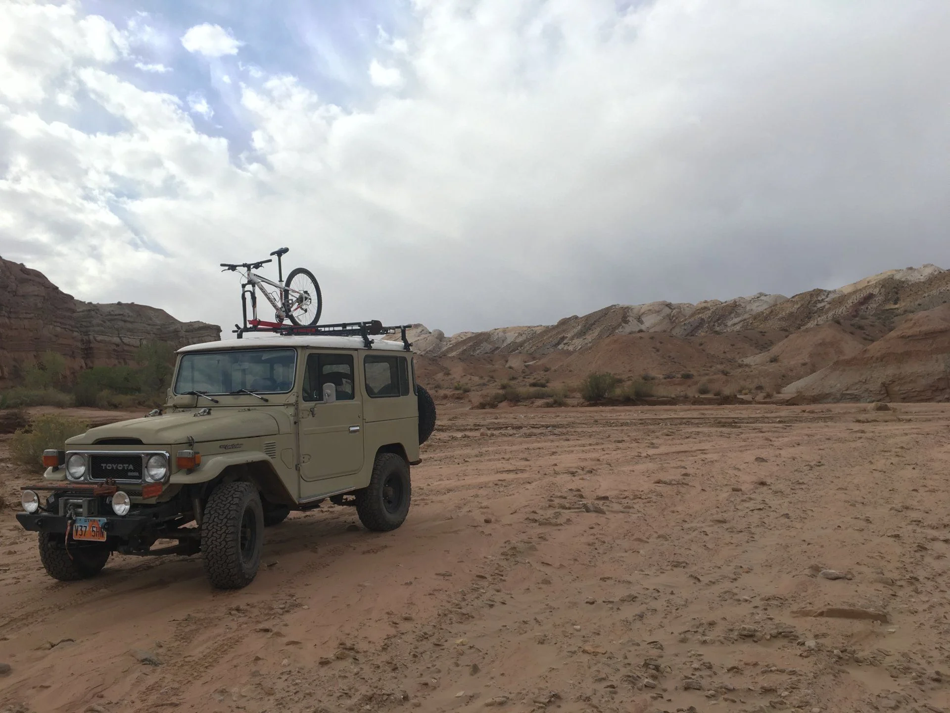

I had one on the roof for awhile but got a new roof rack and haven’t had a reason to put the bike rack on it. But I only use the bike on long trailhead shuttles in the desert, if it was an every weekend thing I’d probably get a hitch mount

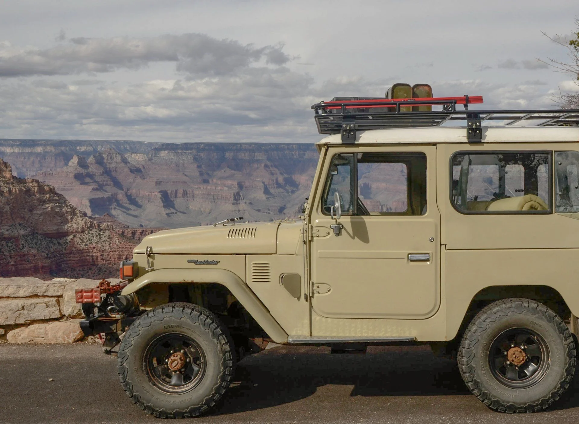

I have Thule towers and crossbars on my 40. The standard 6.5” high towers barely clear the roof where I have them mounted (4’ apart). If you have a pristine roof, I’d recommend taller mounts. Under load the crossbars touch the fibreglass roof. I like the low profile height and I’m not worried about scuffing the paint. I’ve got a custom 3” high basket I built... and in total it raises the truck height by 3” to about 6’8”.

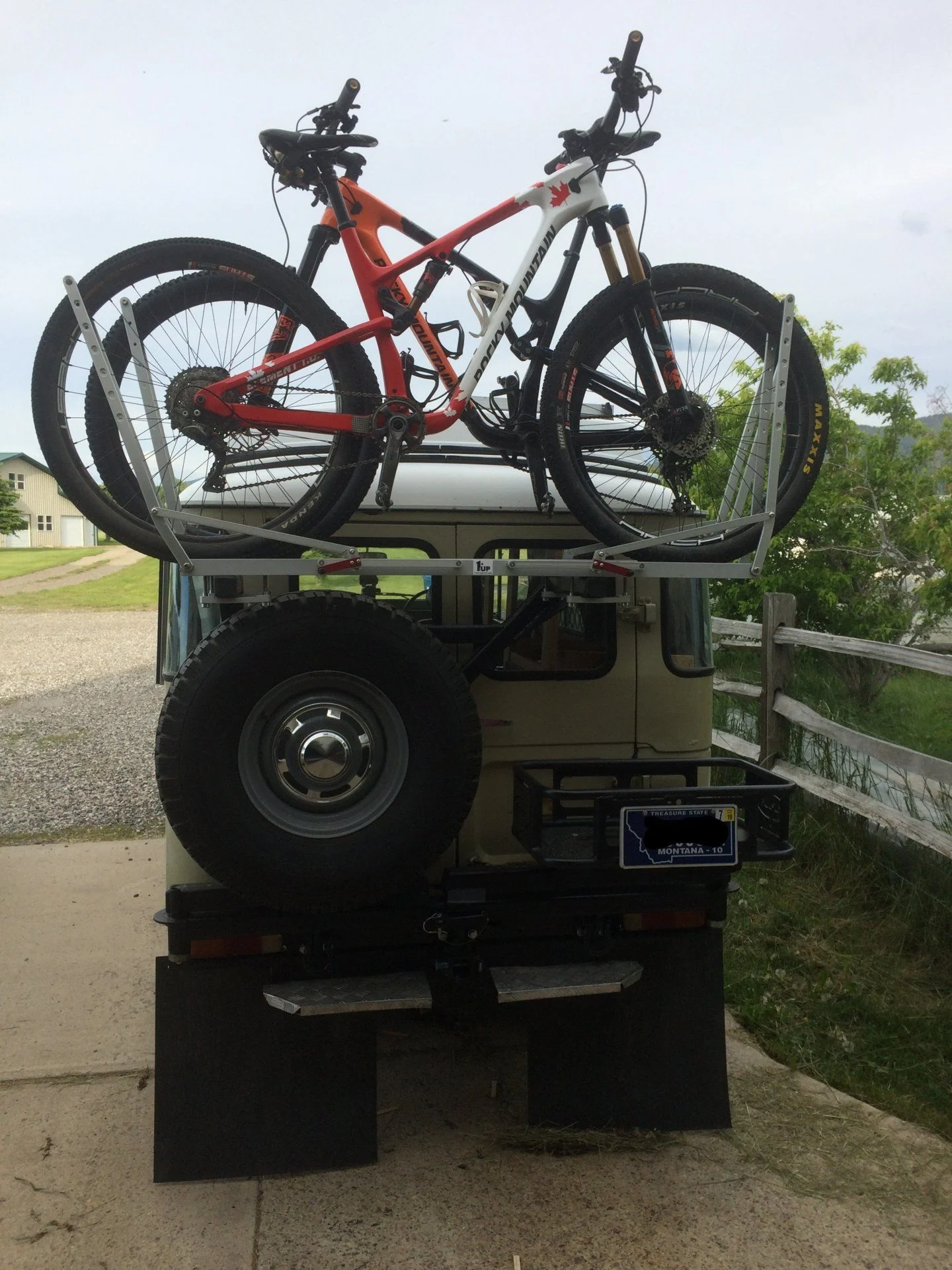

I’ve got a hitch rack I made that I use on both the 40 and the 200. It uses two Yakima bike mounts that I can take off and use on the roof of the 200 when I pull the camper also. It’s been a good setup. A good hitch rack is nice because it can be easily ported between vehicles. This rack has been on my FJ40, 2 Tacomas, a Subaru, a 100, a 200, and an Acura RDX. I only have this pic of it on the 40.

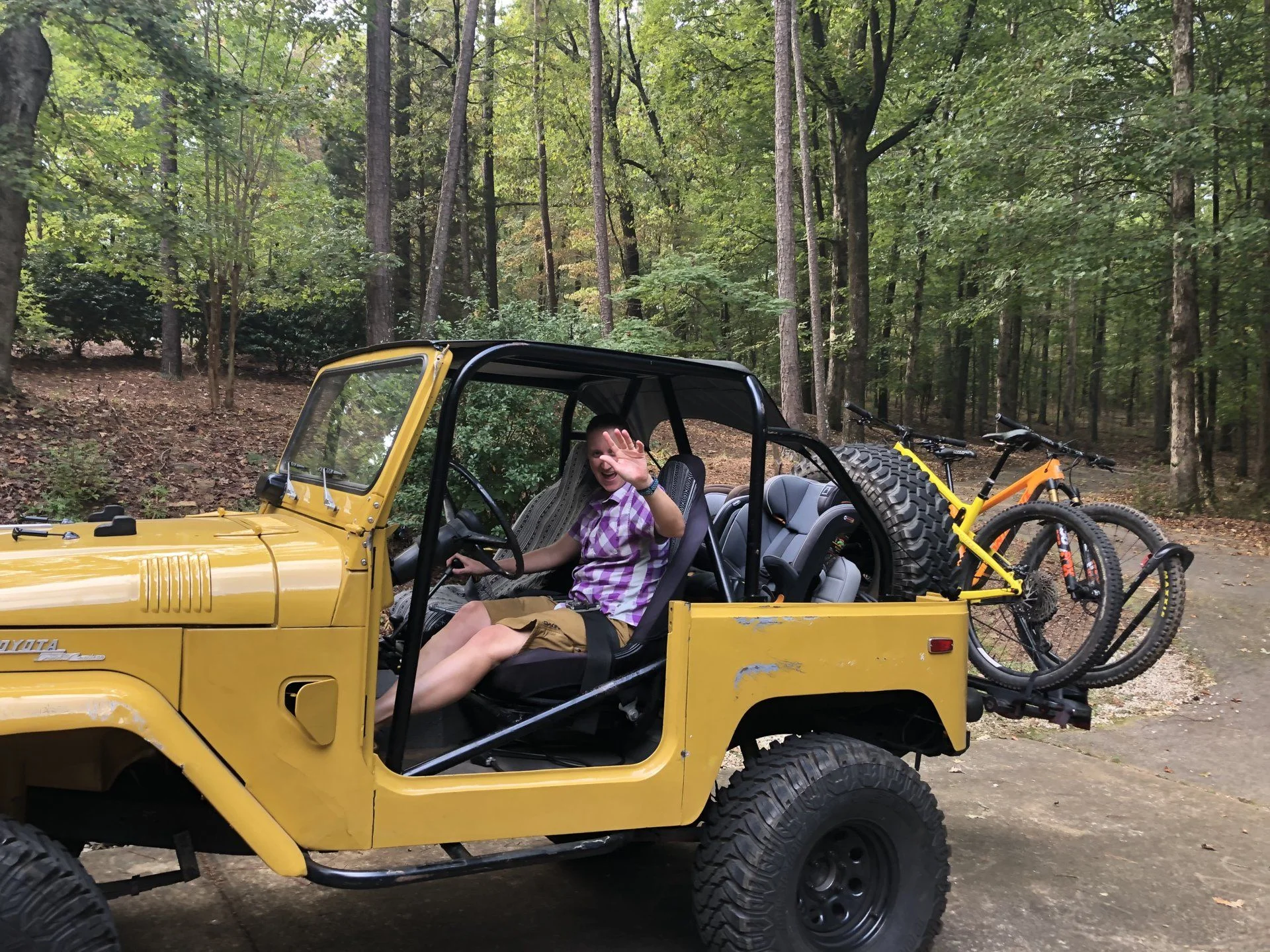

I’m still tweaking this, but it works great for a single bike. Currently set up for my son’s bike but could easily work for a adult bike.

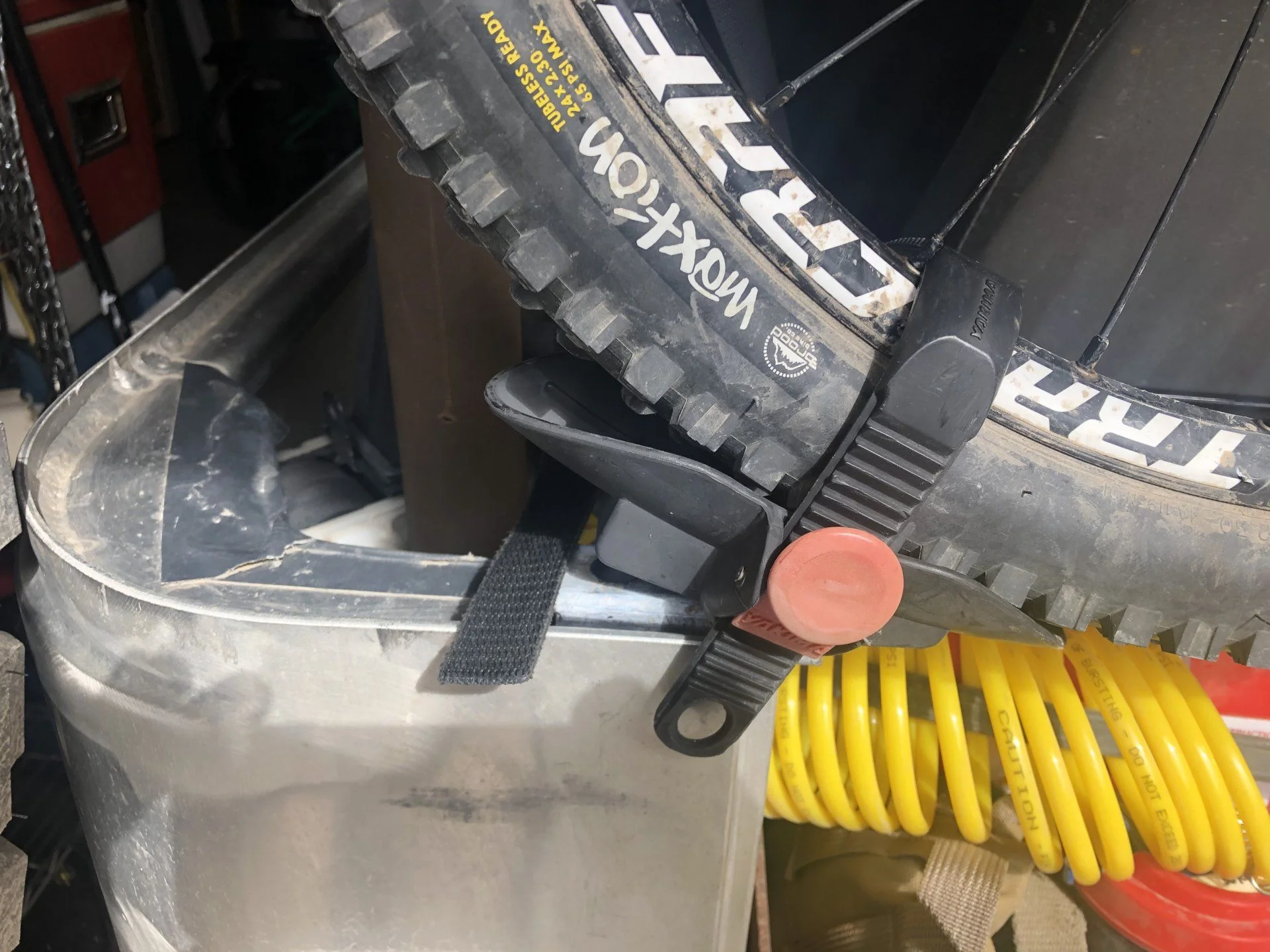

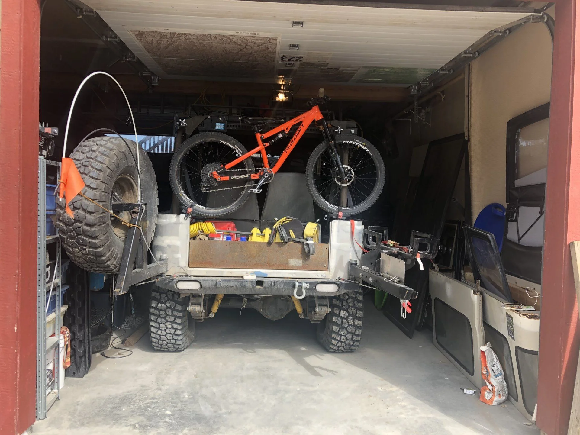

In the past I just let the wheels ride on top of the tub and used a titan strap to secure it to the roll cage/jack. I had some old Yakima wheel chucks(?), so I set those up for some more security. This set up puts two bikes on the hitch rack and a third out of the way. One word of caution- a full-size bike is likely to hit the garage.
