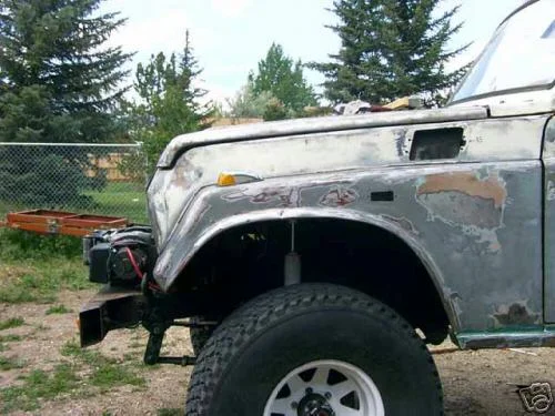

tearing down a 69, perplexed with these turn signals, I guess they are factory, but not sure. I saw a post yesterday by 3 puppies that showed a 69 with turn signals similar to a 72 I have. maybe these were put out earlier in the year?
I don't guess replacement lenses are available, these are cloudy. the fender aprons have elevated bumps where they are installed so Its not going to be real easy to use later model ones, any great ideas out there?

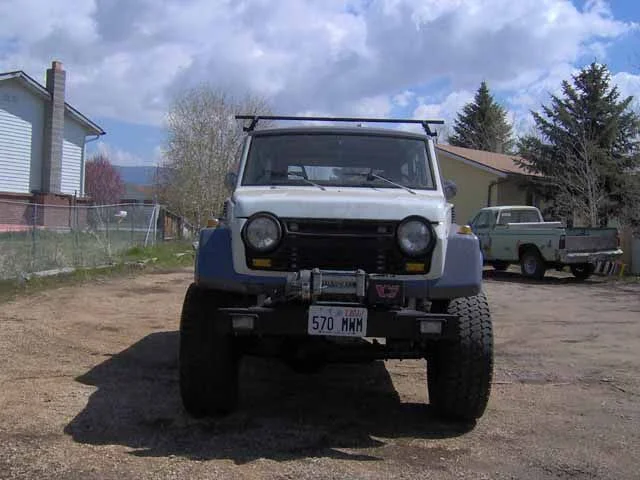

I just bought a later '69, bummer it did not come with these. Also, there is a Dodge Raider pickup from the early 80's (the small pickup) that has front side marker lights that fit perfect in the spot under the headlights, also per early FJ55. I did this on my last piggie, here is a pic. Worked great.
Also I did VW turn signals on the past pig. Some say it is sacreligious (whatever IMO) but others say it looks great and semi OEMish which I agree with, even though of course they don't look anything like OEM. Just that they "belong" there :)

Mine were cheep 70 series copys, lenses are brittle and yellowed ,. But following in the old 55 lists suggestions i took them and heated the lower inside where it contacted the fender just enough with a heat gun to make it soft and pushed it into the fender to custom form it to fit exactley the fender shape , then reinstalled the gasket and bolted them suckers on . Some pics are up on birfield .
