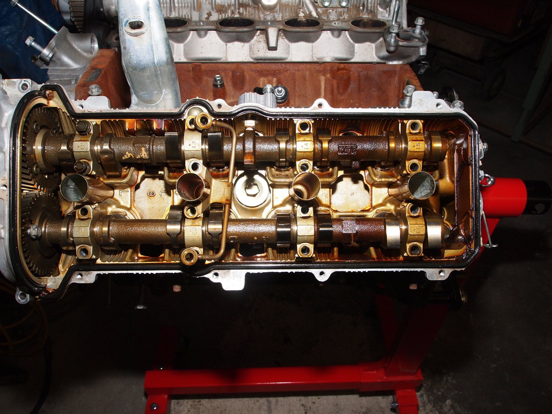

FWIW: Here's pictures of buckets sitting on valves under cam(s)
They can get loud if gap get to wide.
Shims come in different sizes to adjust gap.
