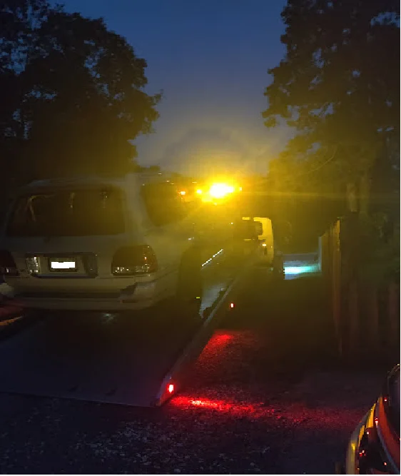

Long story short, got the infamous brake failure: ABS, Brake, VSC off, VSC trac Light on with the LOUD buzzer!
When it first came on 3 days ago in stop and go traffic it went off in less than 10 minutes, fluid levels were fine, brake pressure was good; however, come to last night... it came on and I lost 95% brake functions (thank god for the e-brake,) luckily... knowing that this could be a result I was aware and had full control to stop.
5 hours waiting for a tow truck last night and the call from the shop saying it'll be $5k to fix (replace the whole unit.) this morning....

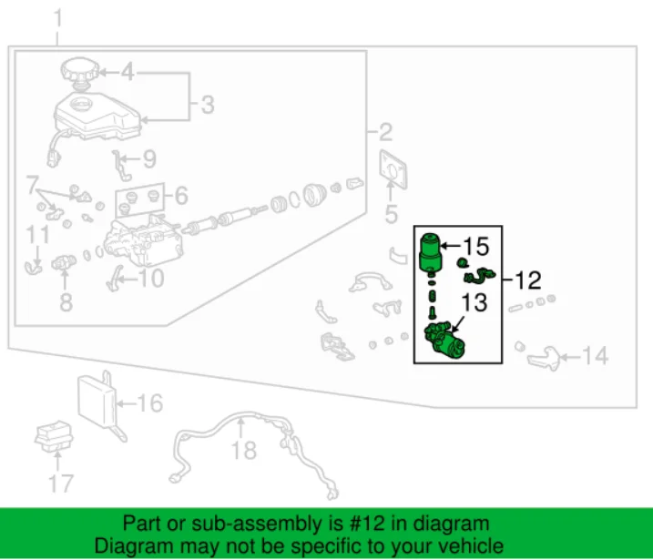

I think I want to just replace the motor on the bottom of the Master control Unit and go from there.
I can hear the relay kicking (or trying to) on but nothing from the pump. My guess, the motor has failed...

So are the Toyota or Lexus variants interchangeable?
Parts: PUMP ASSEMBLY, BRAKE BOOSTER WITH ACCUMULATOR
TOYOTA 47070-60010
Lexus 47070-60010
Thanks,
Trae
Yes, it's all the same between Toyota and Lexus. It's shocking sometimes thought when you see the difference in prices at some dealerships and retailers.

CAN CONFIRM: Toyota Part # 47070-60010 Is the correct part, even for Lexus.
You could get the cheaper one with just the motor; however, I read where a user did that and had an issue with the accumulator. So, just get the one I got, so you don't have to do the job twice like him!
