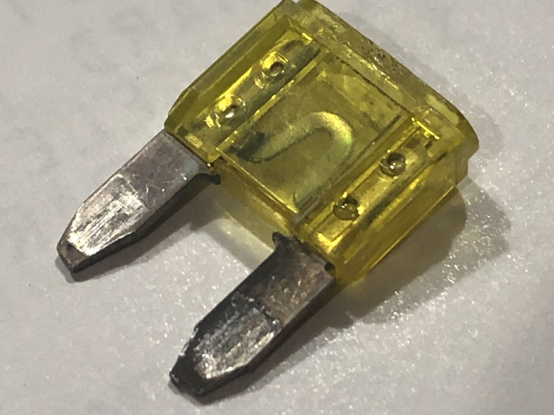

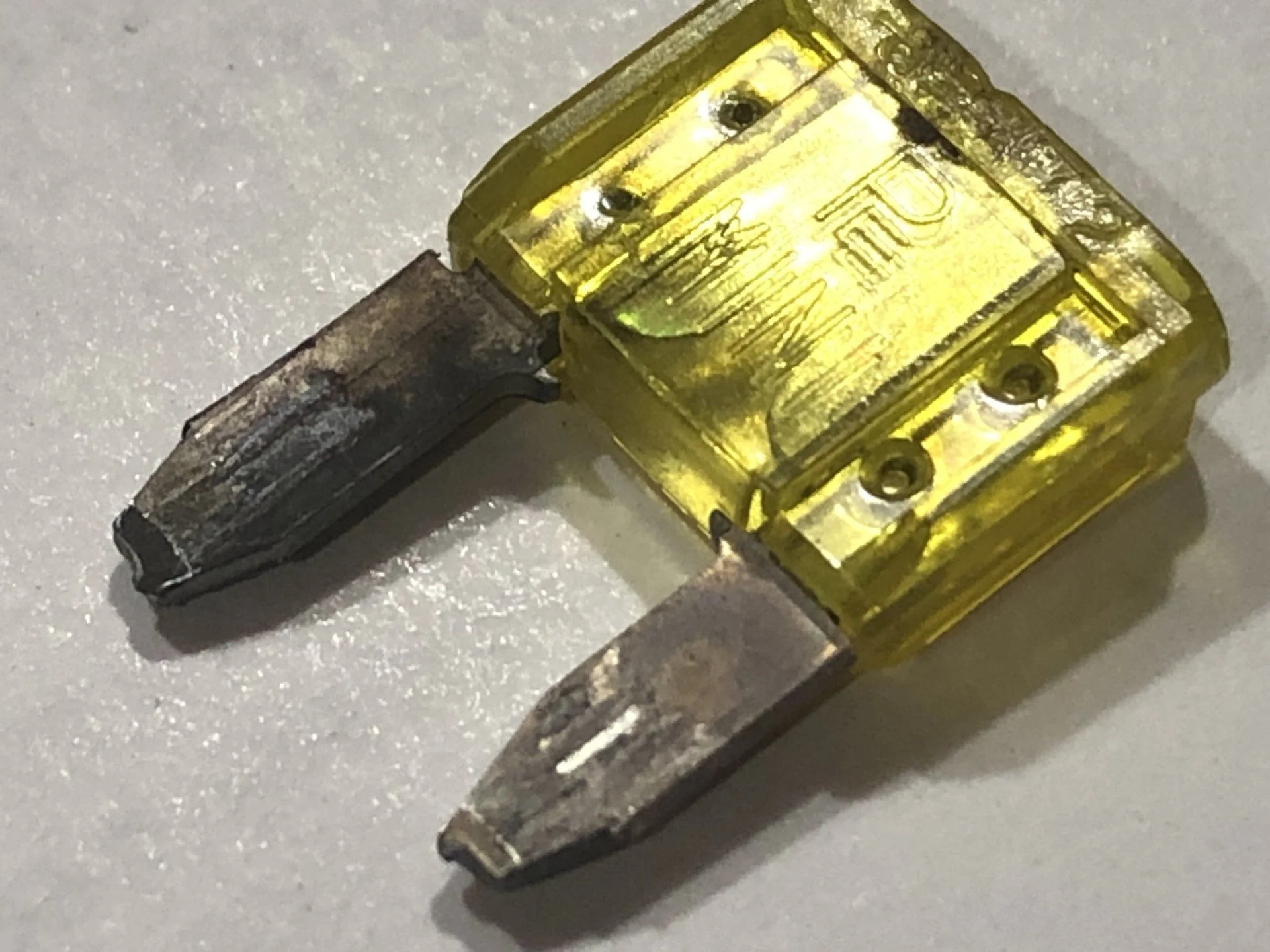

I wanted to add that my ‘98 started this intermittent starting issue quickly escalating to leaving me stranded at work. I pulled the fuse it looked a little dirty and figured reseating it would make it fire..... wrong. But it fooled me as the relay was working - they must be on a different circuit? Anyway I used spray electrical contact cleaner and a new 20a fuse and it seems to have fixed my issue.
Picture of the original fuse, showing how oxidized it was- definitely looks worse with 5x magnification!
Cheers.
