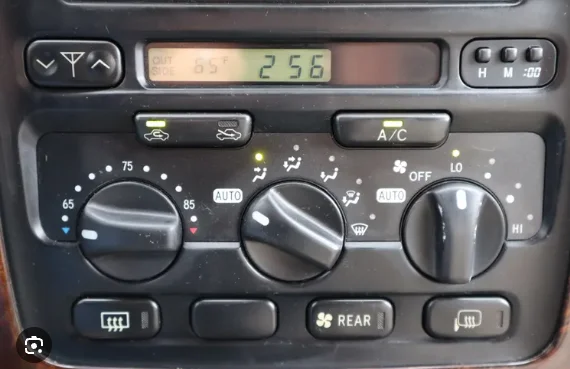

Does your immobilizer light come on? It's the red light that looks like a car with a key inside the car outline. Its beside the clock in this picture. If that is on, your car will not start.
