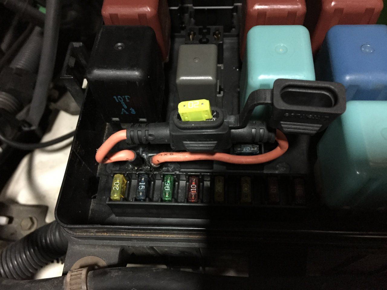

6. Applied a couple pieces of marine grade heat shrink to the fuse holder leads.
7. Soldered the new fuse holder to the tinned tabs, this took some heat...
8. Heat up heat shrink.
9. Job done, car fired right up!
Total time 1 hour, cost, $4.95.
Excellent work. I have the same recurring immobilizer/charred fuse issue as others, so I will be doing this within the week, as opposed to $400+ for a possibly discontinued fuse box that has an inevitable fatal flaw built in. Toyota should supply an upgrade for free as most 100s are hitting this fatal flaw prior to 300k miles, which is when LC’s are supposed to just be hitting puberty. Thanks for the pics too.

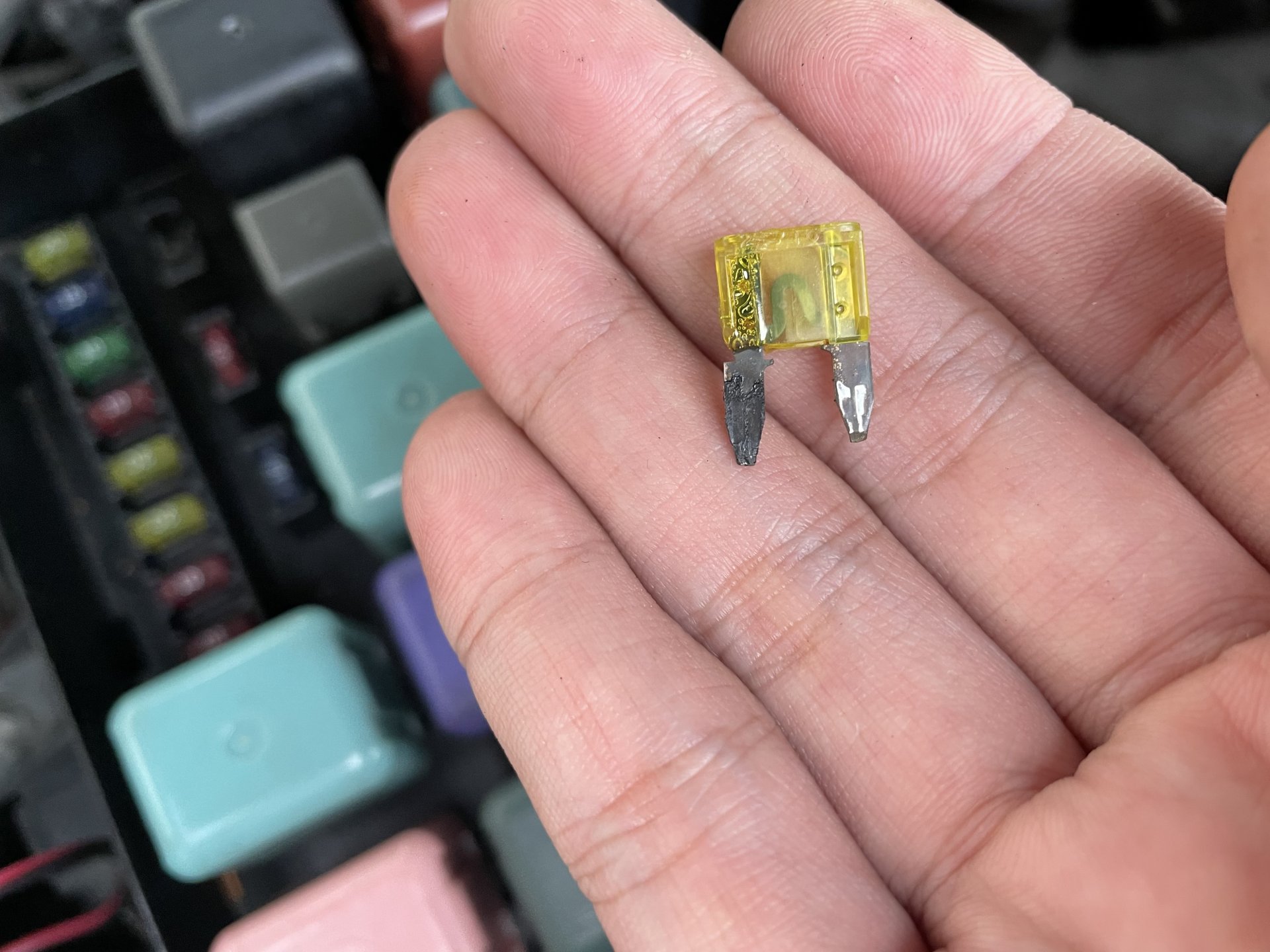

I guess I'm the only one that didn't have to replace the fuse box for this issue. Odd that I'm the only one that had the signal amplifier go out on the jgnition assembly. $120 fix. Sure glad I didn;t replace the fuse box first.
Update: I'm the original poster here, and I've had my 2001 LC jumpered with a spade connector since 2013. It hasn't given me any further issues. It currently has 225,000 miles.

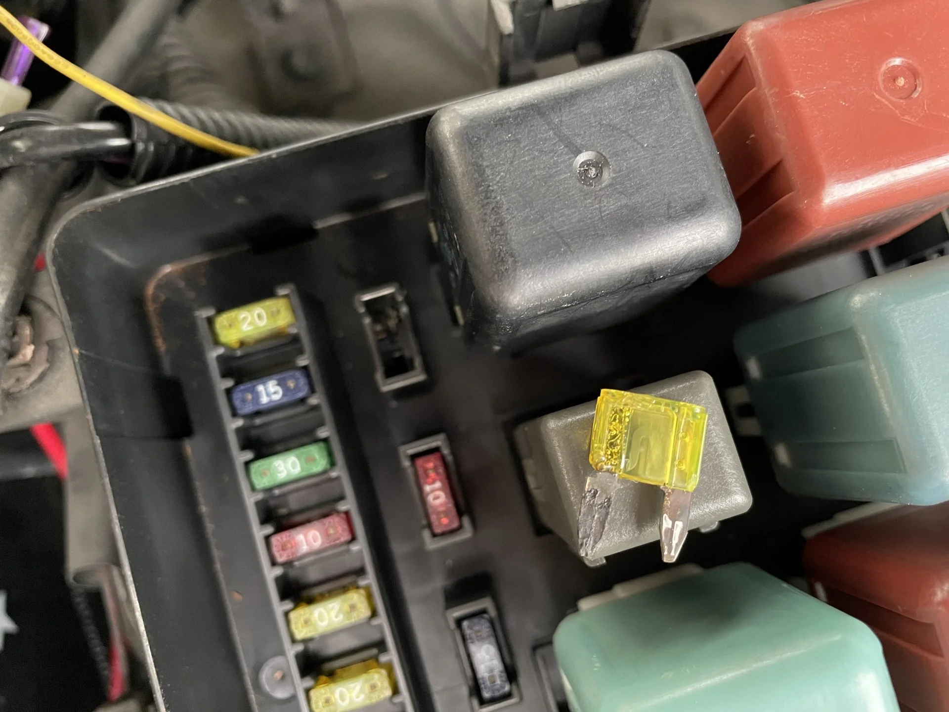

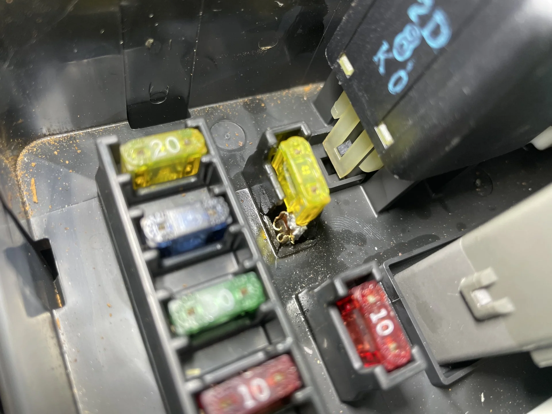

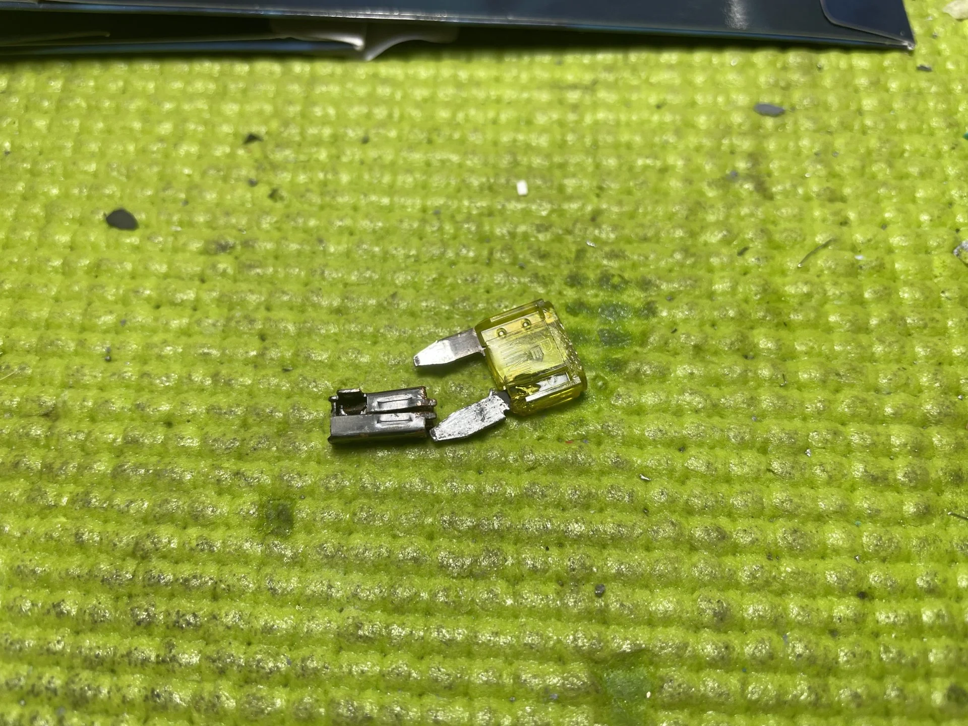

I just experienced this problem on my '02 LX. First symptom was the engine died while I was backing out of the driveway while shifting the transmission from R to D. It started then died again. After the second re-start it ran fine. I have an old battery in there and thought the voltage drop might have caused the engine to stall so I charged it and it ran fine for a couple of days. Then today it wouldn't start, it cranks forever but wouldn't turn over. A quick search here on Mud pointed me to the EFI fuse. The immoblizer light was blinking so I knew it was either the key or the fuse. When I pulled the fuse off, one leg was black and the plastic was slightly melted. The female side where this blacked fuse leg goes to (the side closest to the fender) looked oxidized as well, while the other side (closest to the engine) looked pristine. I tried to add tension to the contacts using a small flat blade screwdriver, but the plastic "neck" or tower that surrounds the fuse slot snapped around the area near the fender side slot, indicating that the plastic might have gotten brittle due to the heat on that side of the fuse.
Anyway I went ahead and put in a fresh 20A fuse and it started right up. But as soon as I wiggled the fuse, the engine died. Right now I added some more tension on the contacts and the engine no longer dies when wiggling the fuse. I'll have to do a more permanent fix though because this problem is a huge safety issue and I'm very lucky the engine didn't die yesterday while I was driving on the highway. The bypass method with a new relay and fuseholder won't work for me since the side that the kit plugs into is the problematic side on mine. I'm thinking of removing the neck and tabs completely to expose the metal prongs, then instead of soldering a fuse holder onto those prongs, I'd solder the fuse holder leads to two spade connectors that will insert into the metal prongs in the fuse box. Do you guys think this is a good idea or should I just solder directly to the prongs?
Okay so I managed to pull out the bad fuse contact from the fuse terminal. I believe this is the constant +12V side. As mentioned in my previous post, the contact on the other side looked pristine so I left it alone. I cleaned the bad contact as best I could including the prong on the fuse box itself and went for a test drive. The engine doesn’t stall when wiggling the fuse, but after a 10 minute drive the fuse contact was very hot, indicating high resistance. I ended up soldering together two fuse holder contacts that I ripped apart from a universal mini fuse holder. One side to grab onto the prong on the fuse box, and the other for the fuse. It worked, that side of the fuse no longer gets hot at all even after a 20 minute drive.
Fuse contact removed from fuse box.
New contact installed. Made up of two female fuse holder contacts soldered together. It no longer gets hot when car is running.

Knocking on wood as I mention this, but I haven't had this issue come up on our Cruiser since 2016. The last time it happened, all I did was take pliers and bend the 20A fuse prongs just a tiny bit, so they had more tension for better contact. Hopefully something simple like that can get others going again when this happens. Good luck everyone.

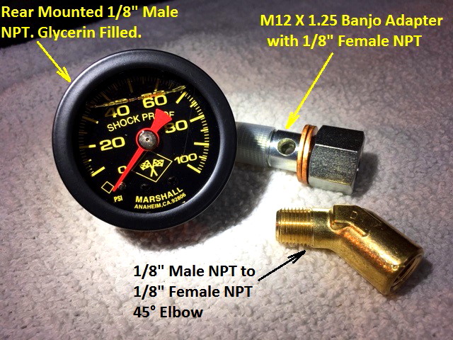

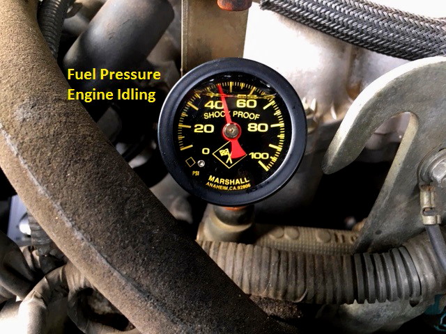

My inclination would then be to check fuel pressure. The fuel pump does NOT run on these vehicles until the engine is cranking, so by installing a banjo bolt adapter you could then use a fuel pressure gauge to check and see what (if any) pressure you have. You need a minimum of about 45 psi.
Instead of fitting an adapter...I opted to just install a good quality mechanical pressure gauge and leave it in place.
