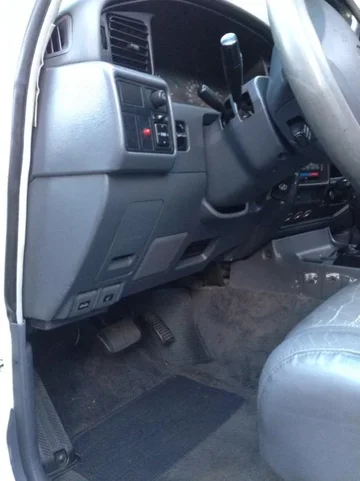

LH kick panel, upper right hand corner of the relay block you will find behind it, iirc.
I am guessing that you don't hear it click?
It looks like a proprietary relay, but it's a fairly standard type clipped into an adapter that moves the center tab to the other side.
I forget the identification. You can remove the Denso relay from the adapter and use Bosch, generics, etc.
Green wire is typically the "TAIL" fuse circuit and not related to the turn signals.
Did you remember to plug the HAZARD switch back in before you buttoned up?
First things first: You need to have power at the Hazard switch.

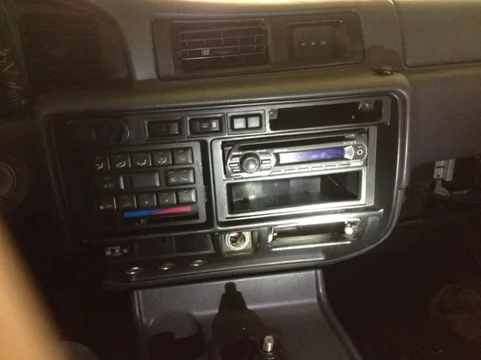

Ok fellas. Here's the latest. Put everything back on the dash. Connected stereo.
Previously, when the stereo was installed and the rear DS door would open, then the stereo would fail. Turned on truck. Turned on stereo. Opened DS rear door.
Stereo didn't fail!!!!! Awesome.
Connected everything back. Dang. It's so simple back there. Just plug and you're back in action.
Not sure what this connection goes to. I didn't see a connection for it back there. Hhhhmmmmm???????? Maybe nothing.
All good for now.

Ok fellas. Here's the latest. The stereo is not working properly. I can tell that the buttons on the stereo are not doing what they should. Like I turn up the volume and it decides to seek forward for a radio station. Or I press the seek - minus button and it it changes the mode as in AM 1 FM 1 FM 2 and such. I will try resetting if possible and see what happens.
Any chance the stereo has been wired incorrectly???
Is it possible that my previous electrical issue has somehow fried the harness and messing with my stereo????
Thoughts????? It's easy to get back there. Don't mind pulling it apart if you guys have some suggestions.
Thanks fellas.
Stay tuned.
That sounds like a stereo issue, nothing to do with the wiring.
Looks like it has a removeable face, maybe it got sat on at one time.
You can always disassemble it and look for a cracked circuit board.

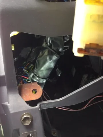

Hhhhmmmm. This has me thinking. Should there be a wire connected to the radio and grounded somewhere behind the dash???? I saw a ground connection back there. The wire was just cut. Didn't think much about it.
Or is the ground part of the harness connection???
Yes, head unit should be grounded. I did my install a few weeks back. Old unit was grounded separately from the stock wiring harness. So I don't know if there is a ground right there in the stock harness without checking the FSM.

Should there be a specific location on the HU where the ground is connected to?
usually the chassis of the radio will be grounded to the vehicle via the installation brackets.
There's 3 wires on most radios.
yellow = constant +12v (memory) power
red = ignition controlled +12v power
black = ground

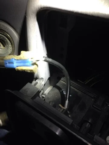

I'll ask again. What's this connection to?? Alarm??? I don't recall it being connected when I opened up behind the dash.
Also. The lights are out on my hazard, defrost, and antenna up/down switches. I don't recall them being on before I tackled the electrical issues. Bulbs out on all three switches???? Seems funky.
Ya. The foam wrapping is def factory. I was also thinking it was the connection for the lighting of those switches. I def missed that connection when putting things back. The front is covered due to PO putting some kind of cell phone/iPod holder of sorts. I recall seeing pics on other threads with some sort of factory alarm indicator in that location.
