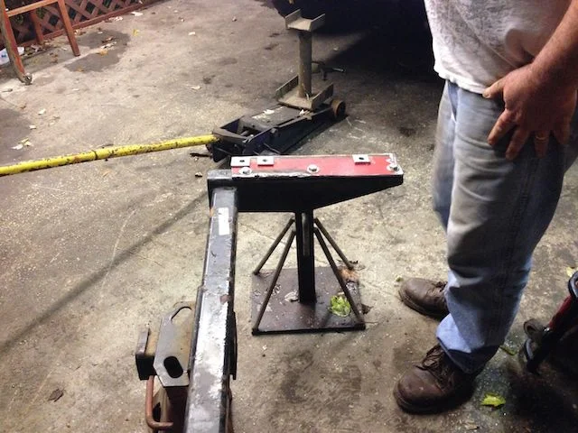

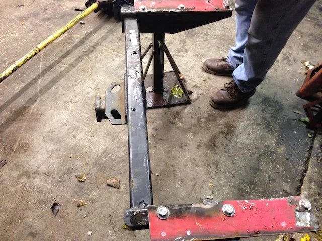

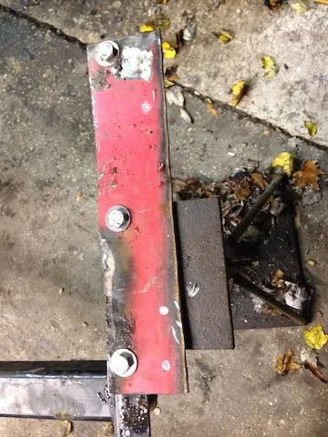

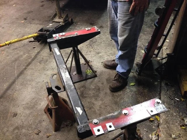

3. I was able to take a trailer hitch for a 80s Dodge Ram Charger, made some 1/4 steel plates which allowed the trailer hitch to adapt and bolt right up. I then installed the trailer light adapter for the lights since the FJ60 has separate stop and turn signal lights. The only issue I am having, which I have read that others have had the same issue also is, it seems that there is not enough power for the lights to work properly.

Here are some picks of the plates I made for the trailer hitch.
