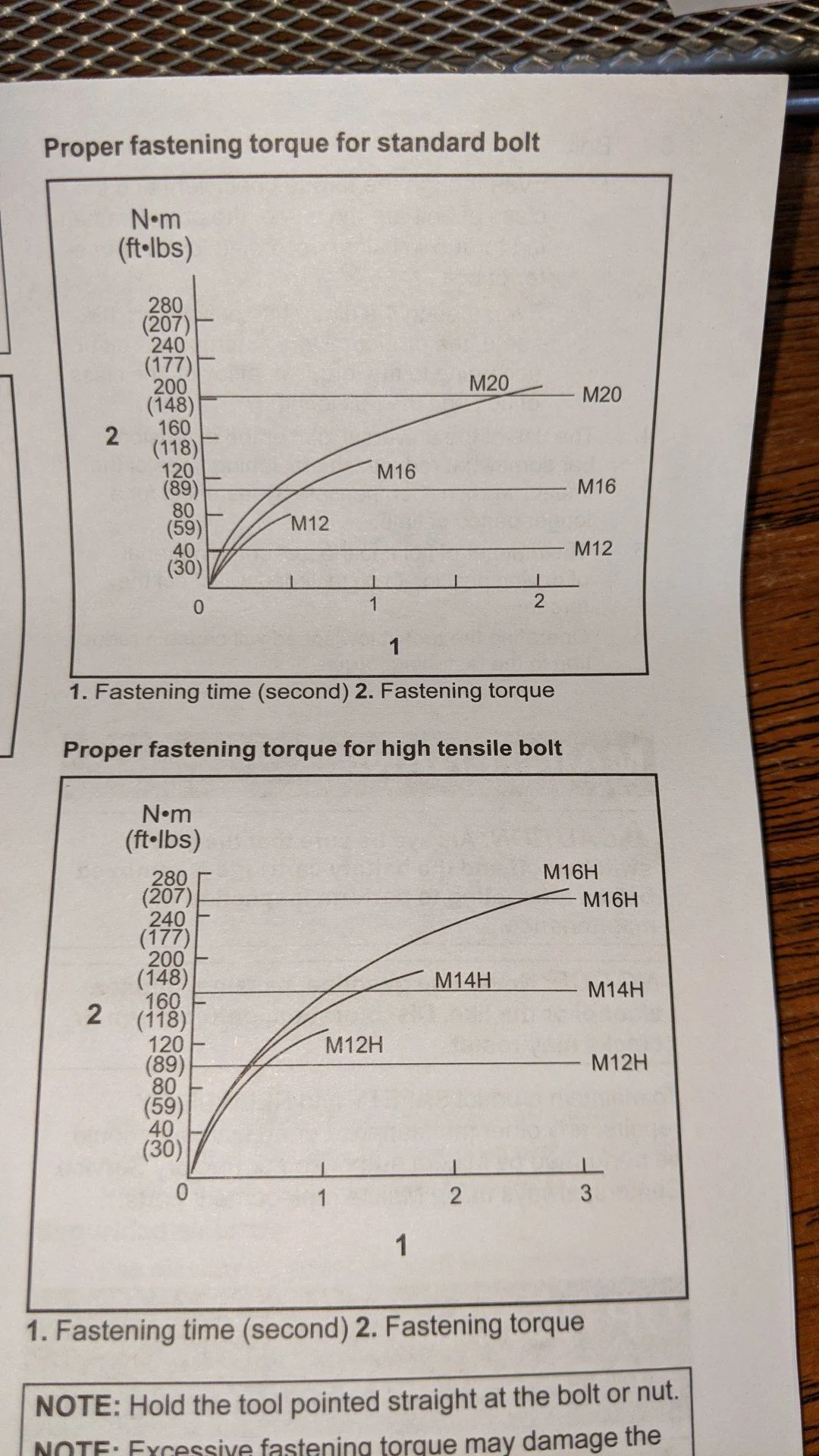

This graph should tell me something, but I'm not sure how the torque translates to most bolts on our trucks. I believe this is at high speed.
