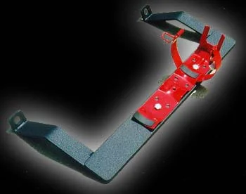

The mount is from DaliRacing and it was designed for the Acura NSX. But it is a pretty simple mount that just bolts down using the front seat bolts. Looks easy to fab up. The extinguisher bracket is the one specific to the extinguisher so the mount can accommodate any extinguisher that will fit in the space.
The halon extinguisher is sold by H3R and can still be purchased though they are not cheap. It is legal for sale because it is recycled Halon. Once discharged, the extinguisher can again be refilled with recycled halon. I chose Halon over dry chemical because my NSX is mostly made of aluminum and the agent in a dry chem extinguisher is highly corrosive to aluminum and electrical connectors. The size is smaller than I'd like but there's not a lot of room to store a larger extinguisher in that car.
