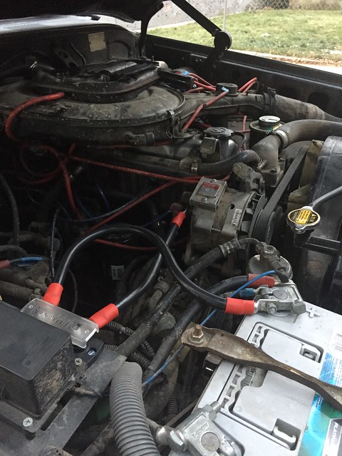

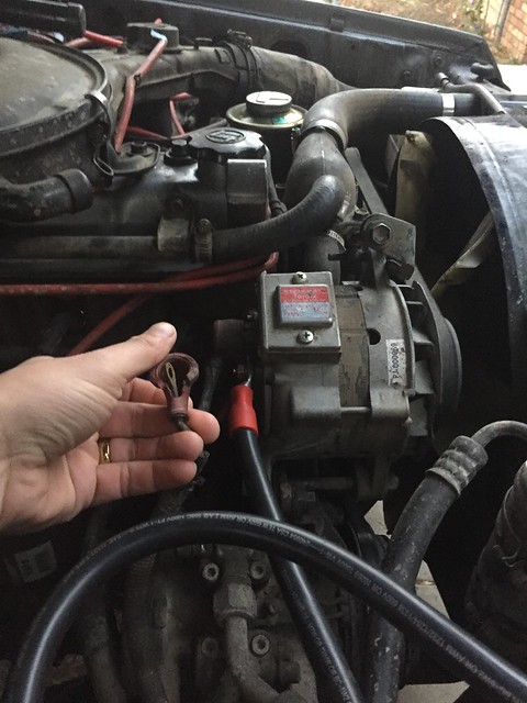

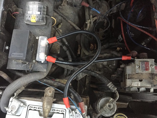

Pics of the installed direct line for the alternator with installed 150a fuse.. I went ahead and reconnected the stock line along with the new for charging the batt from the alt. That is unless someone can tell me why I shouldn't (like will it overvolt the battery?)

When I do the big three I leave all the factory wires hooked up and just add in the 1/0 from the alternator,chassis ground and body ground. It won't hurt anyting to leave them hooked up.
Thanks @tmxmotorsports I appreciate it.. My main concern is that when I have EVERYTHING running and am sitting at a stop light my volt meter drops to 12v. Now I know that the stock gauge is not very accurate but I hate seeing that so that is why I wanted to be sure that it would not be an issue.
What I am glad about seeing is the fact that I went from having 12.57v at idle with JUST the stock charging wire to close to 14v at idle with the upgraded. I have never had any issues with the truck not wanting to start or the battery giving me issues so hopefully this will just help increase the life of the battery. Especially since Sears no longer sells the DieHard Platinum anymore.
Damn that's a big wire. Outta do the job. I guess if you're getting a reading at the meter w/o the stock wire, there goes my theory.:flush: I just put in a new alt, toyota reman regulator, battery, terminals and redid that charge wiring, and I'm still seeing the same drop at idle that you are. But it doesn't take much more rpm to bring it up so I upped my idle just a wee bit, and that helped. I also went LED for the running lights to take some load off, and that helped also. Now I only get a drop with the headlights + heater + wipers. Sounds like this is about as good as we can expect with the 55A alt.

There is a section in the fsm that shows how to test and repair the rear defrost strips. Doing the big three will improve the voltage but it will not change that the alternators in our trucks just don't have enough ass.
Yeah the tapered hardware was the same for the ProComp, tapered section didnt go anywhere and the threads were too short to even stick out enough to thread anything on. So far the last couple days it has seemed fine with the Grade 8 bolt and hardware. I am keeping an eye on it to ensure it doesnt crack anything on the TRE.
And I think you are right @CuCruiser and @tmxmotorsports, the little old 55a Toyota alt just doesn't have quite enough oomph to push things, ESPECIALLY after 30yrs of corrosion and cut/spliced wires, etc. I thought for some reason there was a 65a one but I could be wrong. One day I may see if I can find an old school rod shop that will rewind the alternator for higher output, don't want to go with the GM single wire as I have read too many guys having issues.
