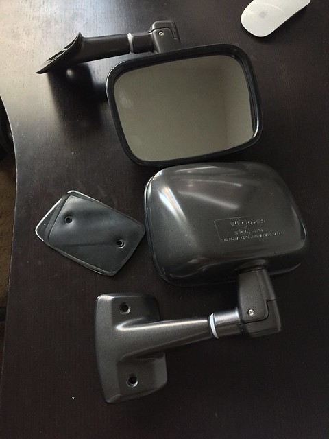

Well thanks to my constant viewing of all things MUD I was able to come across a steal of a deal on some almost brand new EURO Mirrors.
So quick message to @Grumpyhead12, quick exchange of money and I received the aforementioned mirrors today!!!
So stoked to have these as this is one of the first and most wanted upgrades I have been after. Had a nice pair of 62 electric mirrors that I grabbed a while back on here that were fading and peeling and they have served me well but the EUROs have always been on my list, just out of my immediate price range.

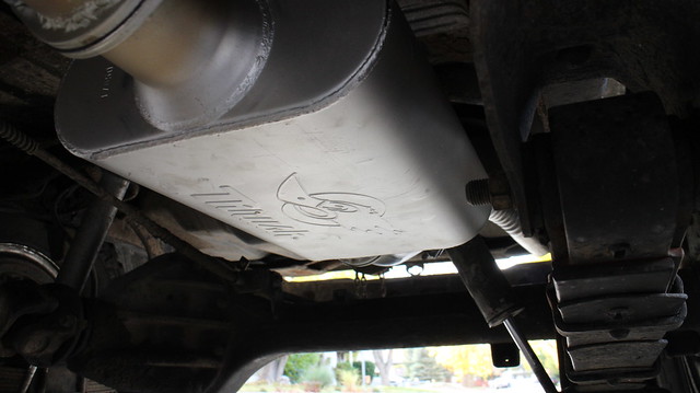

Hoping to get some time with a welder this weekend to get things started on the new exhaust too. Always and interesting morning when I start her up and she is pretty quiet and then after the muffler has warmed up and things move, I can hear her inside my house!!!

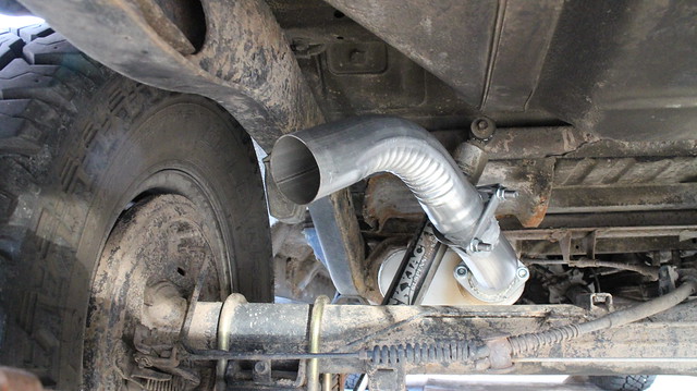

So since I had yesterday off I spent the afternoon with my BIL at his place using the welder. We had lots and lots of fun figuring out hose things were going to line up, coming up with angles and what not. Had some fun welding up the flanges on the muffler and connection pipes, hit a few snags but were able to work through it. Unfortunately, he has two little ones the oldest will be 2yrs old on the 15th of November and the little one is 6 months old, we had to cut thing short at about 7:30pm last night. I got the main pieces I wanted welded together and then got to futz with angles and pipe and what not today for a good portion of the day.
It is still not done, eventually will terminate just behind the rear wheel coming between the spring and frame like stock. But for now she is functional and sounds good to me. Definitely deeper than I thought but manageable. For those that are trying to decide between a baffled muffler (ala Flowmaster 50series type sound) and a turbo style, I would probably err on the side of the turbo until you hear the baffled first hand. I like it, and know that once it is terminated properly it will tune down some but she is definitely "throaty".... LOL
