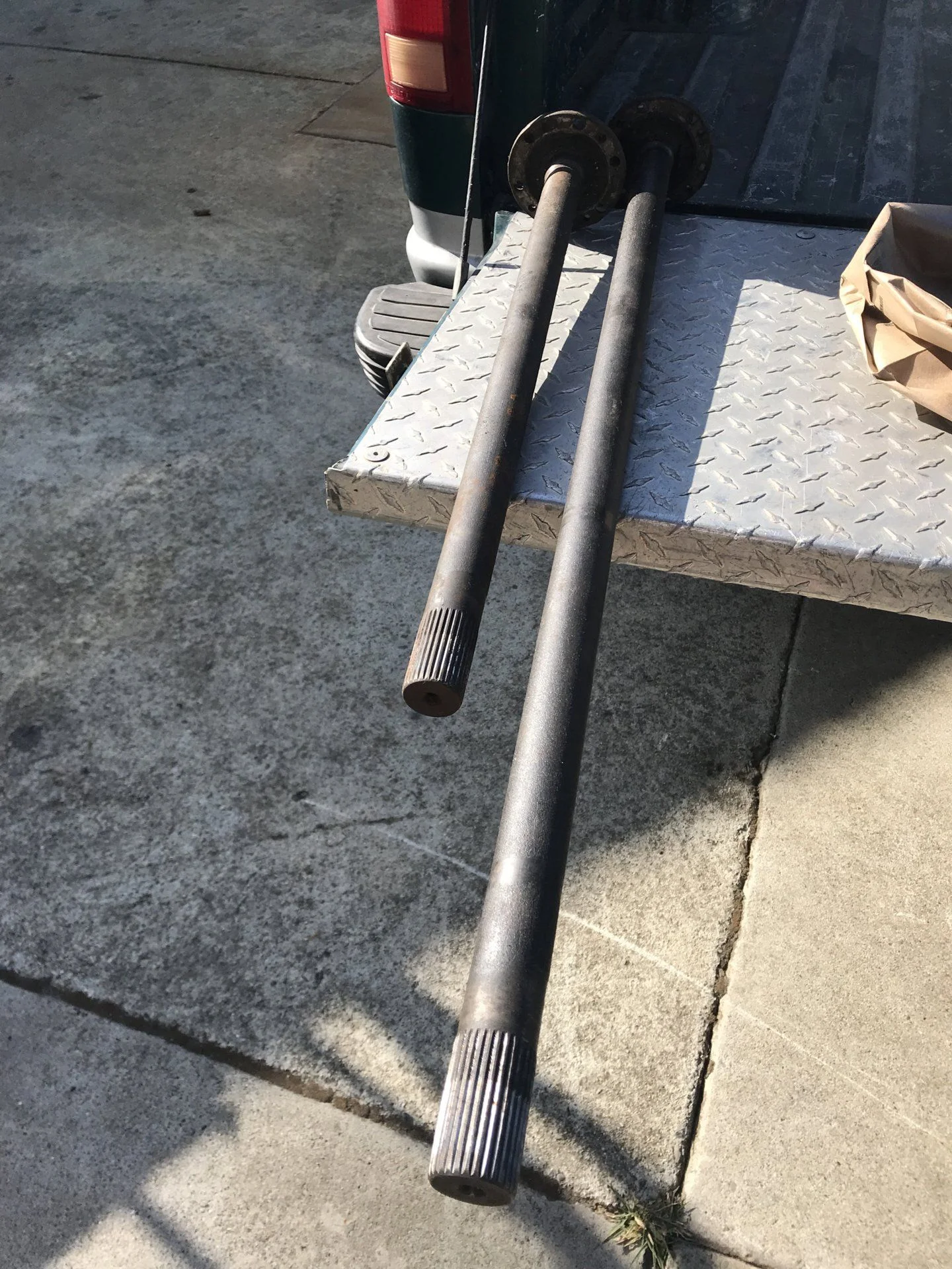

Here are some measurements, they were spares that came with an Aussie hjz75 I imported a few years ago. So I believe they are 70 series, but not sure.
If they fit my axle let's start a convo re. purchasing.... I can pill my shafts to measure - tomorrow.

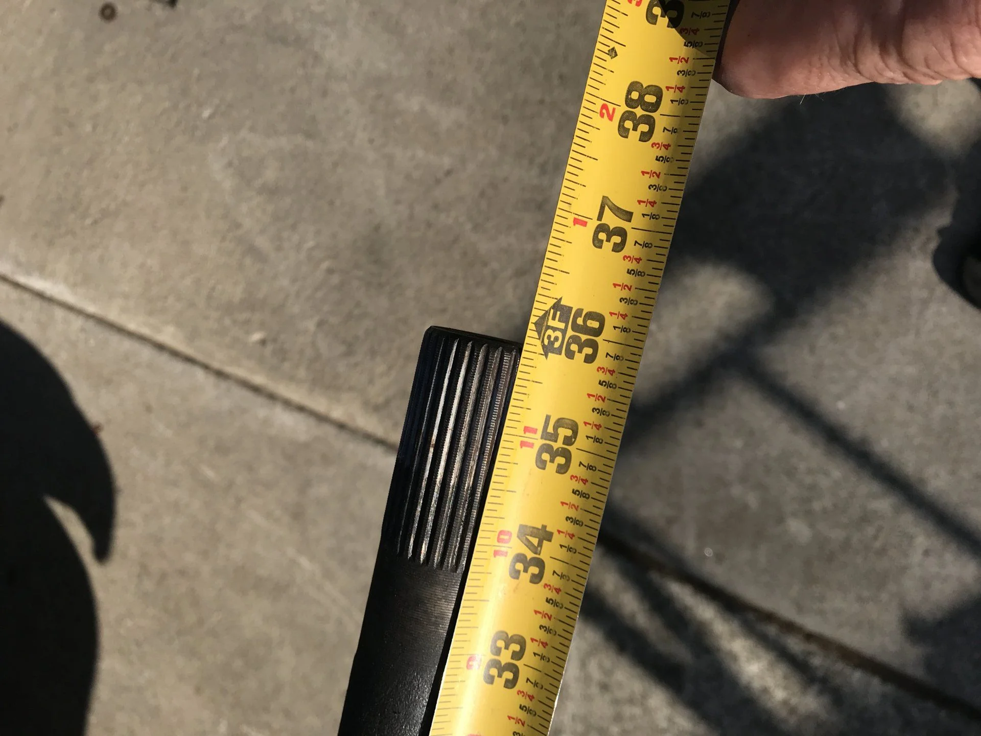

I measured my 70 series long side shaft today....
Running the tape measure from the OUTER face of the flange to the end of the splines I get 36 1/4"
From the INNER side of the flange (flat part) to the end of the splines I get 35 3/4"
Thoughts?
FYI My axle has factory disk brakes.... does that matter?
I didn't measure the short side but I will on this 70 series axle as well as the 60 series I have. Probably not till tomorrow.

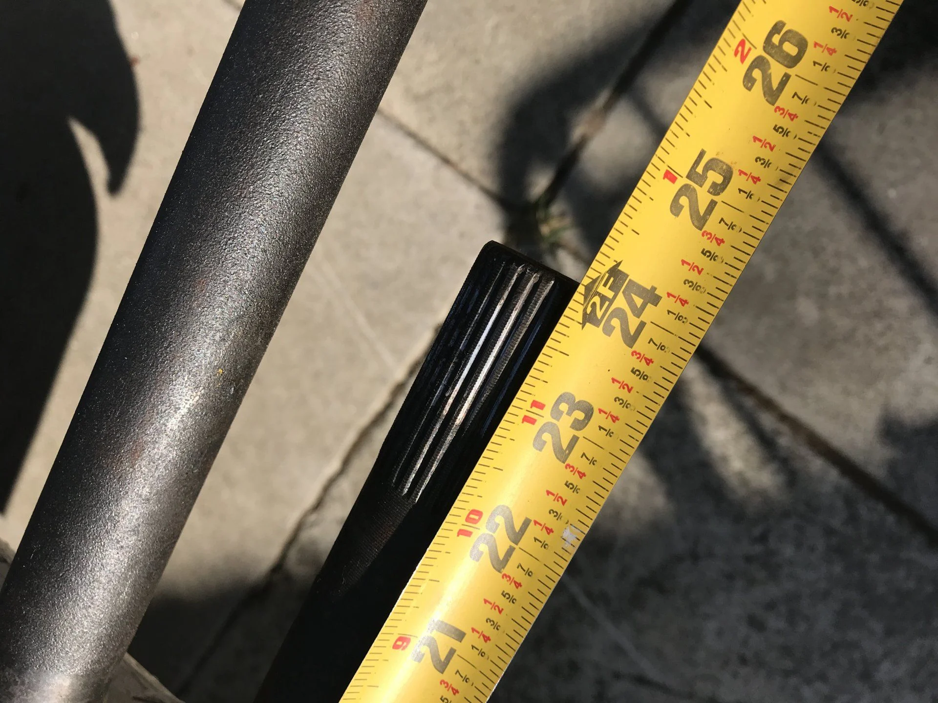

Short side of my 70 series axle is 23 15/16ths
