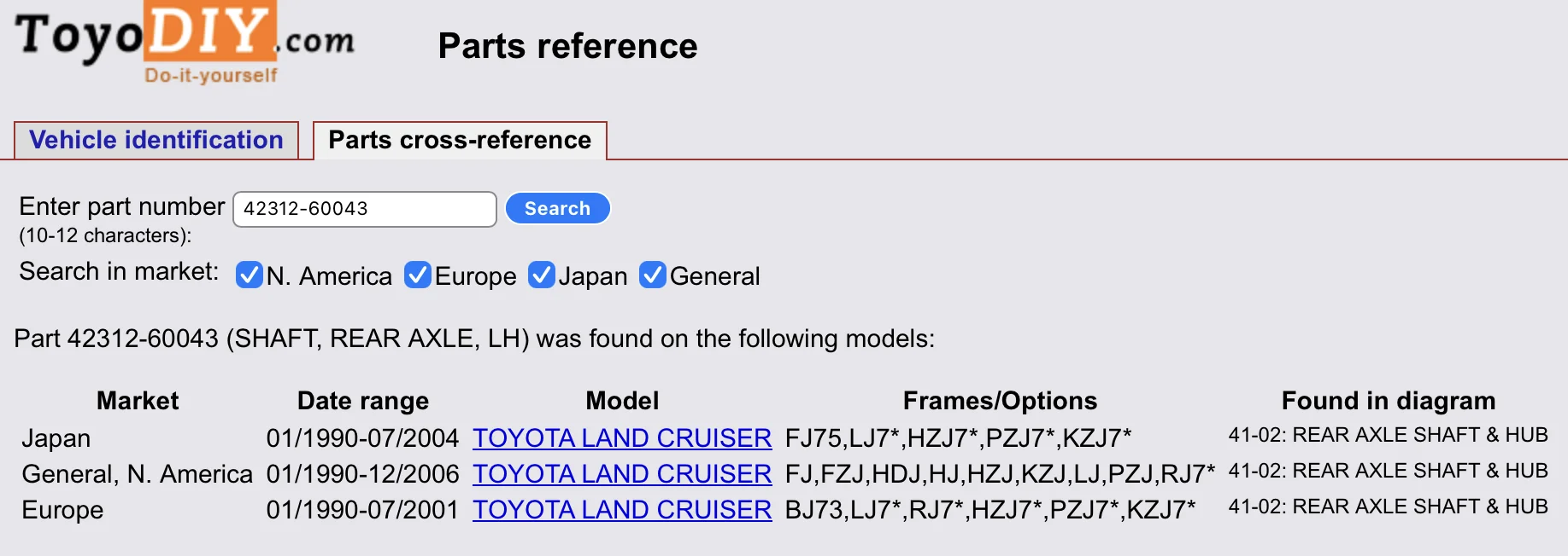

According to PartSouq for my 1995 HZJ75 with FF rear:
RH: 42311 60080 (FF w/diff lock)
LH: 42312 60042 (FF, no option for a different part number with Diff lock)
Neither of which are available in any case.
PartSouq doesn't mention any of these for my application:
RH: 42311-60053
RH w/diff lock (longer splines): 42311-60081
LH: 42312-60043
It does show 43211-60080 as a substitution for ...81
and ...42 a substitution for 42312-60043
Again, none of these are available.

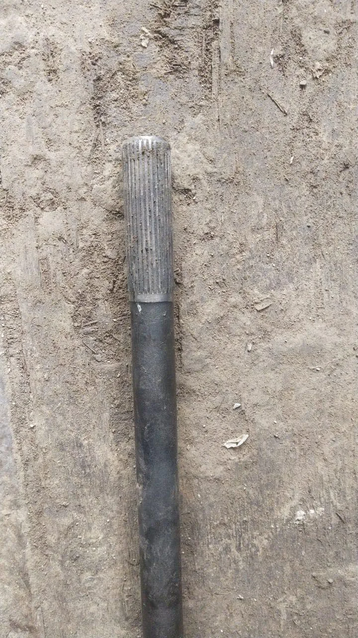

This is the long spline version for trucks with factory diff lockers... right?
Mark, where did you find the axle shafts? I am just getting around to prepping the axle (need to move the spring perches) to install on my 40. I do have a 80 locker I planned on putting in the axle I bought from you. I havent been able to find anything on the long side shaft differences (locker vs reg FF).
I have not sourced any of the long splined shafts... I DO want to get a "spare" for the rear though.... "just in case"

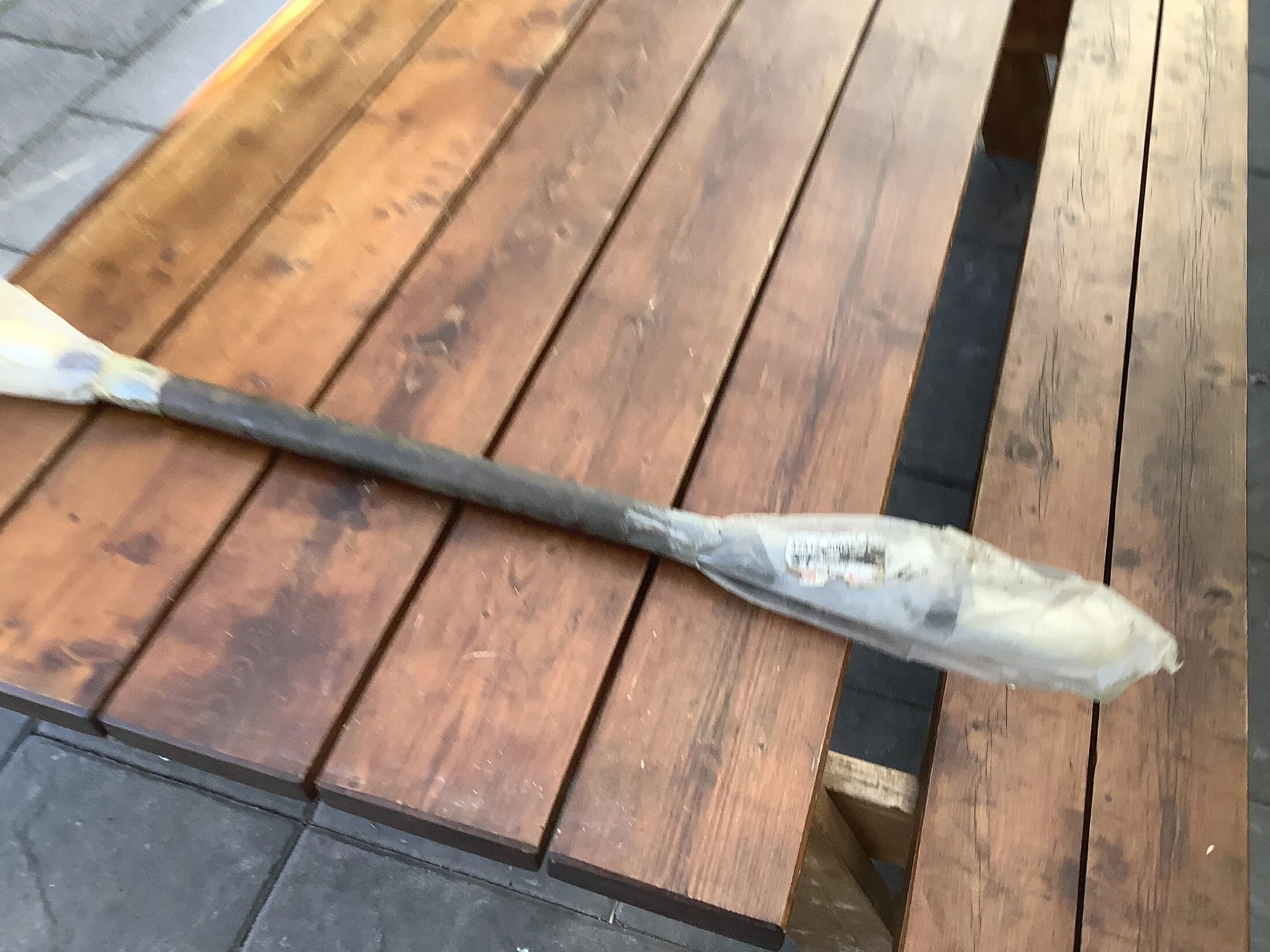

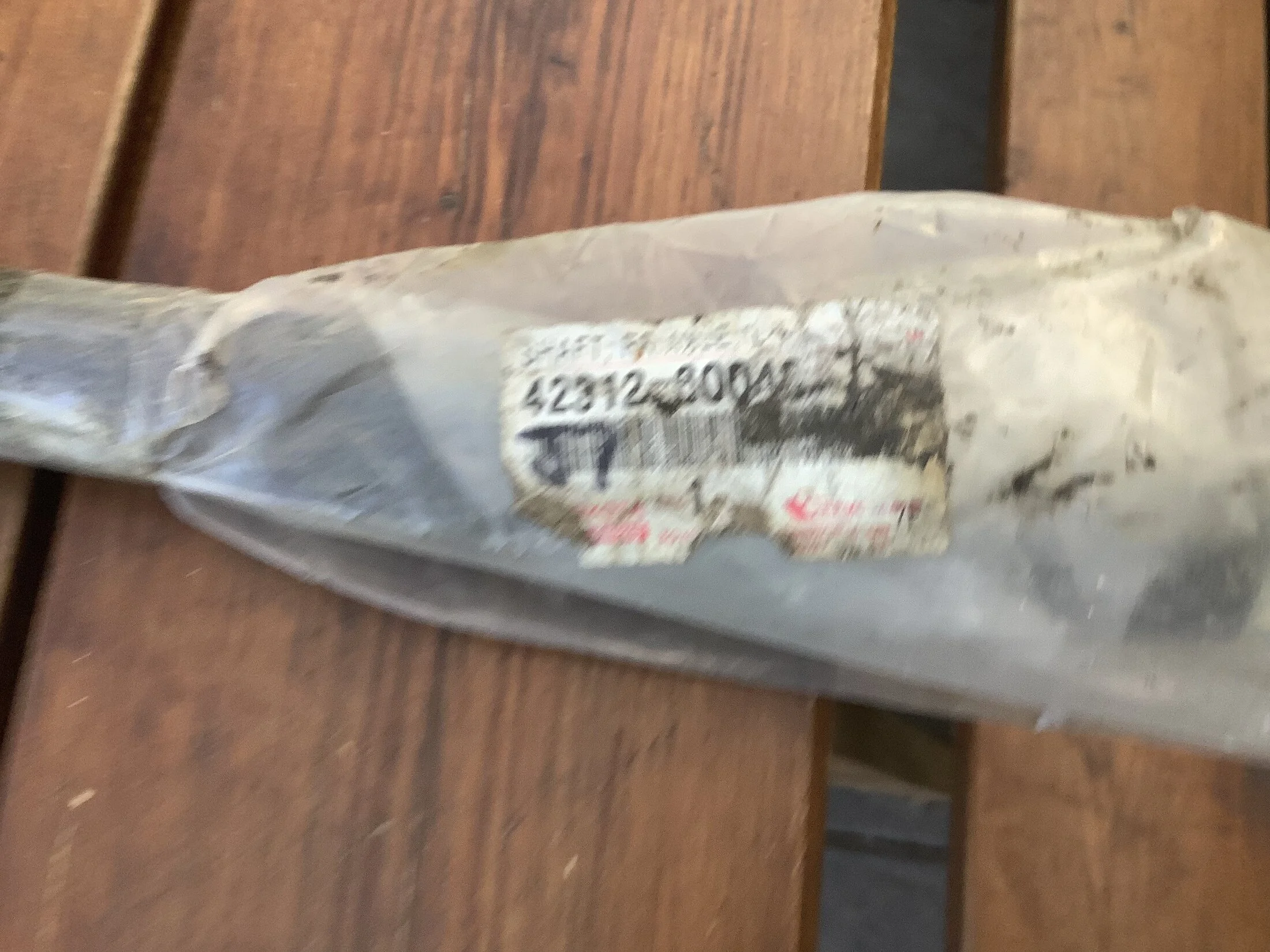

If anyone is in need, I’ve got a 911mm NOS Long side, short spline shaft available. 42312-60043
$400 plus shipping
