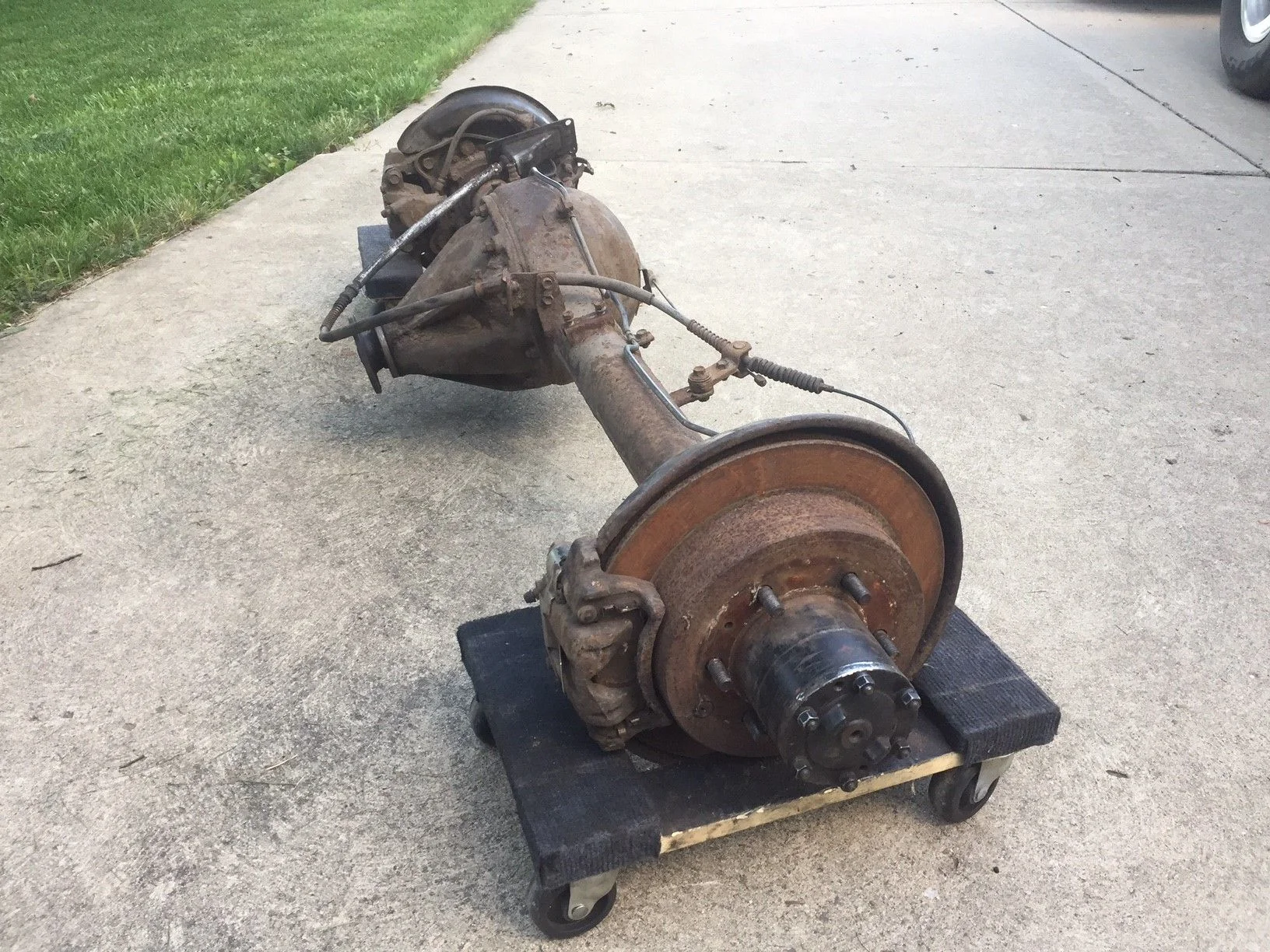

Re: the specs needed to source the 70 series axle shaft... Here is the info I have from when I bought the axle from @AlbertoSD
"late 70-series Full Floating rear axle with factory disc brakes (6-lug style) for sale. It is complete, with park brake cable included.
The 70-series axles have the same track as a 40-series"

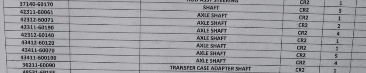

I'm pretty sure I can help you out. I'll be inventorying another crate of mine surplus parts this weekend that should have some of the shafts you are looking for.

Can you tell from the picture specifically what model year/ version that axle is? I'm trying to get in touch with @AlbertoSD to see if he knows but I haven't heard back yet.
1990 to 1997 from a HZJ73 have those axles and I think yours came out of a 94 that I sold to Alberto

next year I might have a few , I am doing a deal back home that involves a few dozen axles in a group buy , some of them are incomplete and will be parted out.
