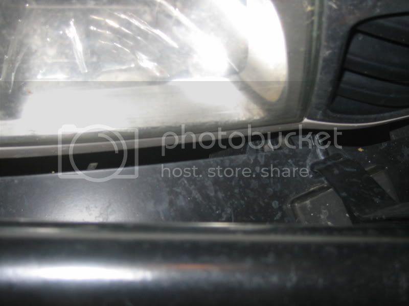

Someone was inquiring about the bumper to body gap with the +03 ARB combo bar. Here is a shot. My minimum bumper to body distance was slightly higher than what ARB called for in the directions. The minimum distance was by the fenders, not the front. I think it was a good question, since some may balk at this kind of gap.
