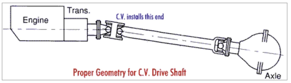

In typical double cardan install, the pinion is pointed towards the transfer case. If not and the pinion angle on the diff is parallel to the t-case, the diff will constantly change rotation rates (there is no 4th, complementary u-joint that would cancel out the angle at the diff). Double cardan end is a CV..... constant velocity.
May or may not be noticeable on small angle/long driveshafts but that is what happens. One might say, "I have adjustable control arms, I can change the pinion angle." Maybe so to some degree but the spring perches and panhard bar will become further out of alignment.
