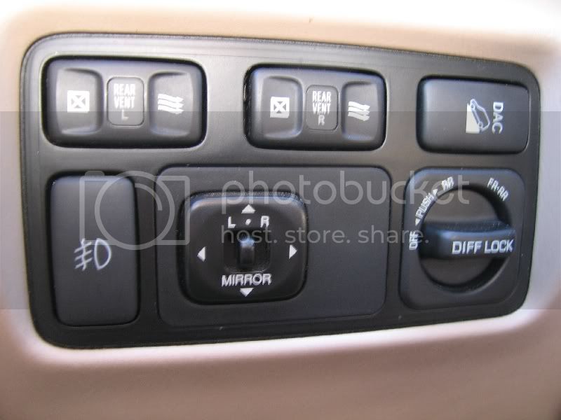

Here is a console picture after Slee's locker install. I had them install an aux lighting switch while they were in there. Both the DAC and aux lighting switch have backlighting.
Take note of the appropriate positioning of the DAC switch.

BTW, very cool truck, and nice OEM look on the controls above!

Where is the ARB air compressor switch?

It's the DAC switch. BTW, very nice website. It was one of the contributing factors in helping me decide to try out and buildup an LC.
Excellent way to hide that switch, you guys are really driving me to look into a front locker with all these ultra clean installs.
