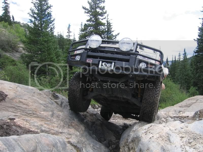

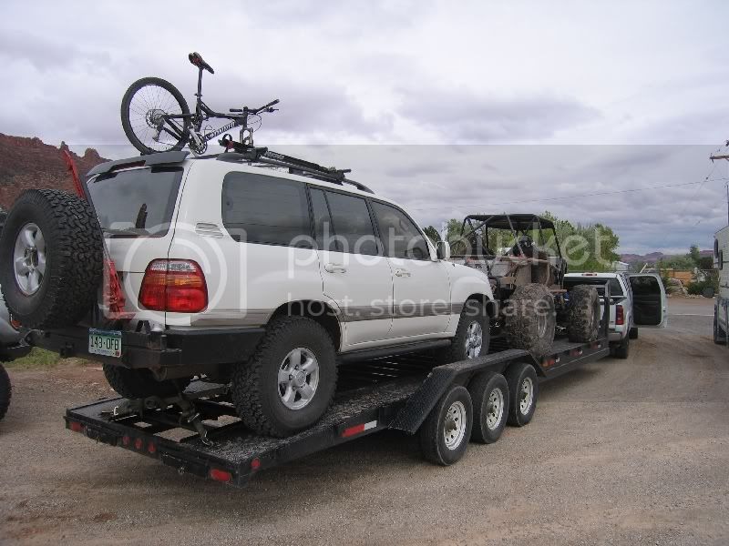

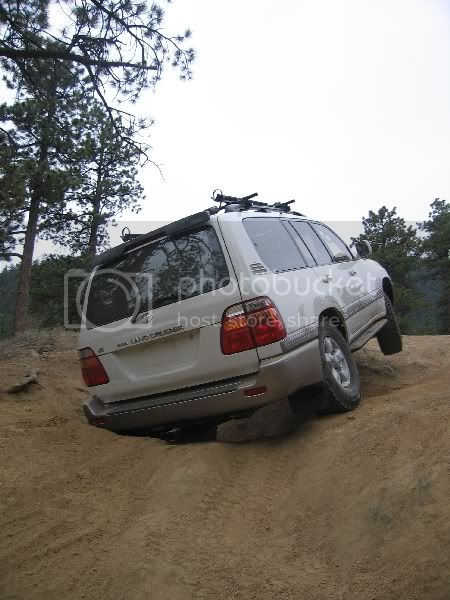

Some trail pics. I will follow-up with a few more details in the following days.
One of my few shots on level ground,
CM2007,
Tranny dead. Time to go home. Again, thanks to Ben and Slee for the tow.
Close to stock. This is a few weeks after I got it - still has temp plates. Telluride and Left Hand Canyon.
