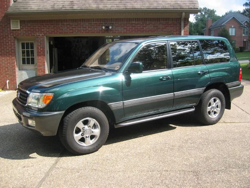

Here's a pic of the 100 right after I got it.

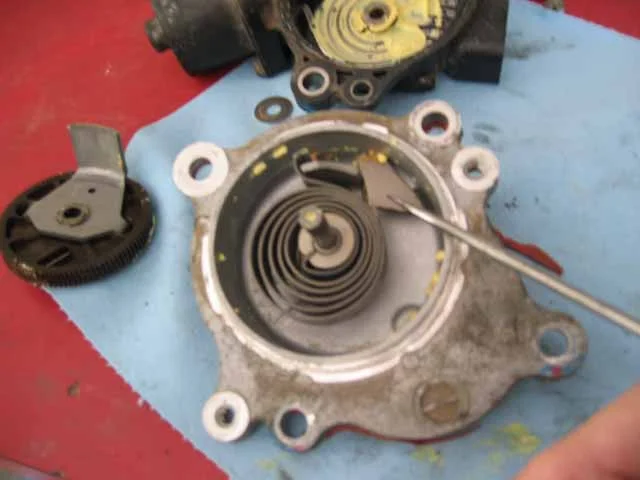

The only other mechanical issue that I have had is a broken CDL Actuator at Cruise Moab last year. On the second day of trails, the CDL light would not go off. So, I drove the final two days of trails with the Center Diff locked the whole time. After the last day of trails, I pulled the rear drive shaft and drove the 100 from Moab to Louisville, KY with no issues. Once home, I pulled the actuator and found it broken. I was able to source a used actuator assembly from a salvage yard for $140.00. List price was almost $600.00! You can read more on this here.
One note of thanks to LexusBen again for all of his help in diagnosing my problem and spending a lot of time on his back, in the dirt on a dirty tarp, trying to get the actuator to release on my 100. Unbeknownst to either of us at the time that it was actually broken and not just bound up. :beer: :cheers: Thanks Ben!

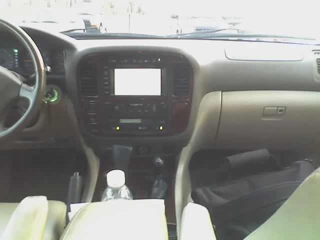

I started with some basic mods like removing the factory running boards, factory roof rack, and rear spoiler. I also added Husky liners in all three rows and removed a large portion of the factory wood trim kit.

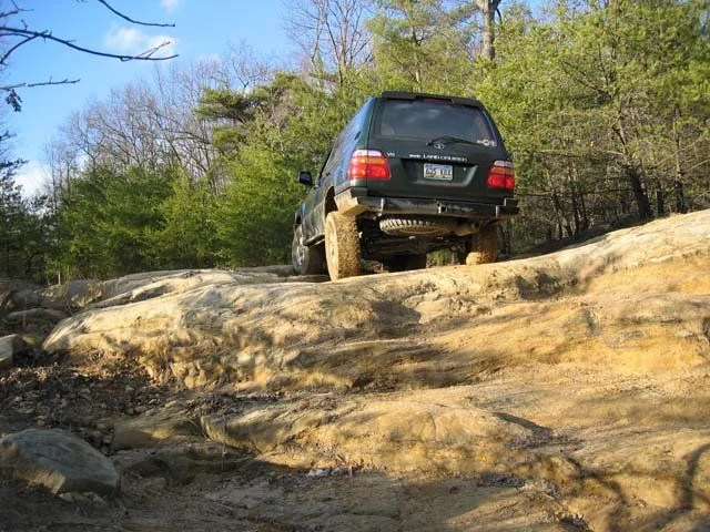

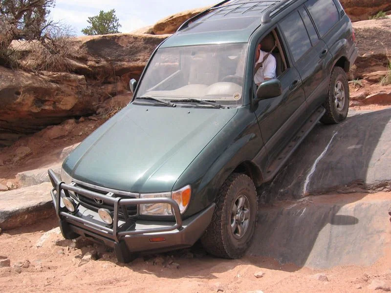

The next step was to add OME suspension, Diff drop, and sliders from Slee Offroad. I started with OME t-bars, N133 shocks, and Slee Diff Drop kit in the front. I also added OME 866’s and N101’s in the rear.
Here’s a pic with suspension and sliders with factory Michelin’s:

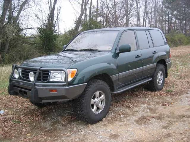

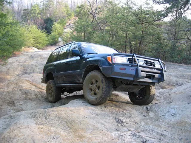

Next, I installed BFG 295x75’s and added an ARB Deluxe front bumper. I paint matched the ARB along with the Slee Step Sliders to keep a more “factory” appearance. I didn’t really want to go with the full bull-bar but I got a really good deal. I have since come to regret that decision basing it only on price.

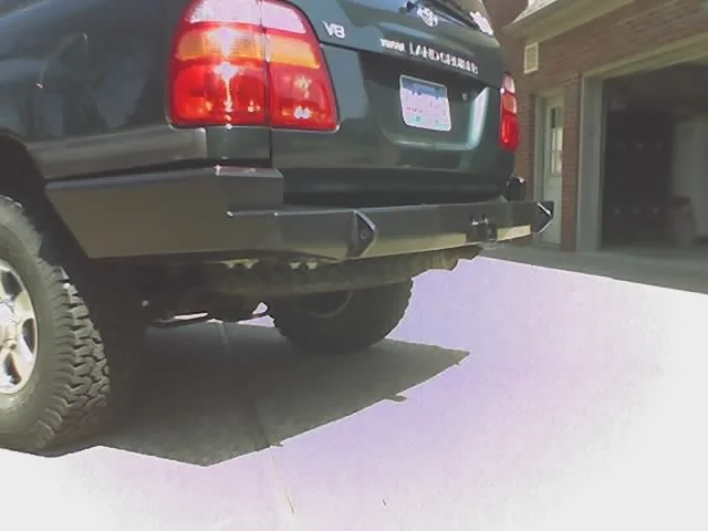

Once I decided that I was going to go to Cruise Moab last year, I started adding some additional items. First, I added a Slee rear bumper. I went with the model without the spare carrier. I know there are some good reasons to have the spare carrier, but for me I wanted a strong rear bumper that didn’t get in the way of the rear cargo area and still looked somewhat “stock” in appearance. I also plan to only run 33” tires, so clearance in the factory spare area is not an issue for me.
So, I modified the factory spare carrier to allow the spare tire to sit higher up in the factory location and I also went with a BFG 255x85 MT for the spare to allow even more clearance. The diameter of the 255x85 MT and 295x75 AT are almost identical.
I also paint matched the rear bumper as well to keep the “stock” look going. This series of modifications has proved very effective on my 100.

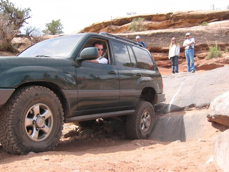

The next mod I did to get the 100 ready for Moab is I switched to OME 863’s and N74L’s in the rear. I was able to increase load carrying capabilities with the 863’s and I was able to add an additional 2.1 inches of travel with the N74L’s.
They required lower spring retainers, a longer bracket to re-locate the rear brake line and some half inch bump stop spacers to keep the N74L’s from over-compressing. This change to the rear suspension proved to be very effective in Moab. I know there has been a lot of debate over the N74L’s recently and I don’t want to get that started here, but I have had good results from them.

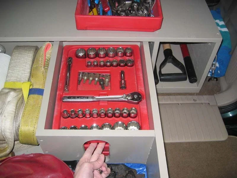

I also built a set of cargo drawers, added a Cobra cb radio, a fire extinguisher, a well stocked first aid kit, and full recovery kit. I have also accumulated a collection of Pelican cases and Action Packer boxes to hold all of my gear and it can all be strapped down to the cargo drawer system.
