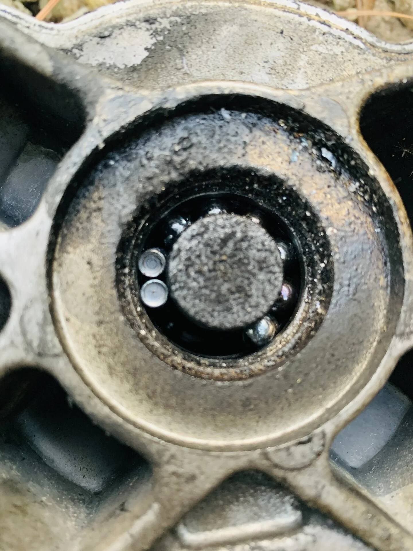

Gracious. My fan bracket bearing just went out on me with not a peep of a warning. I could have been many places today but happened to be 1/2 mile from home.
Bad one off now waiting on new Aisin bracket to arrive.

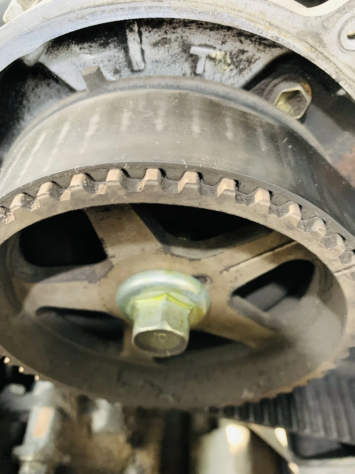

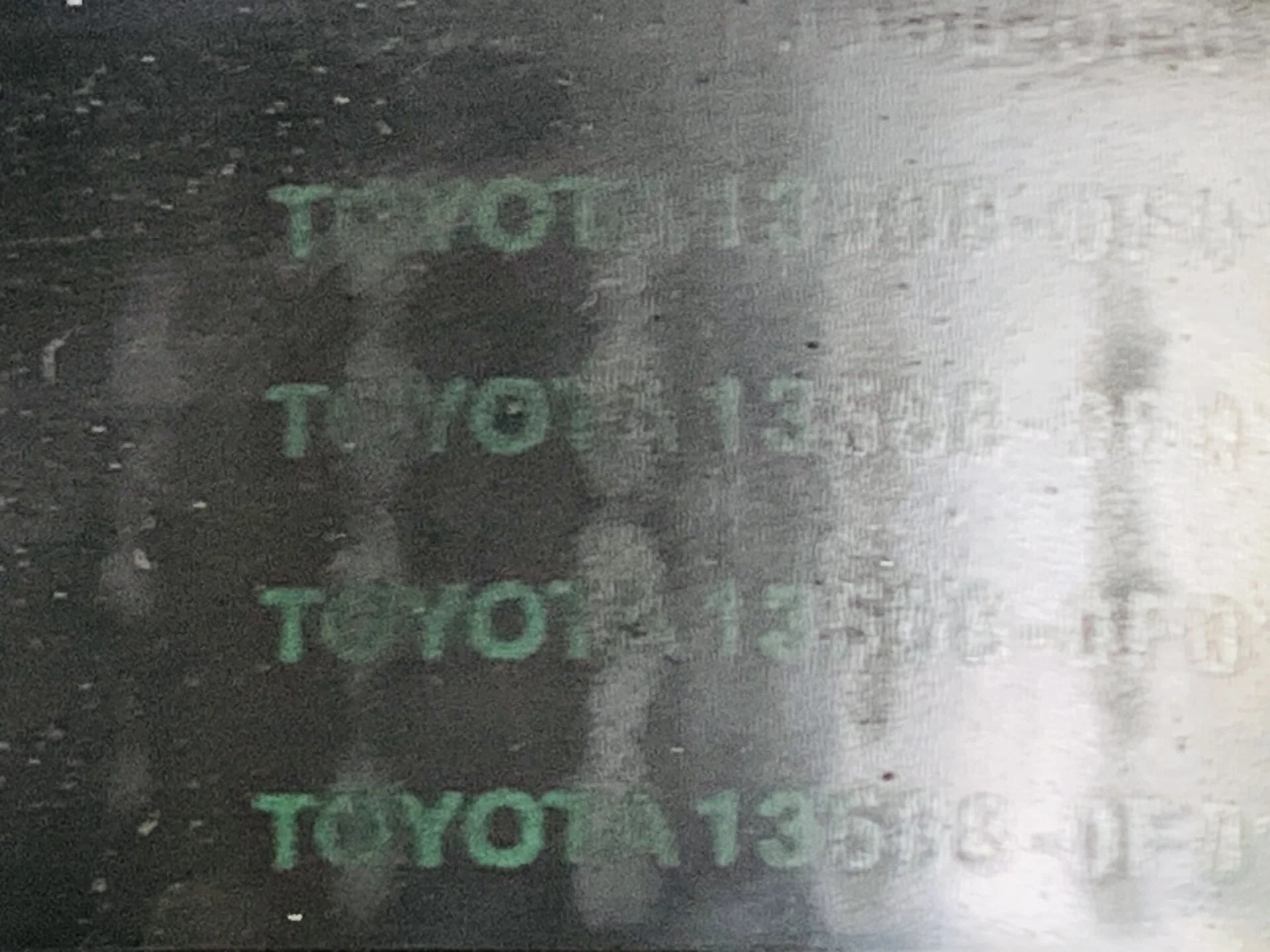

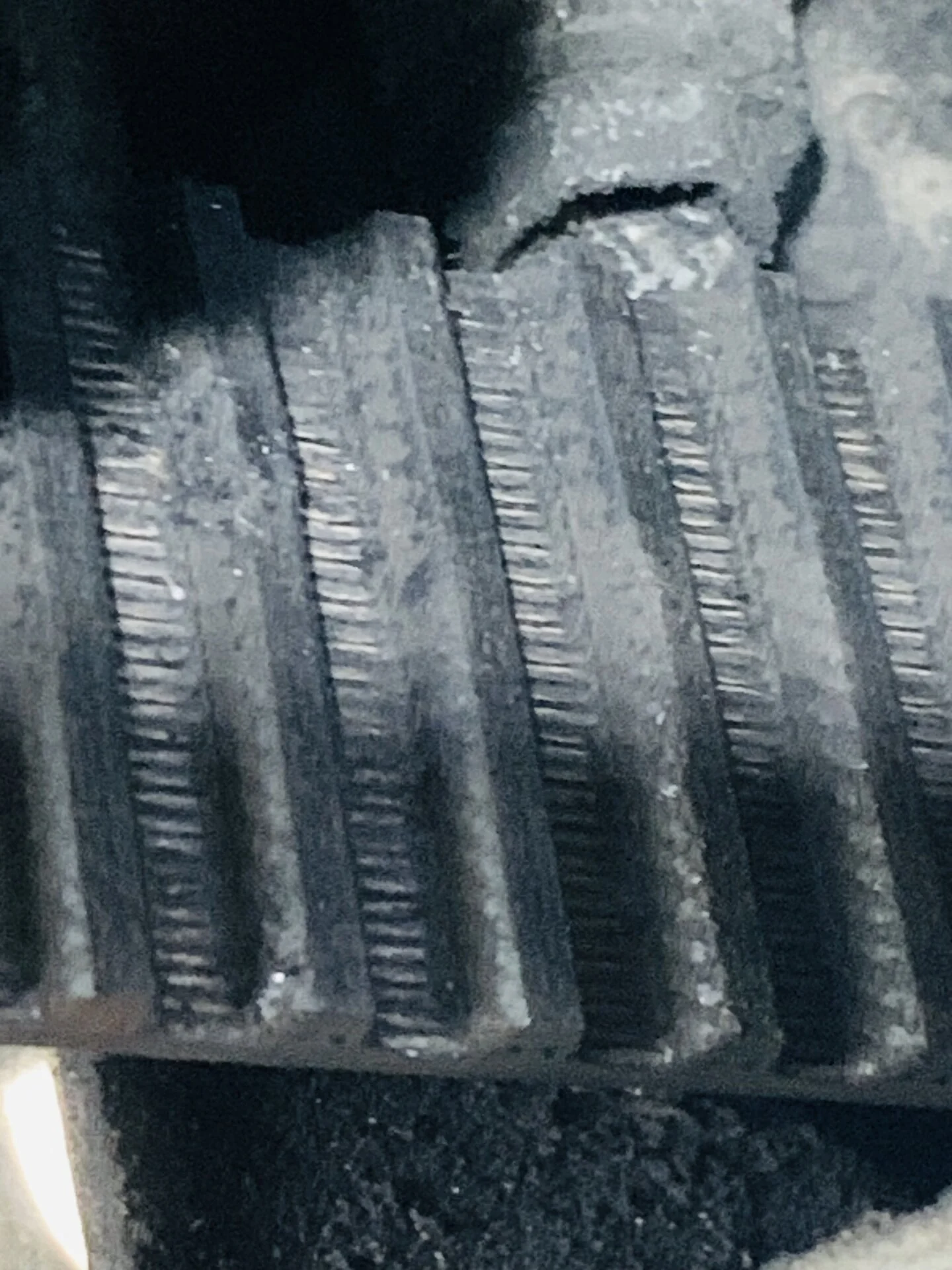

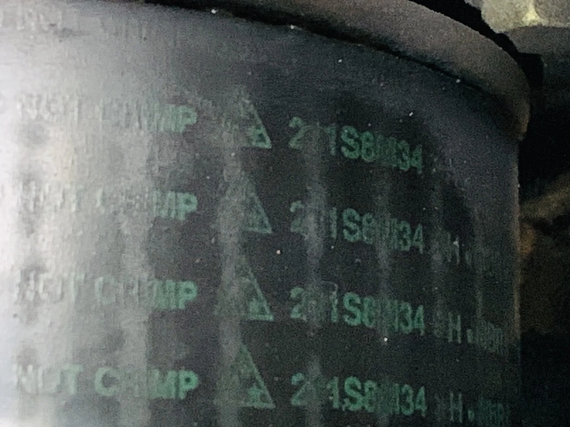

Bonus pictures of my 16 year old timing belt with 297k miles.
Trust me, ONLY an OEM belt can go this long. NEVER EVER do this with Gates or any other make. Not sure how Mitsuboshi would hold, but I do belts every 10-15 years or 125 K miles because I use OEM except in my Prizm, where you can do the belt in about 1 hour and it is non interference engine.
