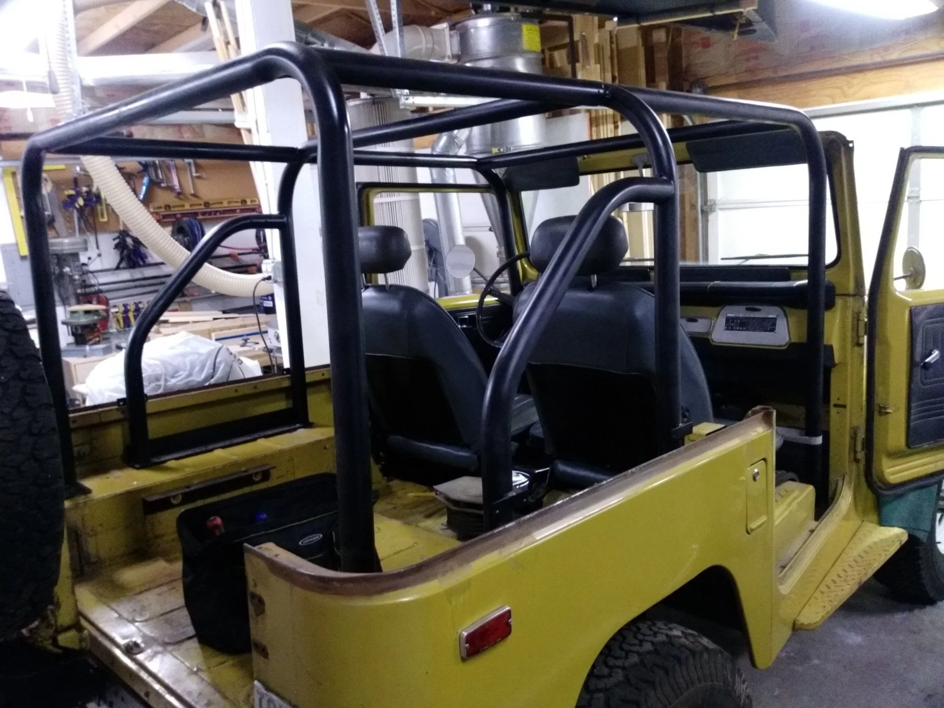

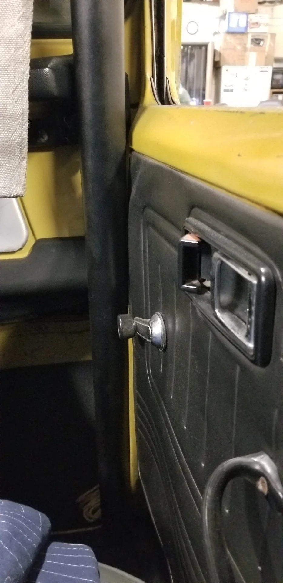

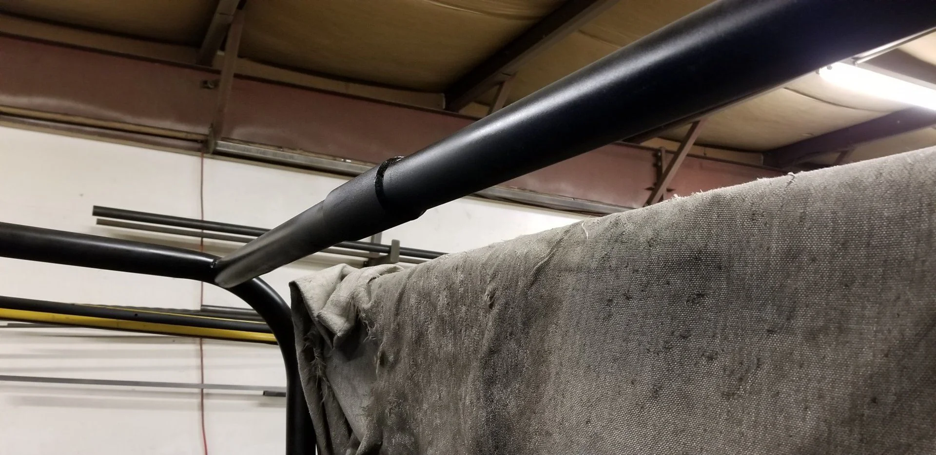

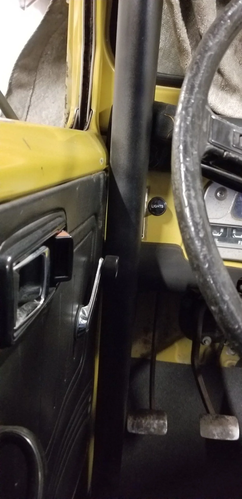

Thanks for confirming the differences in pre-75 cages. I really appreciate the great suggestions! I ended up having the front upper bar cut to remove about two inches. This reduced the width and brought the uprights in just enough to close the doors with a little clearance. I had an outer sleeve added over the cut for rigidity/safely. I wish I would have seen Lil'John's suggestion earlier about the inner sleeve, as I think that would have been better... Oh well. See pics below of the finished product. . Now I just need to fabricate the mounting braces for under the truck.
