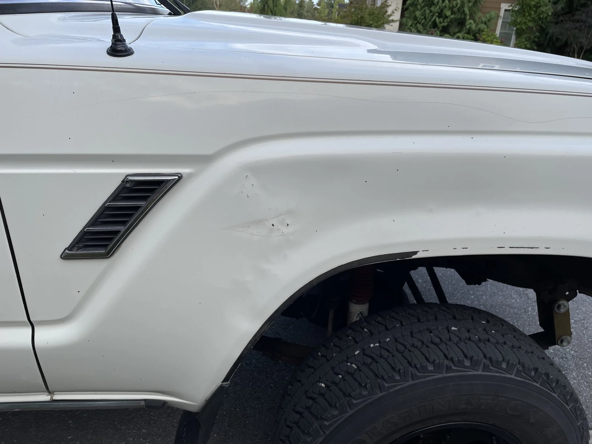

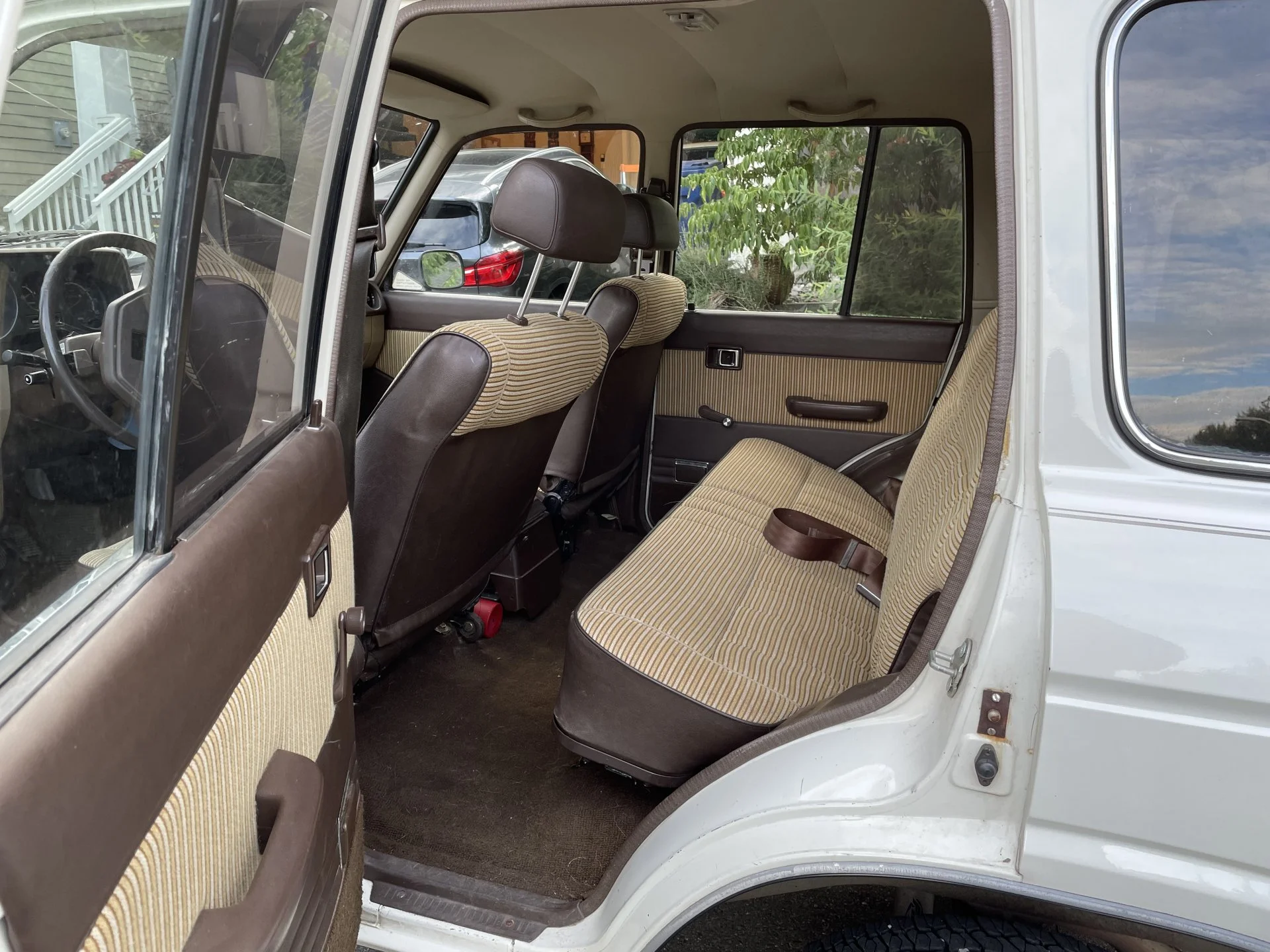

I spent the next 30 minutes crawling all over the rig making sure it was what I wanted. It had a few bumps and bruises but those just add character and tell the story this rig lived. I noticed it had provisions for a few different CB radios and an alarm system that looked more at home in a bank than a car. Also that sweet tape deck!
Everything looked good so we took it for a spin. Everything worked out, so we agreed on a price and loaded up the factory chrome wheels and paused to record this new chapter in Falcor's life.

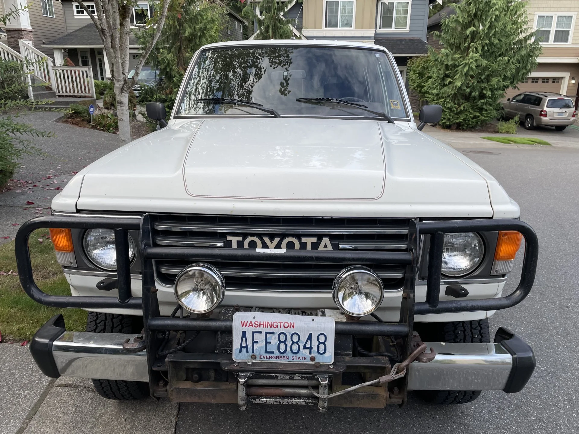

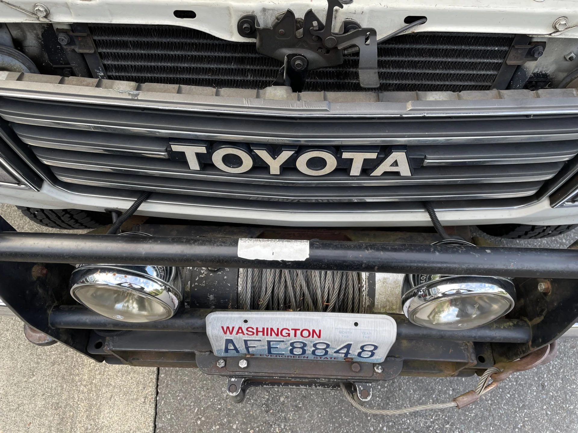

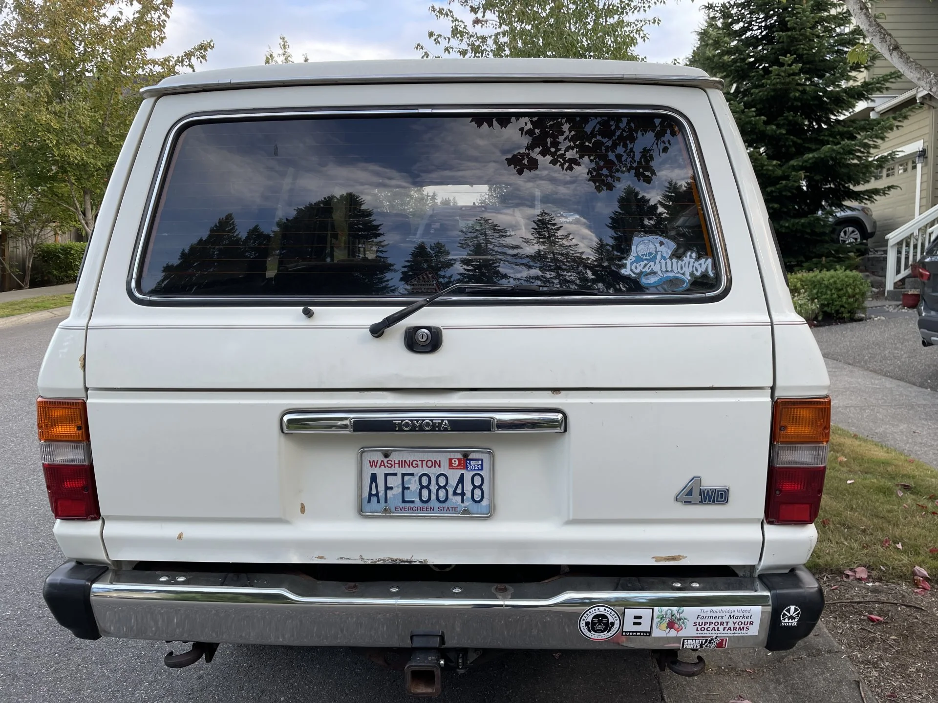

I'd like to get a stock FJ60 bumper on this thing.
If anyone wants this winch, brush guard and bumper instead of their stock bumper, let me know.
Edit - After seeing Falcor with this bumper for the past week, I have grown to like it. It's part of his character. I'm going to do a little rehab on it but nothing dramatic.

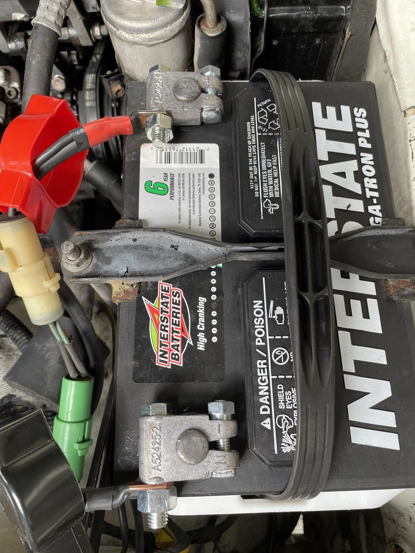

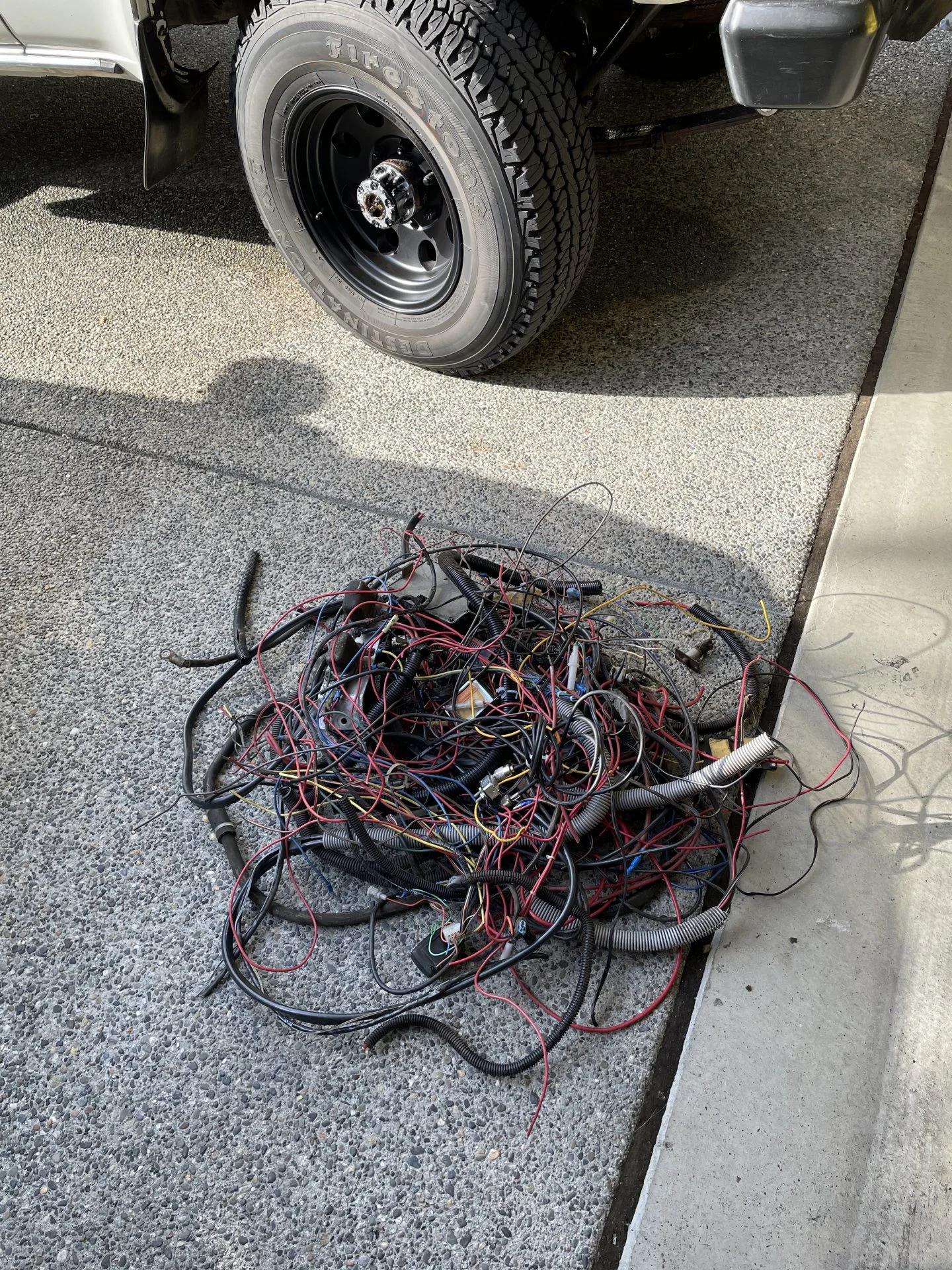

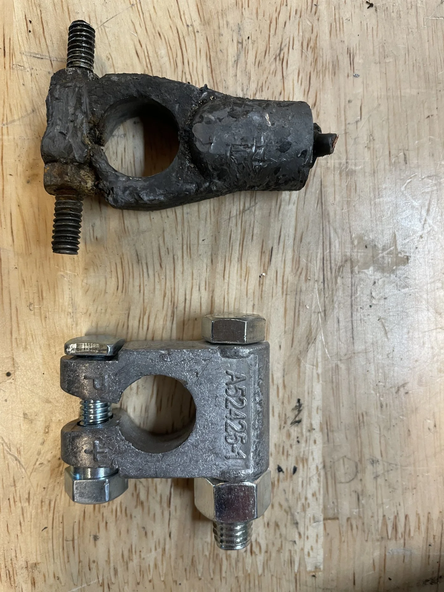

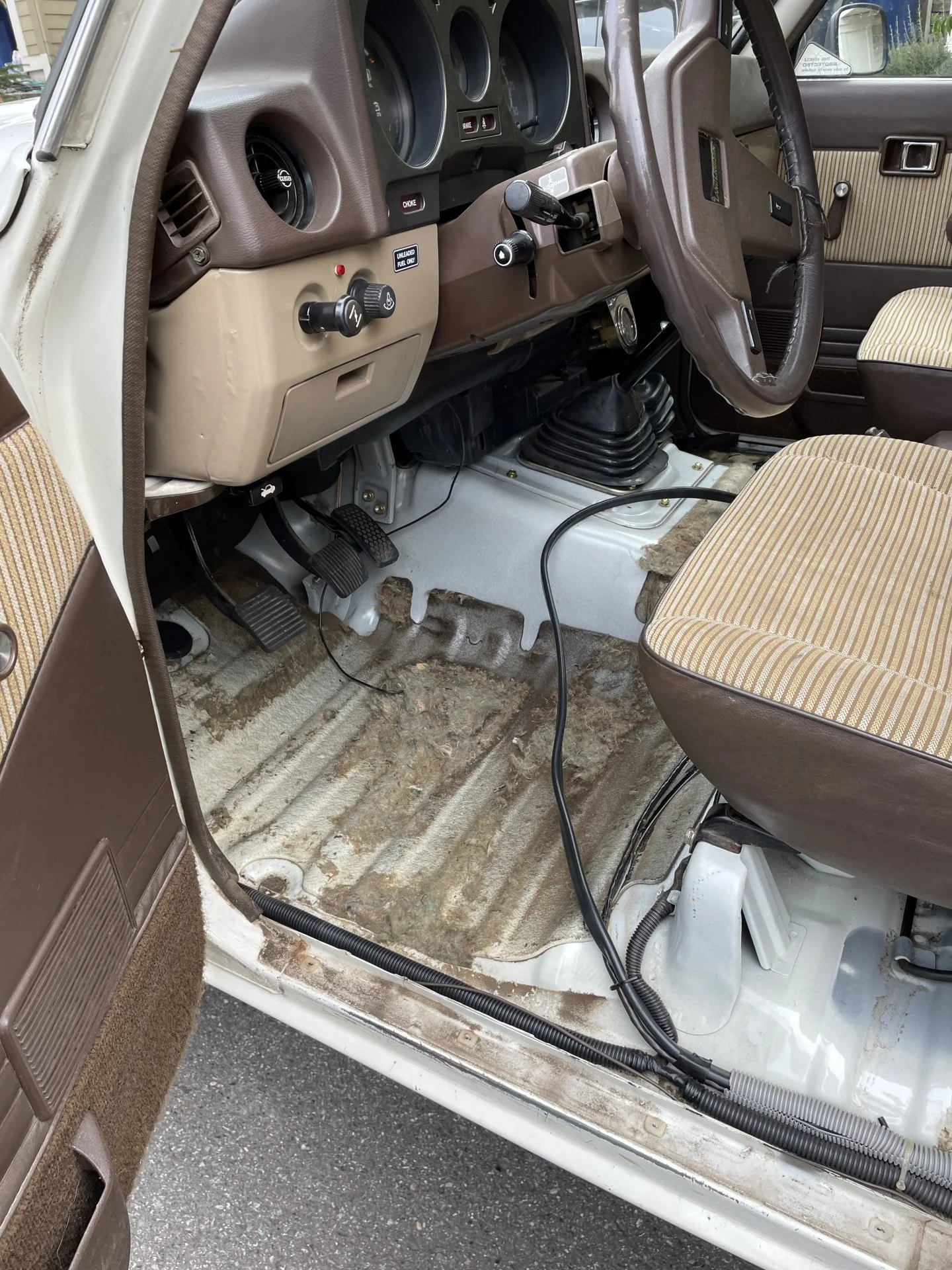

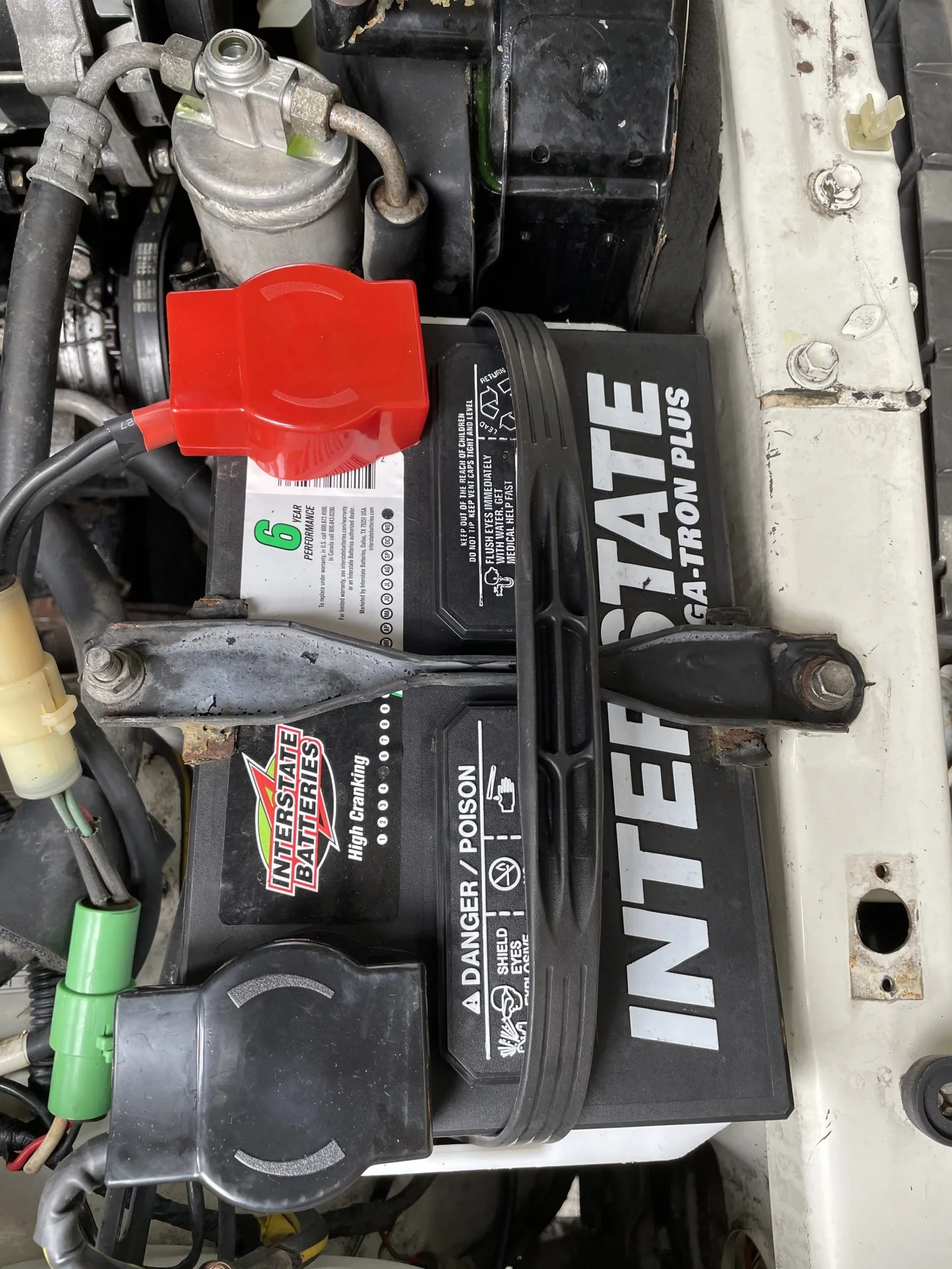

Removed a few non factory things today including about 8lbs of wires. Took roughly 4 hours.
Aftermarket cruise, 3 ham radios, bank alarm, trailer wiring with 2 hot 4ga wires going from the battery all the way to the back along the frame rail, 2 switches for who knows what, one had 6 wires on it, 4 huge circuit breakers and 8 feet of 6ga positive and negative that ran from the battery through the firewall and to the drivers side rear of the vehicle.
Some of the wires running down the frame had insulation so thin it was about to wear through right where it touched some of the brake line mounts to the frame. I'm glad it's all out.

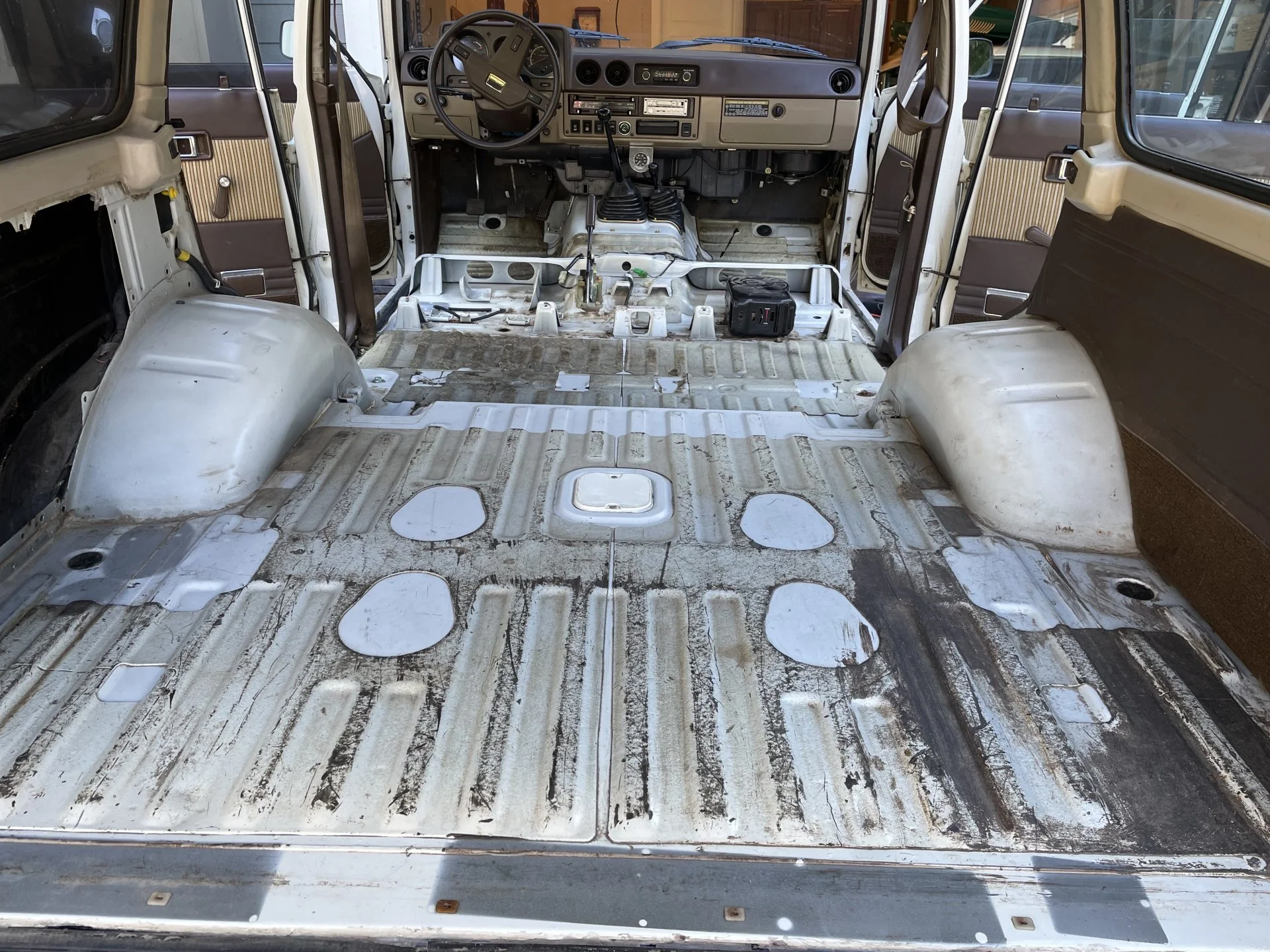

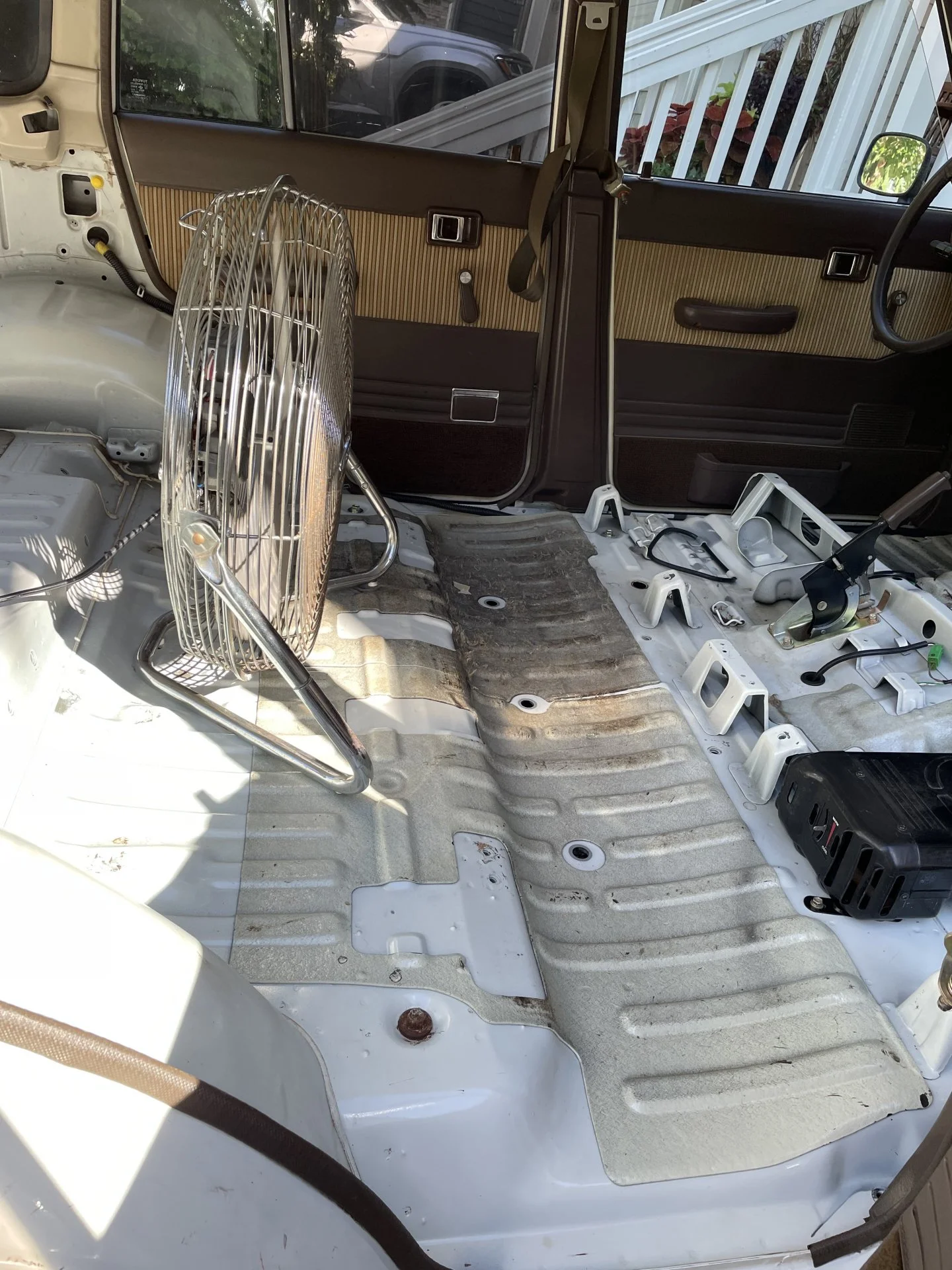

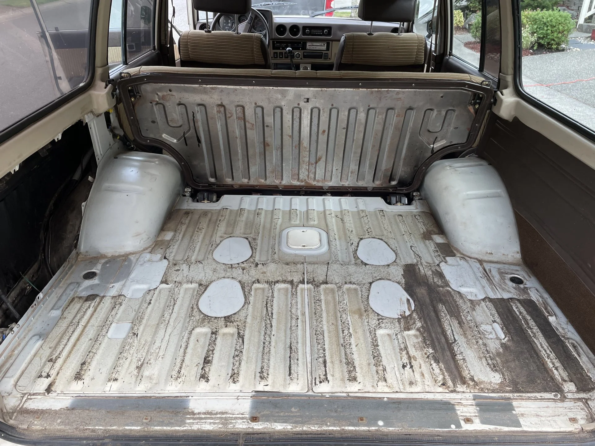

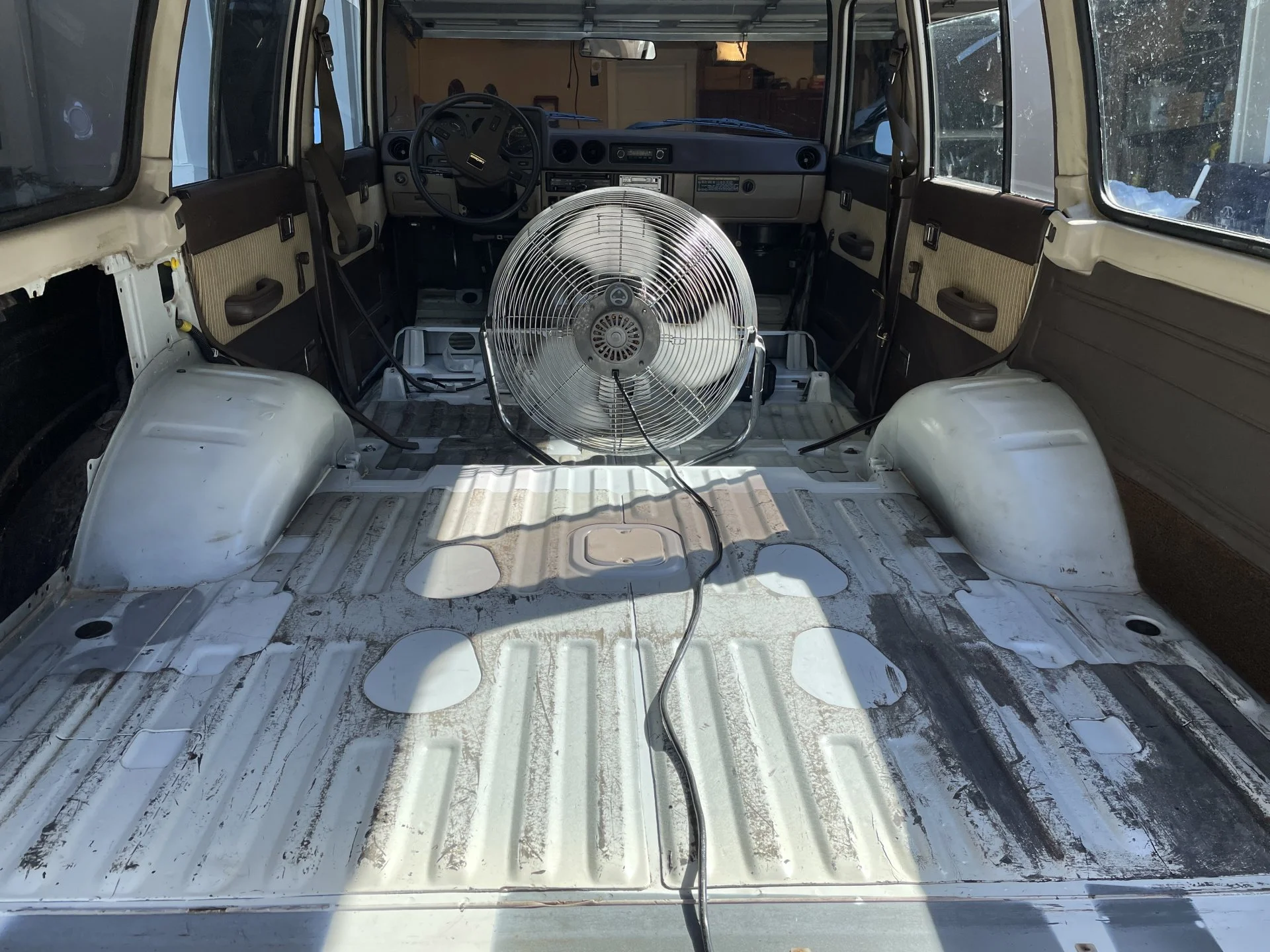

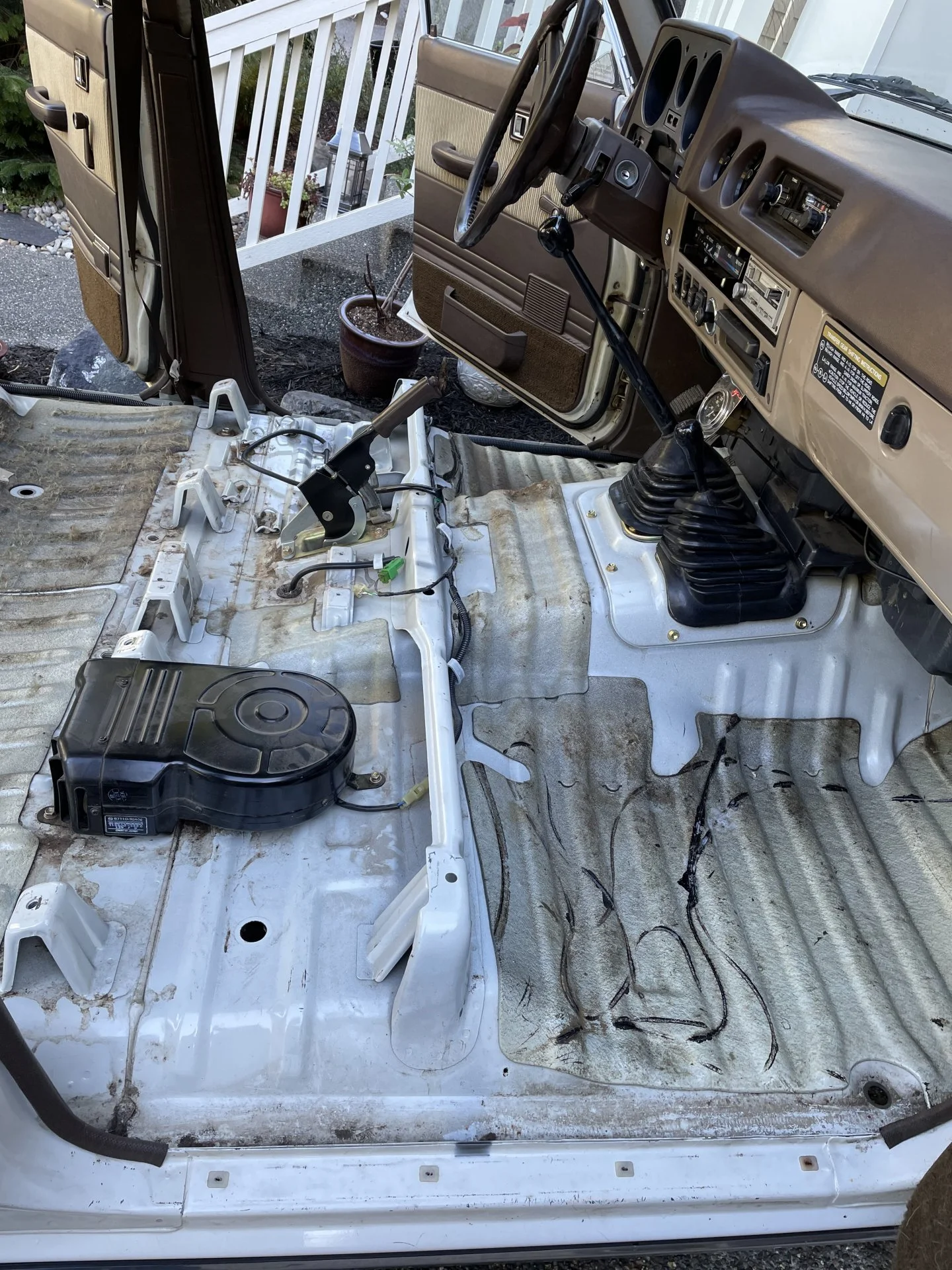

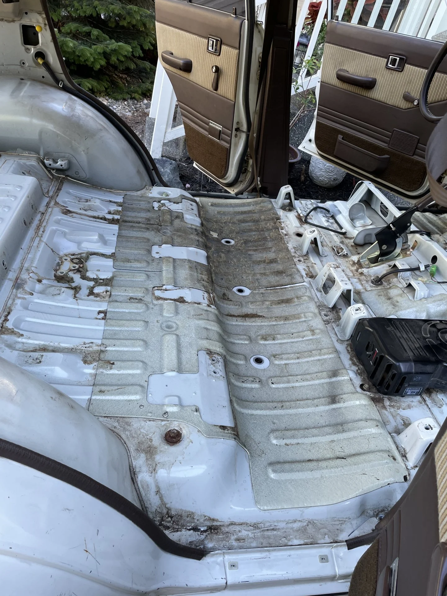

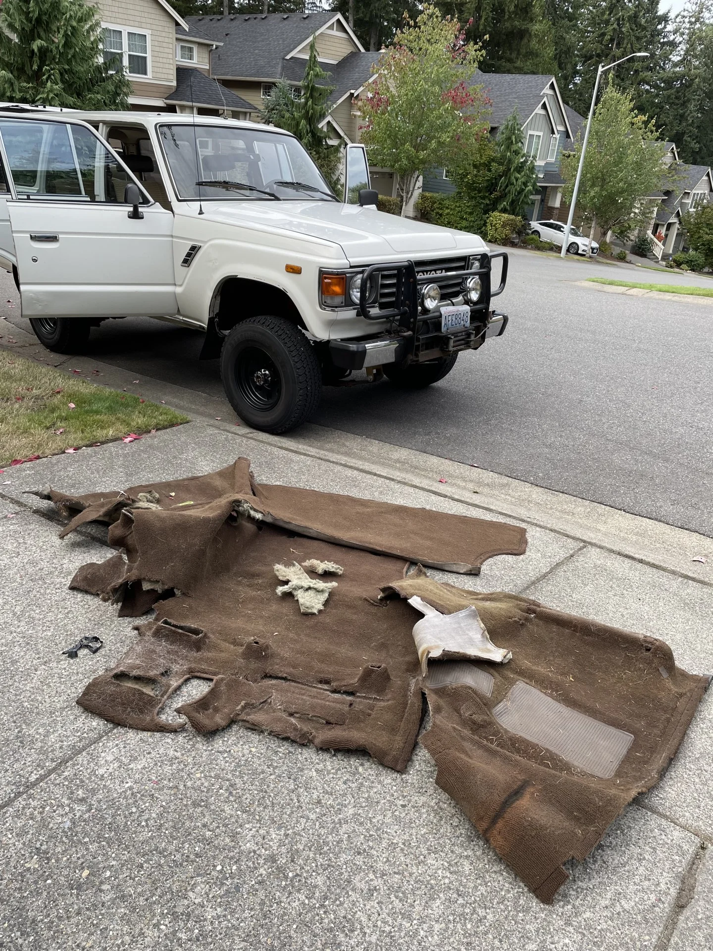

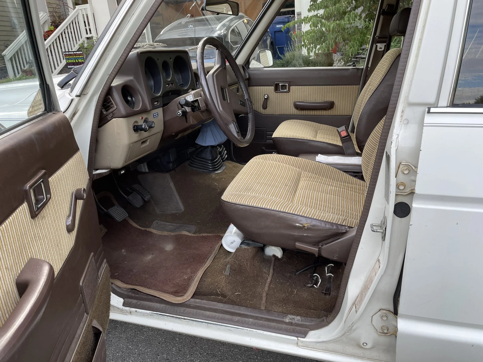

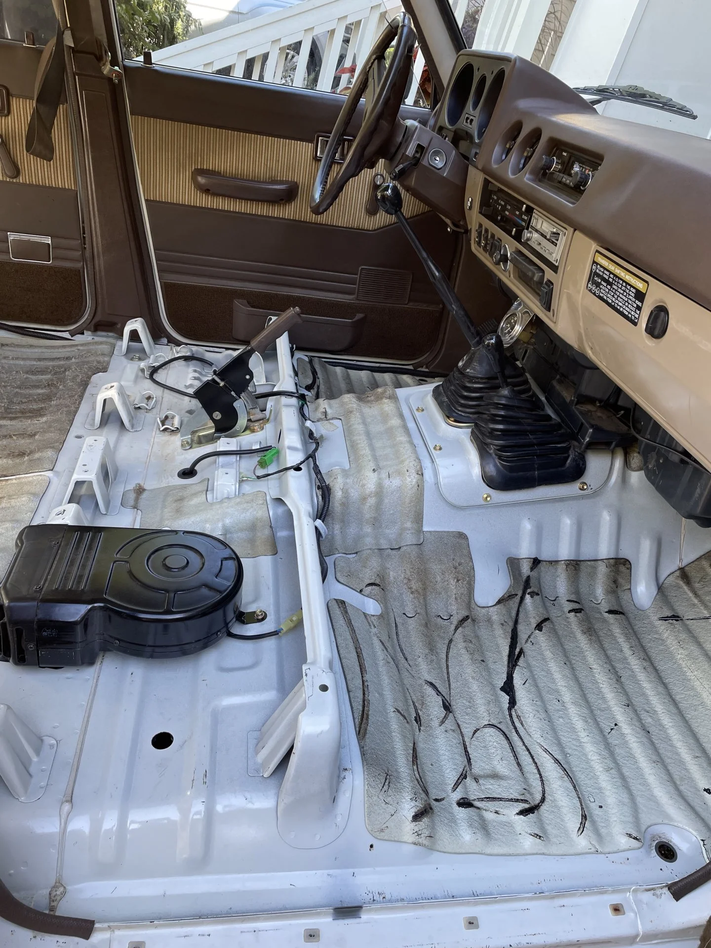

After thinking long and hard about how to clean the interior before laying down new carpet, I decided to just flush the toilet.
I removed all of the drain plugs then used heavy duty Simple Green and a brush, then I flushed it with hot water. I then blew it dry with a leaf blower and put a big fan in it for a few days.
Before

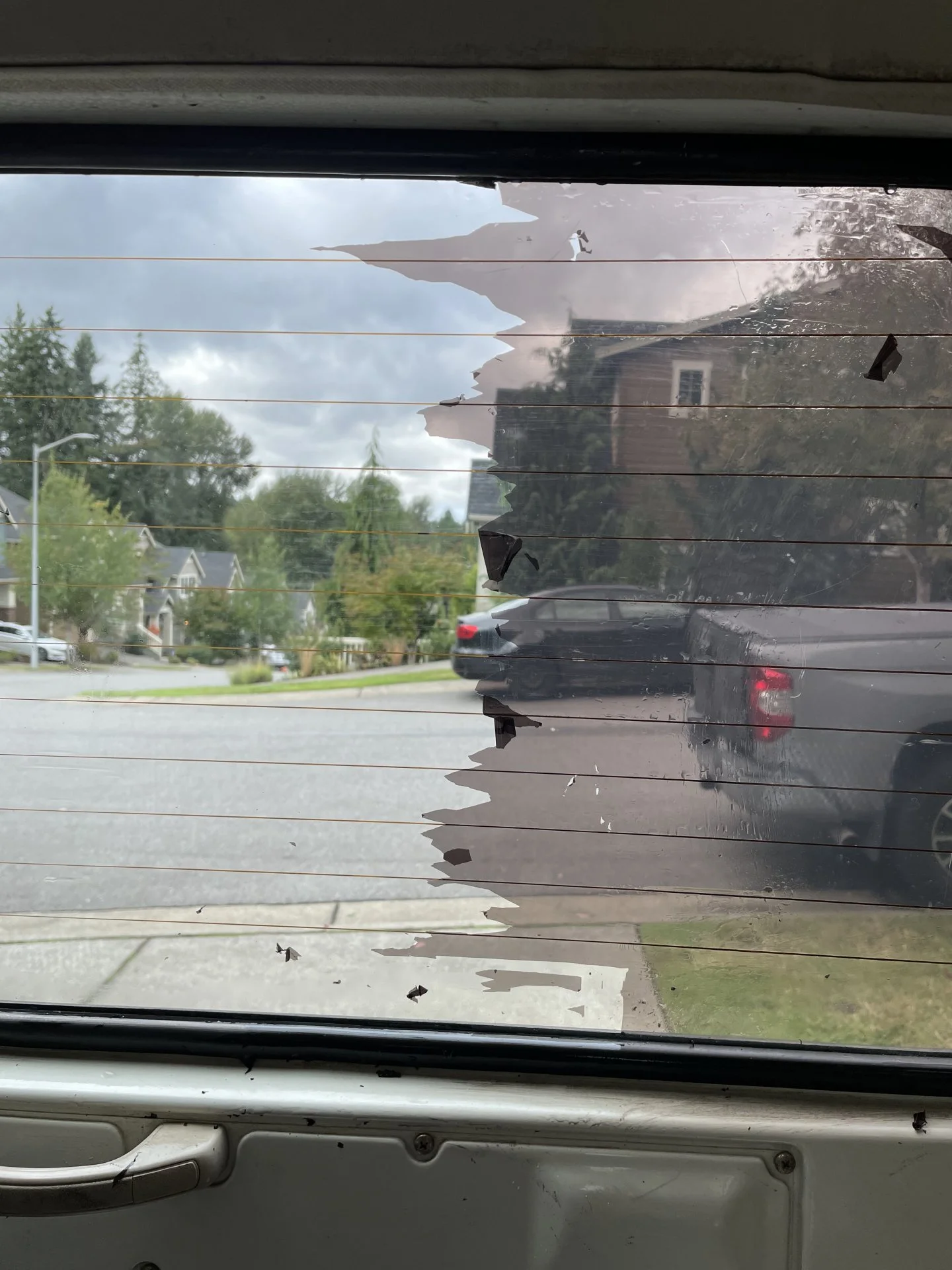

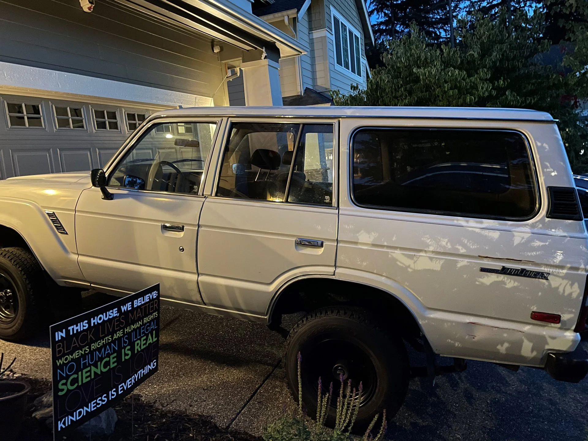

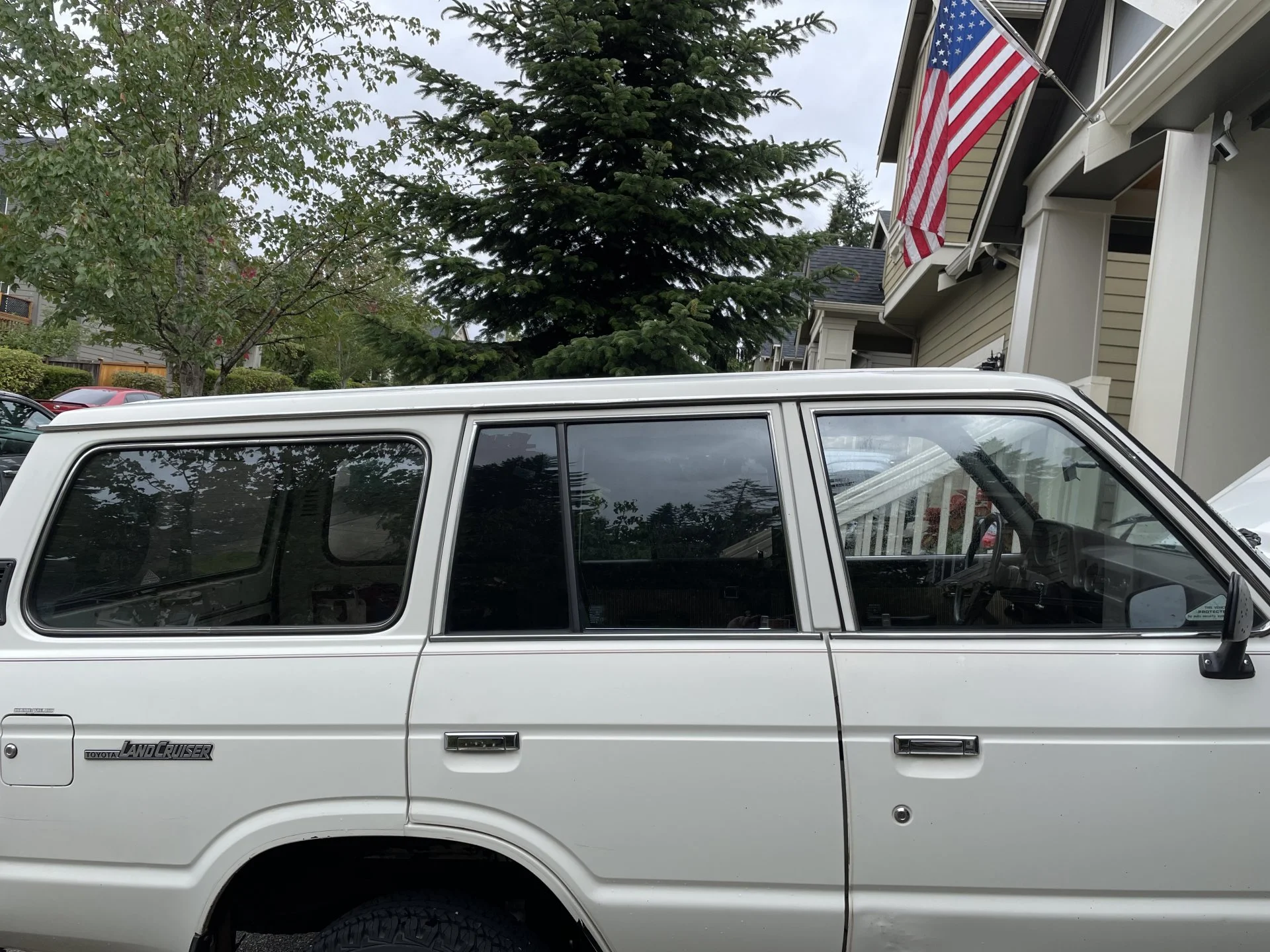

I also spent a little time removing the tint. It was only on a few windows so that made it easier.
I used a steamer and a razor blade it made it so easy!! I could actually smear it off with my hands after letting the steamer do it’s thing.
On the back glass I used the steamer and a dish scrub brush. The whole window took about 10-15 minutes.
I think it looks great without tint.

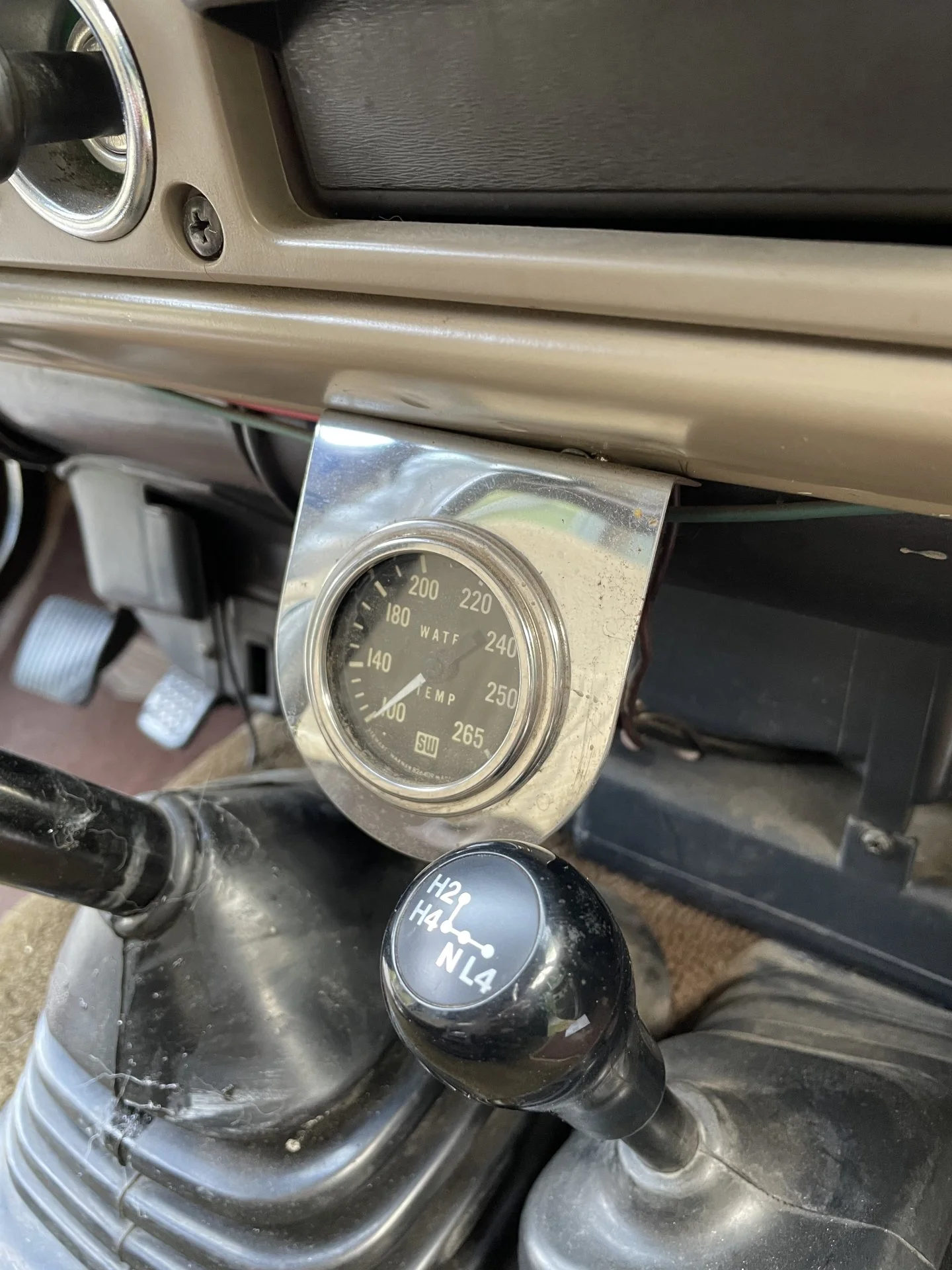

The good news is that the radiator cap fixed the radiator puking and the new thermostat has the temp gauge right where it should be. So between those things and the tint coming off so easily, I'm going to call today a win.
