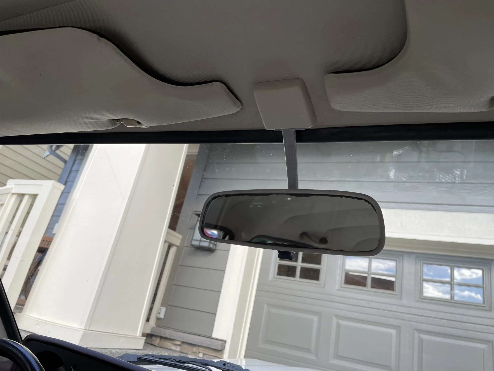

Found a used rear view mirror to replace the glued on one.

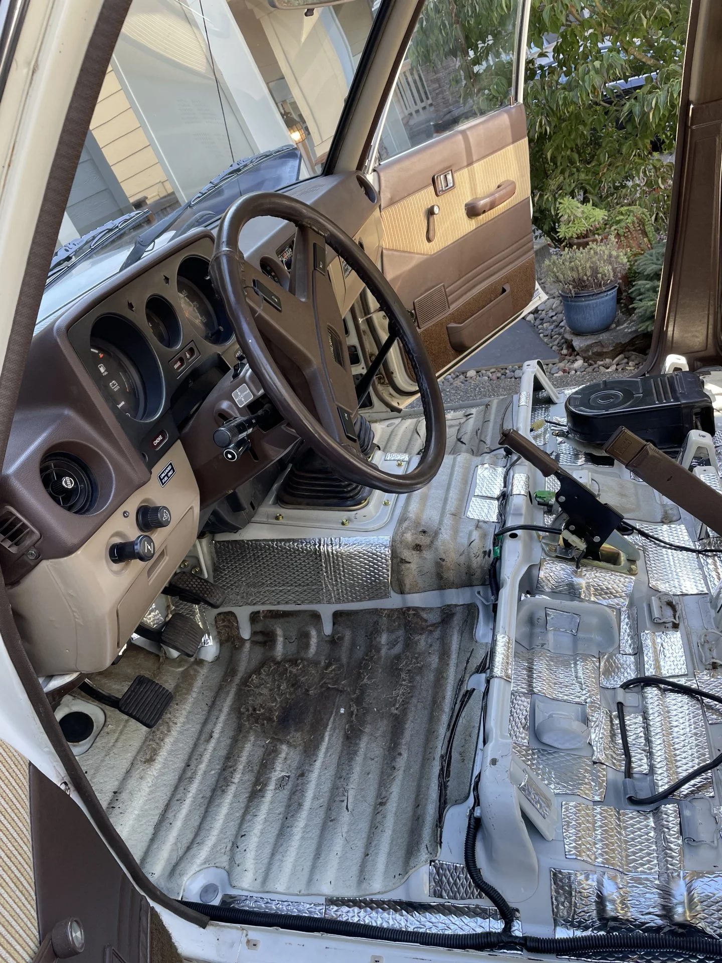

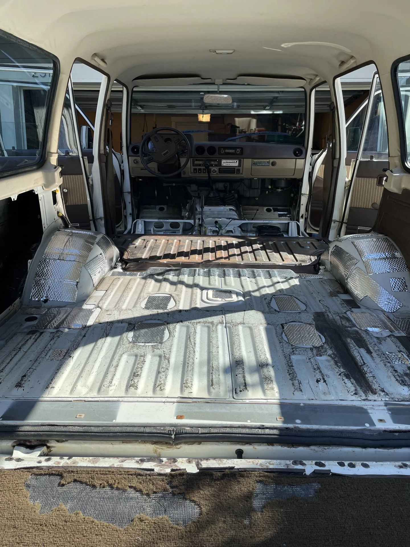

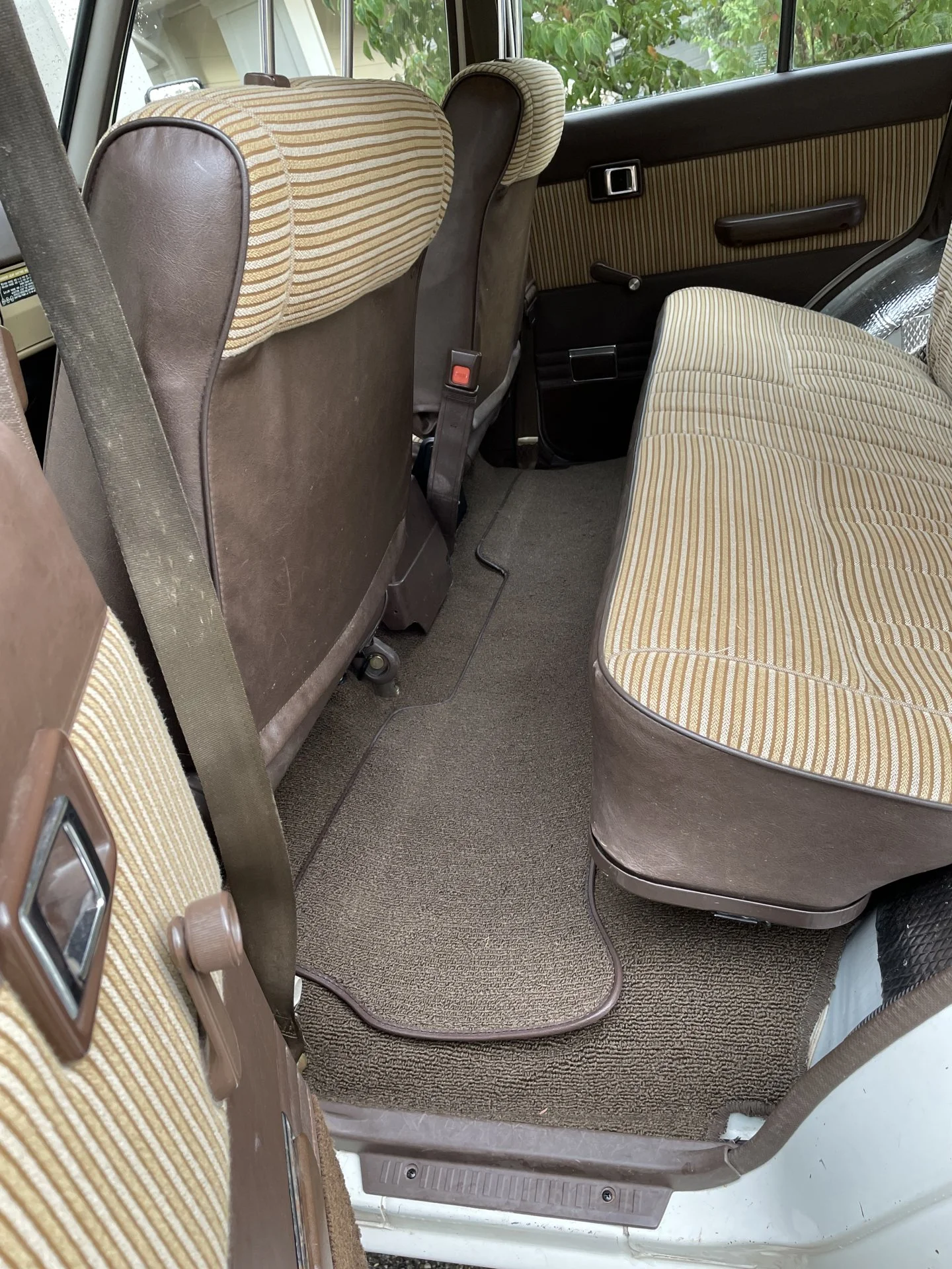

Carpet kit from @dnp went in smoothly. I still need to put the rear wheel well and tailgate pieces in, waiting for spray adhesive.
Before

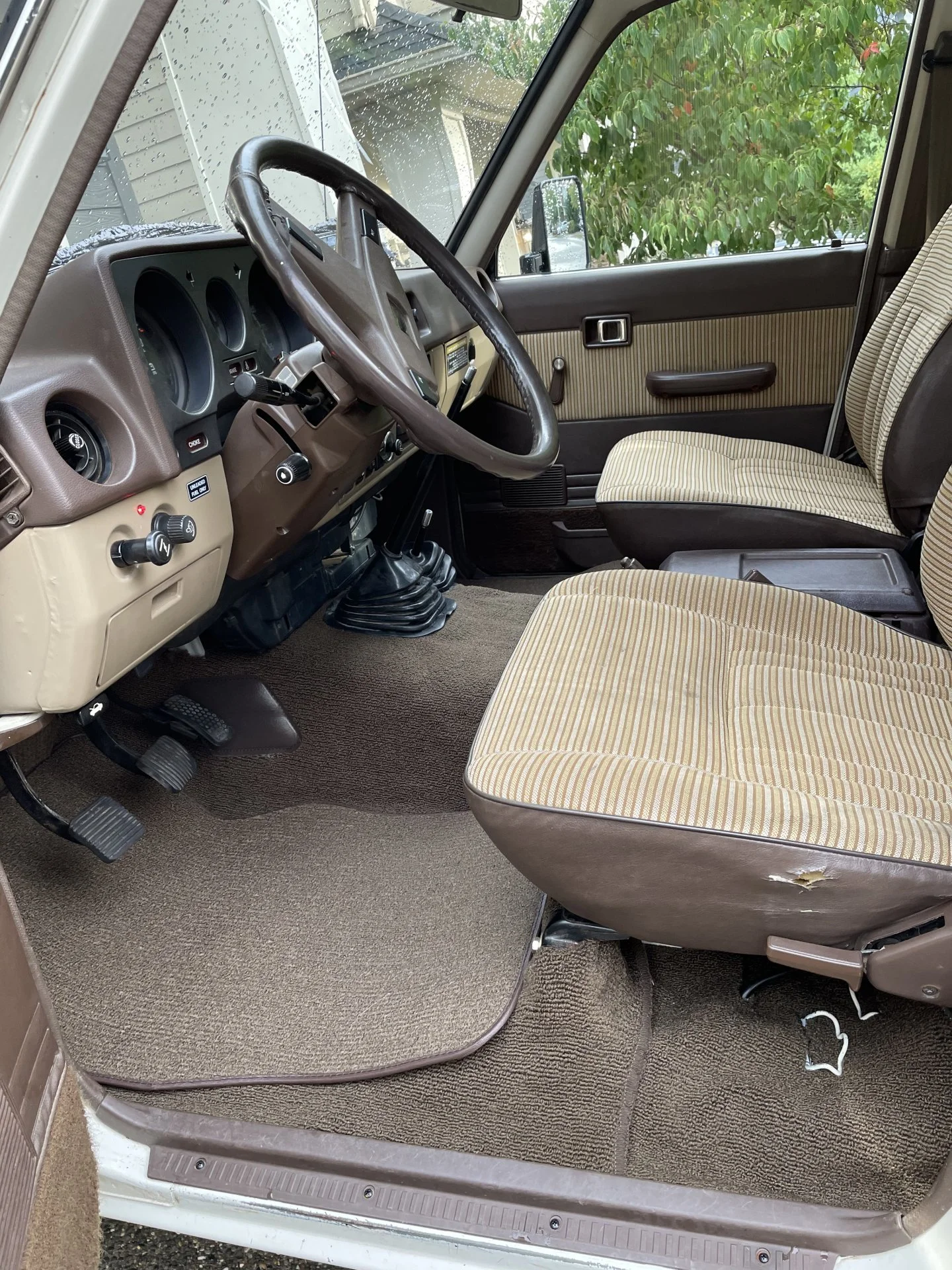

After
The only spot I can't seem to figure out is that little square toward the right hand side of that sill plate above. No matter what I couldn't seem to position the second row carpet so it would go away without affecting other areas in such a way that the carpet didn't fit. I'm hopeful the wheel well sections either cover it or I can use a scrap there.
It looks great and was super easy!

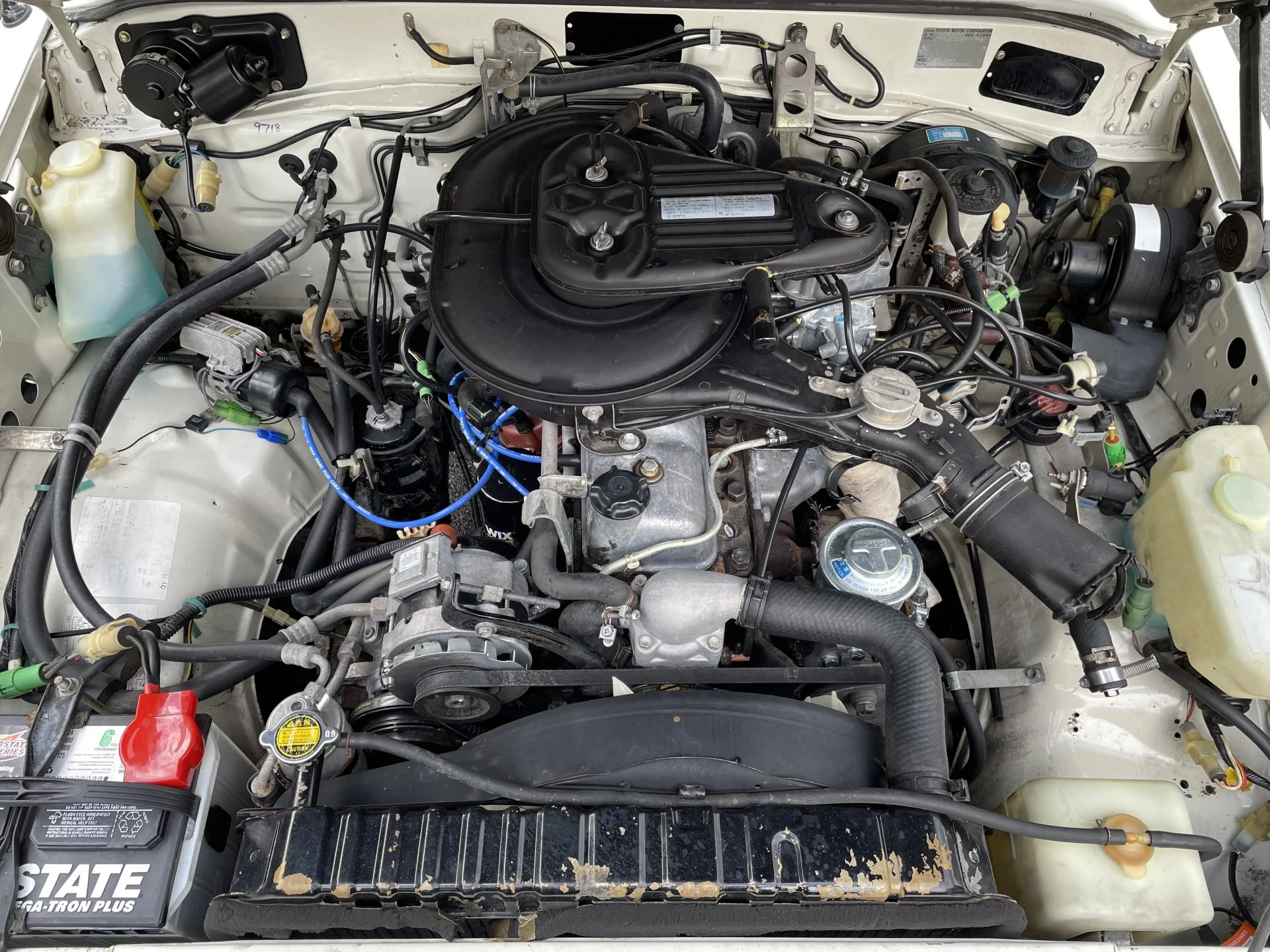

Desmog done. Used the plugs, caps, pulley and block off plate from TLC Performance. PM me if you want what came off including a very new air pump.
Doing this got rid of about 3 small exhaust leaks. When I get the exhaust replaced I’ll remove the pipe that runs up the driver’s fender to the air pump, until then its hillbilly AF.
I also replaced the upper T-stat housing with the new one.

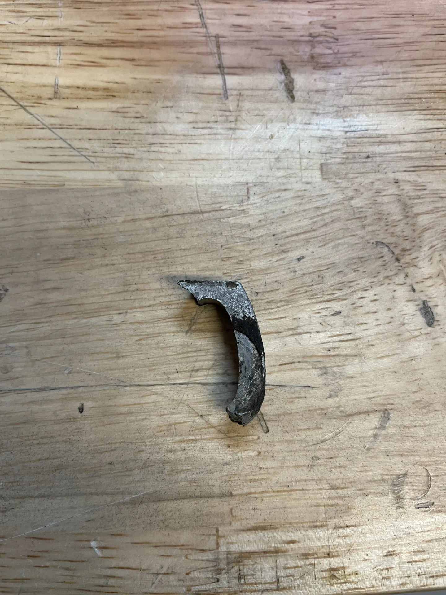

I went to adjust the timing only to find the slot that the distributor bolt hold down goes through was broken by someone along the way. I was still able to adjust it and put the chunk of slot back in when snugging it down. With both vac lines disconnected at roughly 750rpm it had 18 degrees of timing. I took it down to 10 degrees.... it still diesels when shut down warm. I'm hoping the carb may fix
Here’s the chunk…
