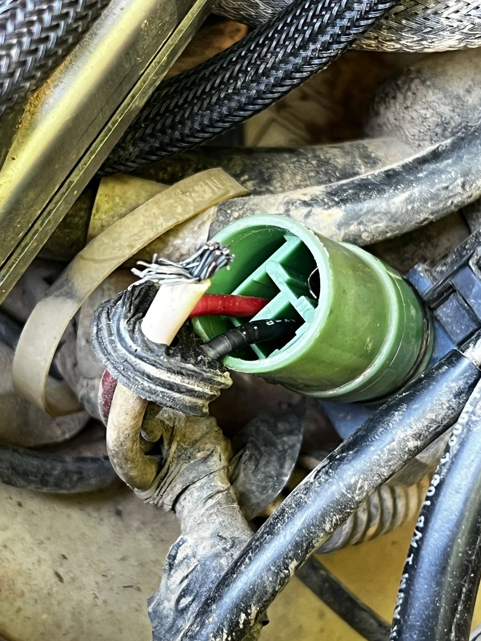

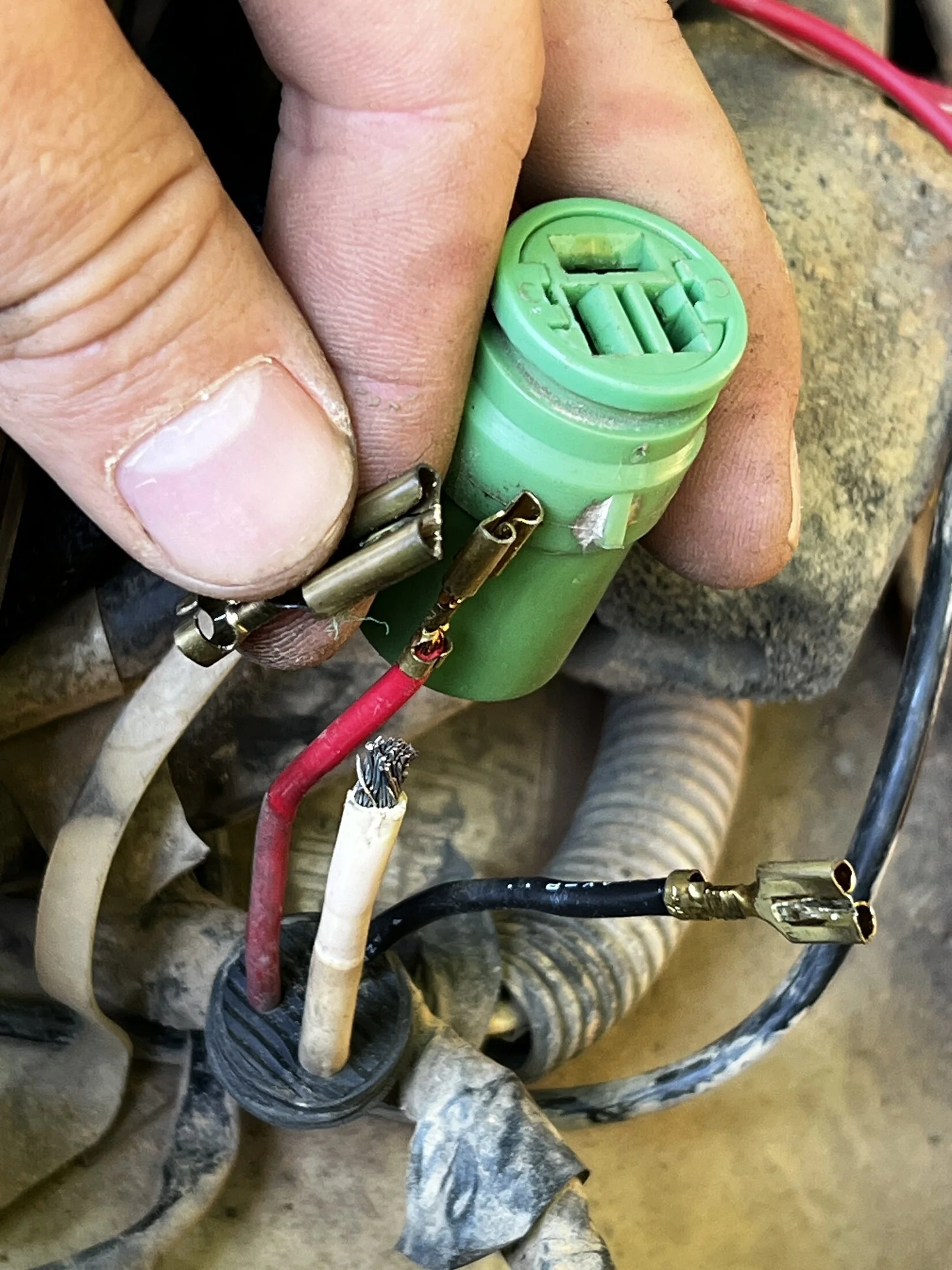

I’d say start with the condition of the fusible link and work from there.
For reference, I had a wire pull out of a connector on my fusible link but made intermittent contact causing a random no start/no power to a lot of components (lights, radio, etc) and shutting off to occur. Redid the wire and connection and went ahead and replaced the fusible link since I had some spares and all fixed. Jiggling the fusible link and associated wiring around caused the dash to light up and turn off which is how I located it. Once, I opened it up, it was clear it had been arcing.
