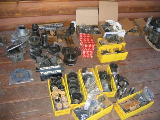

Thank you !!! You the Man !! and wow ! you got some extra parts !!

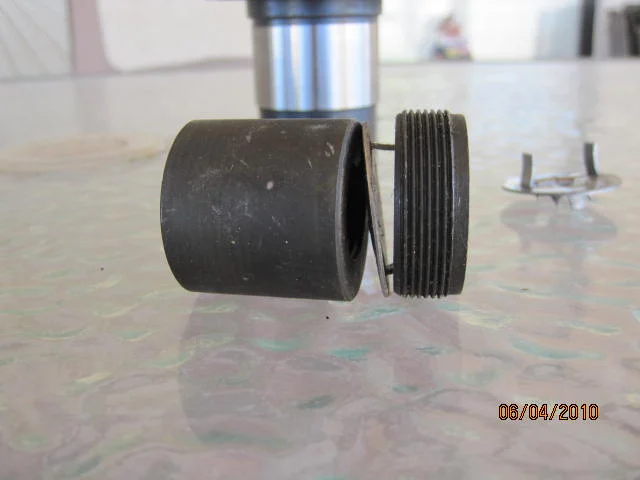

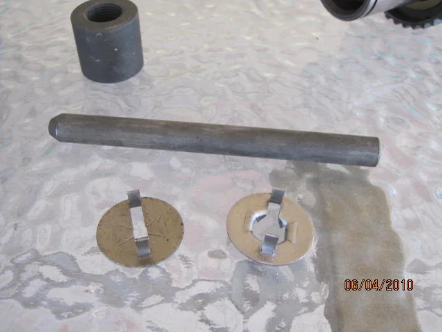

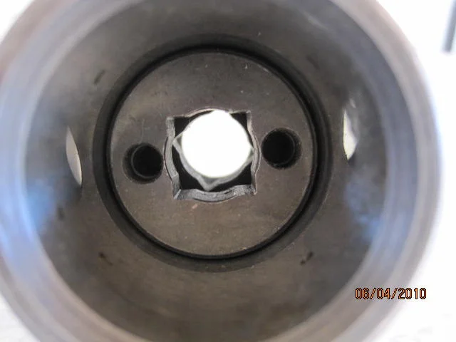

Here is a few pictures of how it looks. The three parts in the first picture are what needs to come out. The second pictures shows how it should look. The third picture shows the threads inside.

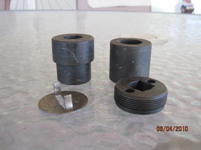

First picture shows a used and unused lock. This is the reason you are going to have to use force to remove the first one threaded collar. An impact will help. The second picture shows the two differnet collars that screw on the back of the tailshaft. The one with a step down works on the four speed. The last picture is the piece with the gears on it. This piece and the spacer that fits infront front of it on the tailshaft are diffrent between the four and three speed. The drive gear for the transfer case is different between the two also. Most the other parts are the same. I plan to use one to put a three speed transfer case on to a H41 I have. The biggest advantage is the spline piece in the overdrive rides in a differnt spot on the tailshaft which helps me. I got the transmission cheap but the tailshaft is pretty worn.:cheers:

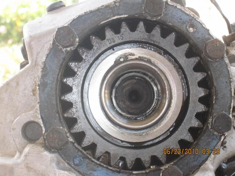

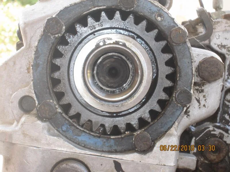

I"M back from Rubithon ( 5 days of cruiserheads ) looked at back of overdrive ? 3/8 ratchet extension will not fit in that hole ????? I guess I am a dummy ??? I just do-not get it ?? do I bash that hole with a 1/2 rod and make that hole bigger ?? can you come over to my house and HELP ?? These are new pics ,and has been cleaned ???

I am beginning to think someone did a home repair. Like they were missing the correct parts and hammered some other collar on there to hold it in place. It does look like someone hammered on that outer round piece right? Is that center piece the tailshaft of the transmission? If so can you take a long punch and see if you can drive it out. I guess at this point you could remove the two bolts and four nuts that hold the overdrive onto the back of he transfer case. But I don't think that will help anything. Once you remove the five bolts that hold the transfer case onto the transmission the only thing left is the tailshaft. If your remove the snap ring on the back make sure you don't lose any of the small parts are the collar that shifts in and out of overdrive. Looking thru my parts I have more four speed parts than three speed. Not sure if I have a that piece that in the last picture in post # nine. The other pieces I should have. The one that threads on to the tailshaft, the special lock and the one the threads on behind that. Infront of that is a collar with two cage needle bearings. I have those also for a three and four speed.

I GOT IT !! somebody put that treaded lock slug on backwards !!! #%#% It pulled right out ?? after that I got tranny off ! I cannot thank you enough! You are the overdrive man ! Thanks you & I8mud , Also I may need some parts ? I"ll PM ya ?
