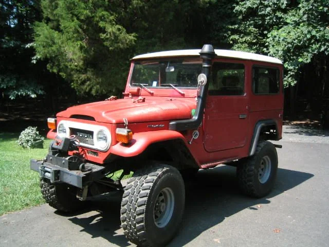

Here is a pic of my 40 with a safari and a OEM hat.
https://forum.ih8mud.com/attachment.php?attachmentid=87995&stc=1&d=1155423310
Great looking 40. I have wanted to put a snorkel on my 42 series, but I really want to put the snorkel on the passenger side, it works better with the 3B, but I don't think anyone sells one that fits on the passenger side (US/Canadian spec passenger side that is).

Entaran said:
I use my safari for water fording. Works wonders.
I agree if you have to have water tight and want as easy a possible to get it safari is a better route. In looking at the factory snorkel with a little effort it can be very water tight.

i know if i had a high end unit that wanted a snorkel it wouldbe the factory setup but for actuall off roading i would go with the safari. the 2 piece part and the cyclonic air intake just doesn't sit well with me for the tight trails around here.
factory still looks the best though in my books...
