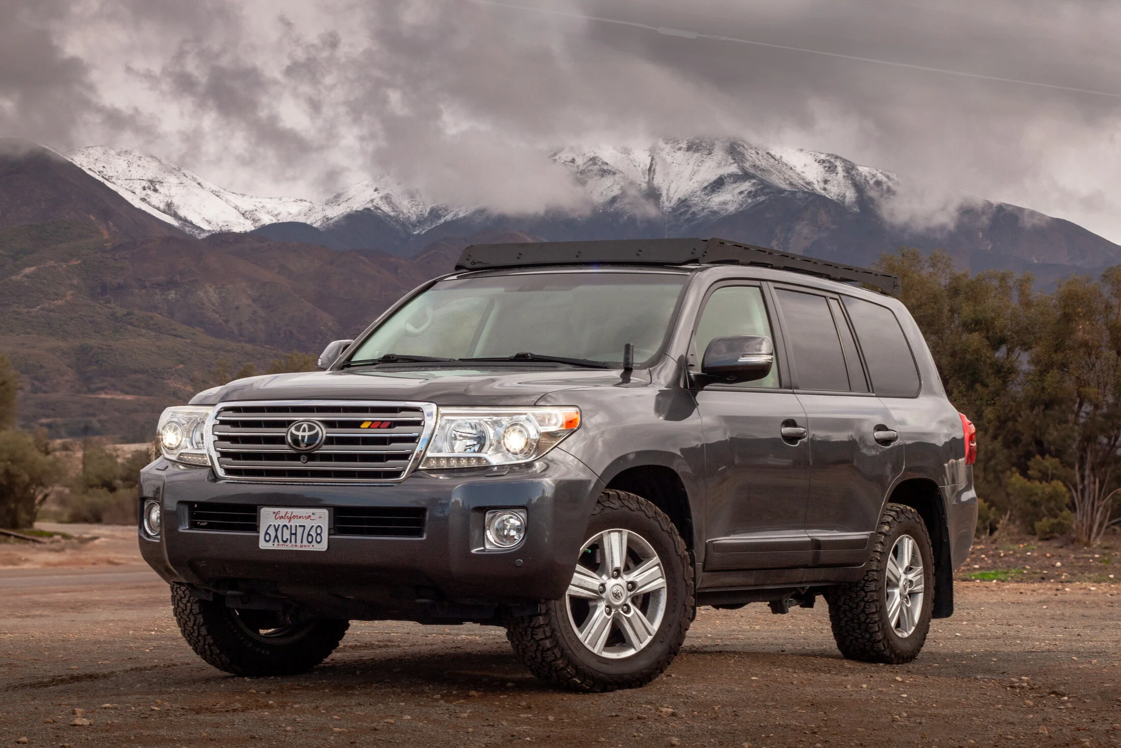

Has anyone found a good fog light to replace the factory lights on a 2014 LC 200. It has the round ones. Need an amber light that is ideally plug-n-play. Similar to Bajas, Morimotos, KCs, or Heretics. Not looking for just a bulb replacement.
