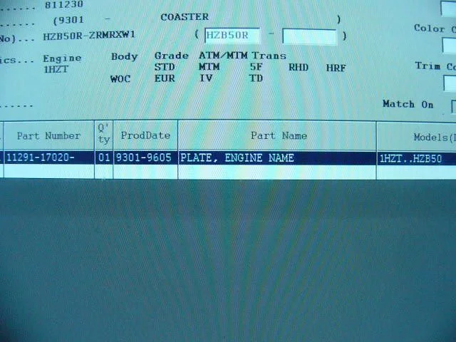

Caetano Optimo III from portugal
Toydiy.com
1993 TOYOTA COASTER (HZB50R-ZRMRXW1)
my cars ▼
STD EUR RHD HRF 1HZT TD MTM5 FIVWOC or LHD
17201TURBOCHARGER SUB-ASSY
17201-170201€ 4,215.17

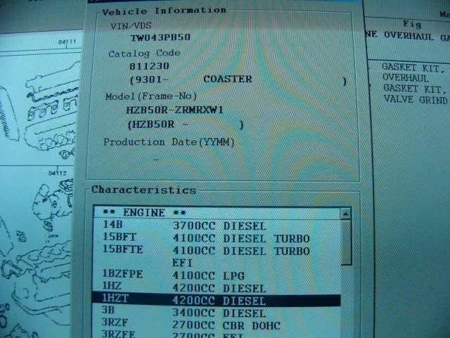

Would like to know why these can show up with 4300cc opposed to 4200cc
Need to search as incomplete vehicles
