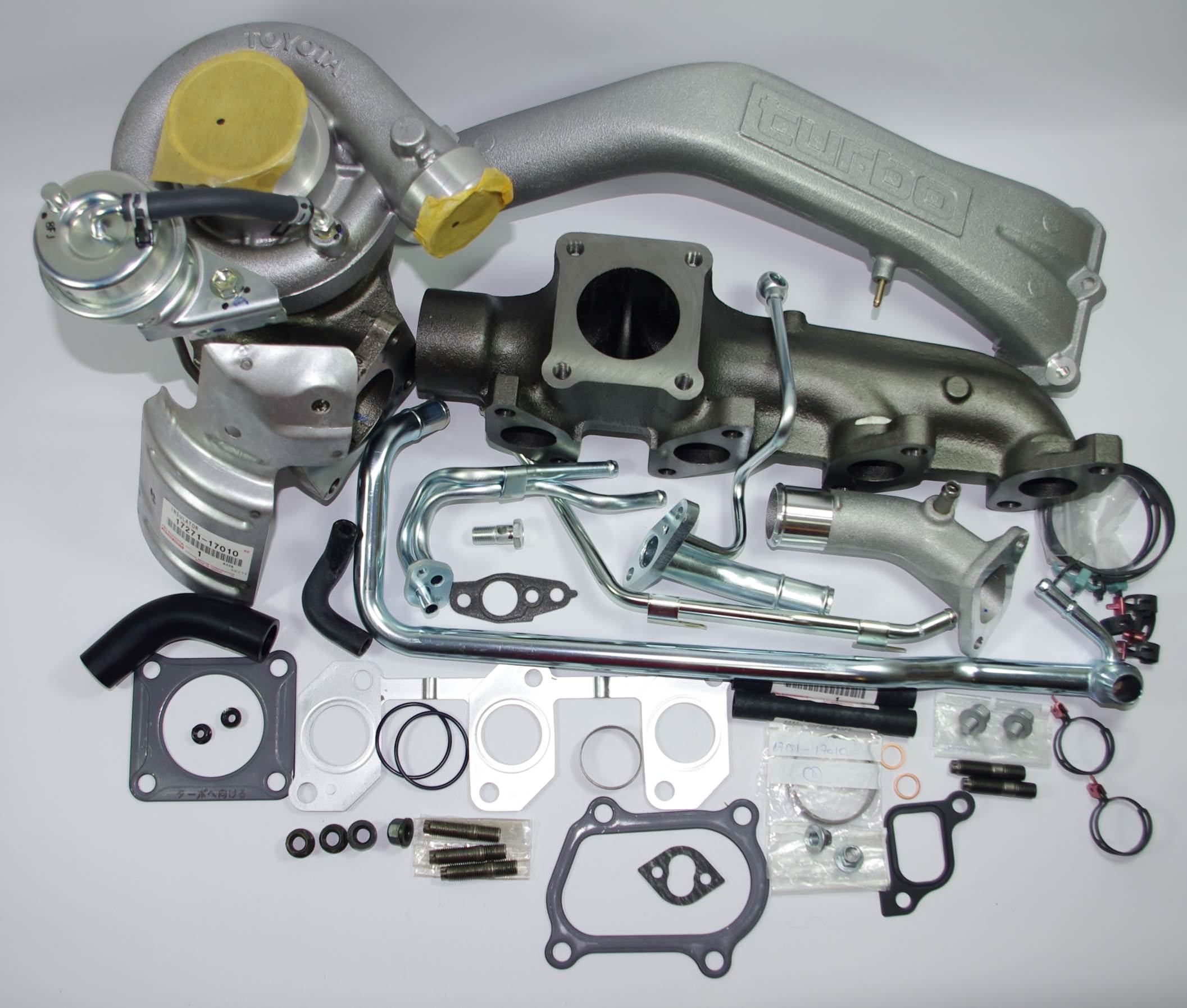

I imagine that was the one about to be shipped to me. You have my permission to photograph and give it a good look over if Yan still has it, doesn't mind and hasn't wrapped it for shipping. I think it was going to be posted in the next day or two.
Yeah I don't doubt it's extremely similar if not identical albeit for some minor difference that gives the assembly a different part number. All I care about is showing Toyota here that its an OEM turbo designed for the 1HZ, so they will then accept to do my engine rebuild with a Toyota backed warranty.
this is what Yan sent me, I assume he doesn't mind me posting it.
from what i had checked before, the manifold, oil/water pipes and turbo gasket kit are all exactly the same as the 90-92 1HD-T coasters produced up until they were replaced by the 1HZ-T and as the 90-94 HDJ80's and in some cases other HDJ100's, so I imagine any difference would only be internally or maybe the wastegate setting, time will tell.
I'll be removing my intercooler and setting pump to standard 1HZ-T settings on install to dyno (although I will have 3" straight through exhaust to start with), and then add/dyno the improvements stage by stage to measure the benefits, but it will take me a while to get through the rebuild stage, so if I'm the only owner of one of these so far don't hold your breath!
Well I have received the 1HZ-T's turbo, I'm not going to open her up as I need it " as received from factory" so I get a guarantee on the up coming rebuild by Toyota, but if anyone thinks they can identify some of its characteristics from external photos I'm happy to snap and post them. Otherwise it will remain a mystery until I get her running and on a dyno... in March.
