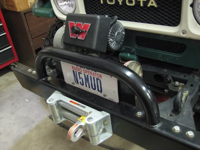

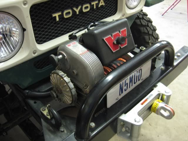

I use an aluminum thimble on the end of this winch line, it just snugs up tight against the hawse. Easy to rig for recovery. Works well for me.

What i replaced my hook with.

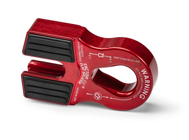

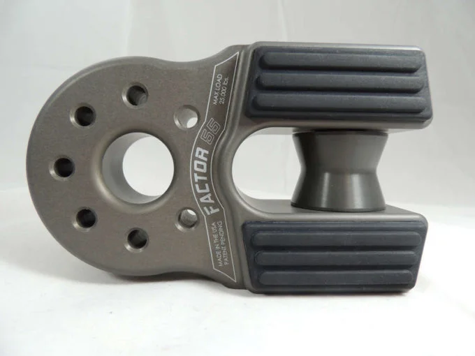

Like @gnob above, the Factor 55 Flat Splicer is a really nice termination.
Allows you to draw the end up flat to the fairlead / bumper for stowage, with nothing sticking out to get hung up when wheeling, and no outside winch line exposure at all. Completely hidden.
Nice and neat. Would be my choice.

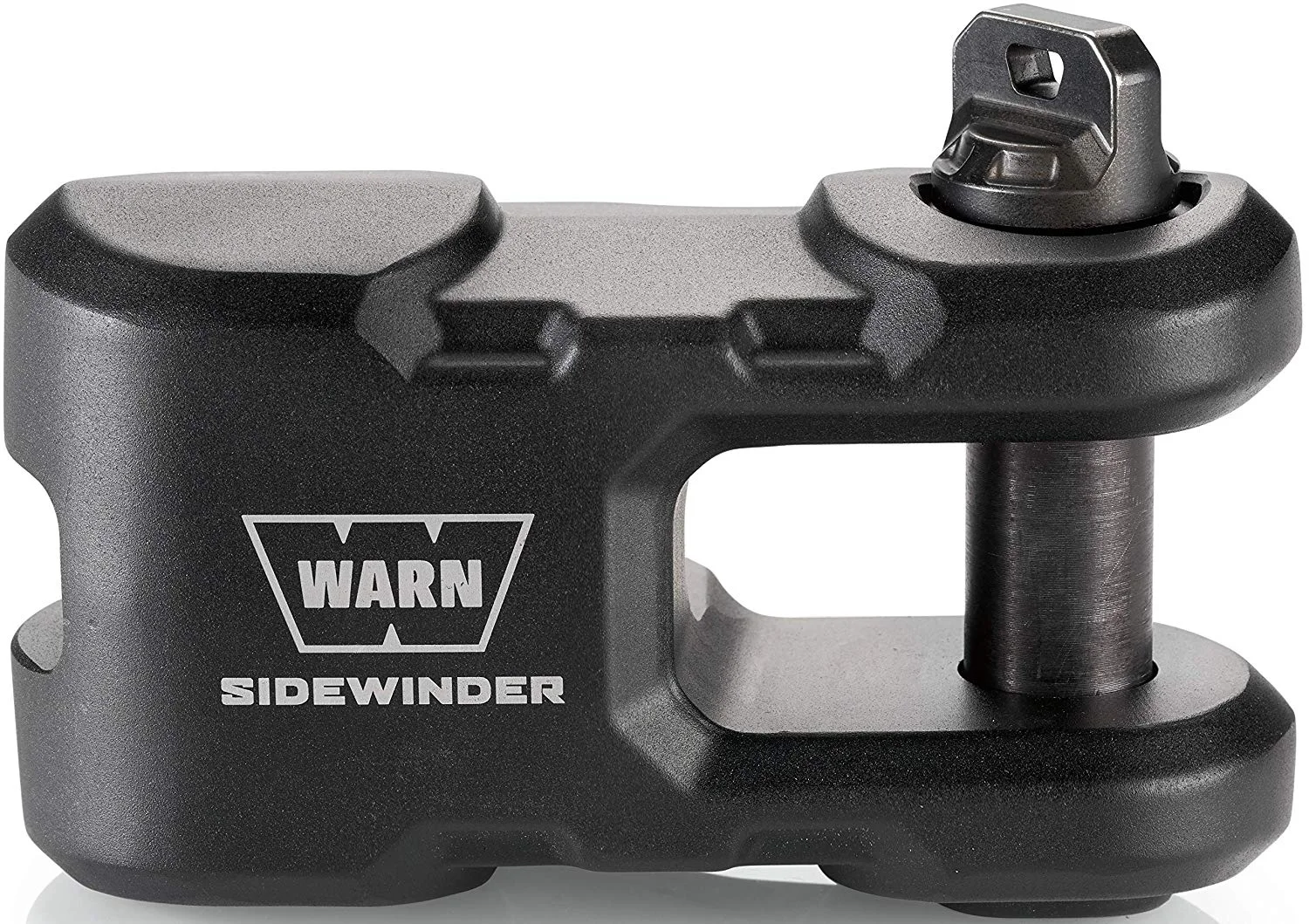

I went with the side winder as it shield the line; the thimble also shields well. Factor 55 is currently redesigning and/or adding an idolater to protect the exposed loop is what they told me.
The sidewinder has the down side of not offering a replacement pin at this time; so I'll need to see if I can find a bolt that fits for plan "b" if the pin gets lost.

Factor 55 makes guards for the rope end. A tubular thimble would also be a solution.
