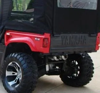

I have the same issue with my Rhino, dual exhaust, it doesn't matter how slow or fast I'm going I get a lung full of crap even when the top canvas is on. I also installed two turn down elbows, not shown here, for the exhaust and no change.
