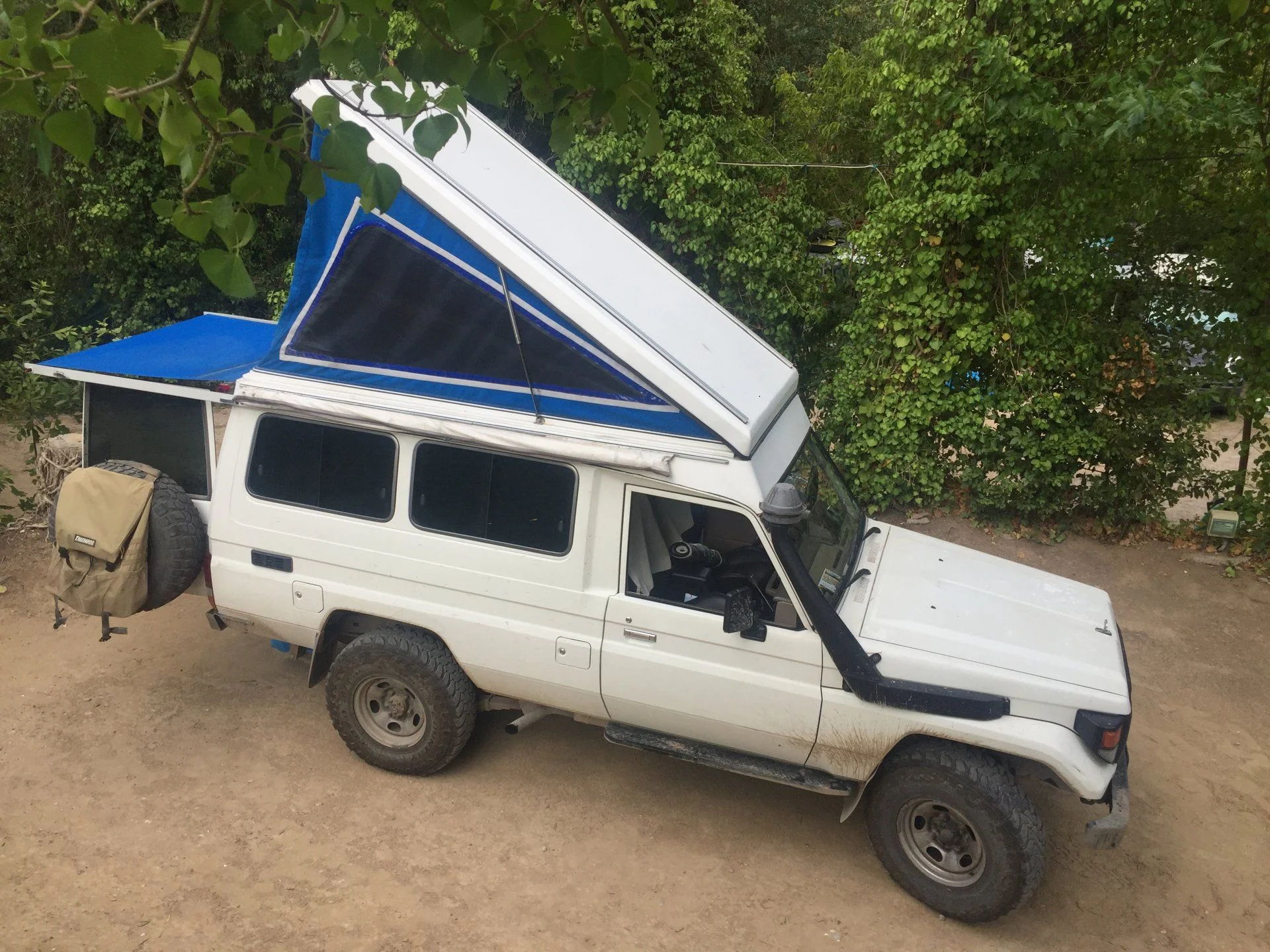

I have a Toyota 78 , with a HD-T motor , km 350 K , the motor is getting a bit tired , maybe its the turbo ?
I am thing ahead , in case the situation will get expensive .
is it worth to dump the old diesel motor , keep the drive train am switch for a electric power train ?
eventually Hybrid ?
maybe keeping a small generatore to pump up the range .
or we are just at the beginning of the electric revolution , too early ?
any comments will be appreciated
this is my car at present
