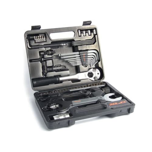

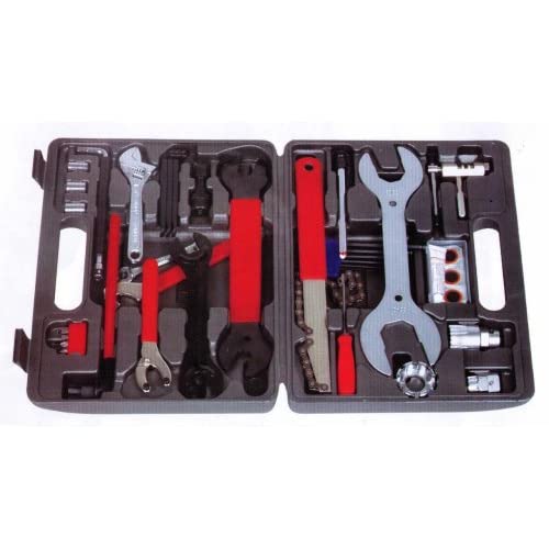

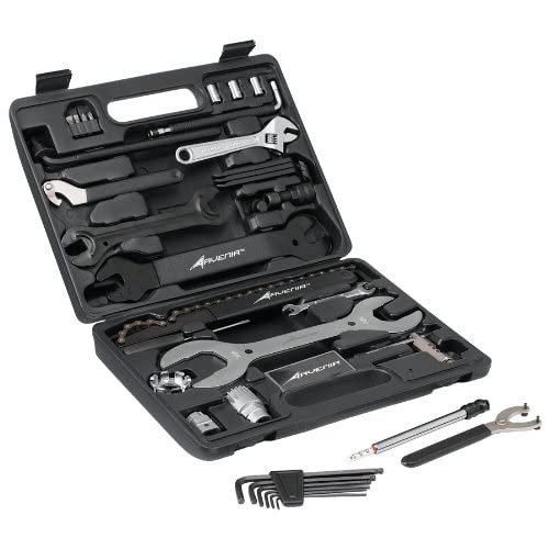

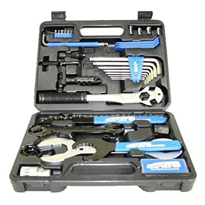

i am a newby to working on mtbs. i trying to figure out what stuff to get to maintain my bike. i have spent time looking and there doesn't seem to be a good intro "kit" that has what i need without duplicating a bunch of stuff in my vehicle tool kit (i have plenty of wrenches/sockets/hex drivers/torx drivers/screwdrivers). so i am thinking i may have to go ala carte.
for tool kits this is about $250 and seems like overkill, but i can't see anything cheaper that looks to have decent quality and cover the waterfront:

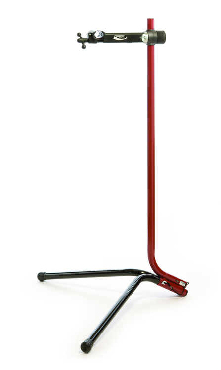

bike stand

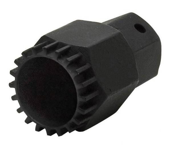

bottom bracket tool
PARK TOOL BBT-22 BOTTOM BRACKET TOOL at JensonUSA.com

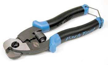

cable cutter

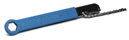

chain whip

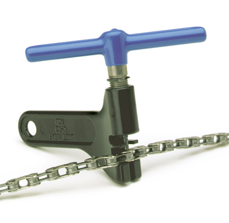

chain tool

Don't buy one of those "all in one" kits unless you have nothing to start with.
All those tools listed look great. I would add that instead of an allen multi tool buy a good set of individuals for home repair. Park again has a really nice set. I would also add in a really nice chain cleaning tool. I have a Pedro's and I like it better than the Park it replaced.

As with any repairs take your time and enjoy. One area to be extra careful is the bottom bracket. This can be easily stripped and or cross threaded during repairs. I would also recommend the "Zen: Art of MTN bike Maint" book. I saw them at Costco here in Portland last Christmas.

I know us landcruiser wrenchers like good tools but i must say for the price, i have been happy with the spin doctor set (at performancebike.com). There big toolkit has the same tools as the monster parktools kit at 1/3 the price. The best part about the performancebike toolkit is the 100% satisfaction guarantee which means lifetime warranty. Yes i've had tools break (but i wrenched on a ton of bikes over the past many years) and they continue to send me new tools to my house no questions asked and no need to even return the broken tool. That customer service that is tough to beat. And if you are worried that the tools are made overseas, just read the backs of the other tool manufacturers (ie. pedros).

I can't tell with the bike stand but you should spend the money to get a clamp that raises and lowers and rotates.

Don't get an expensive tool set. A lot of tools included are for old bikes (eg. Cone wrenches are for adjusting preload for old style wheel hub bearing, although I found them very useful as generic tools in the garage). Today's bike are much simpler, 4,5,6mm allen (hex) wrench is pretty much all you need throughout the bikes. In addition, you might need special wrench for bottom bracket, cassette. (due to lack of standard, you will have to get those fit your bikes, but throughout time you will accumulate enough for a bike shop:cool:). A chain tool is also a must and if you don't have thin profile open wrench (15mm), you might also need a pedal wrench.
A good quality small set might be a good starting point, you can add more as needed.
As of the stand, you can try to build one your own as there are plenty of good plans on the web. Or keep an eye on the craigslist, I got mine professional Park PRS-2 for a very good price (pictured below).

Does that Spin Doctor kit have the tools to service the newer bottom brackets? I have a bunch of old Park tools, but don't have the right stuff for that Race Face crankset I bought from you. I think I need to update my bike tools.
My favorite bike tool is my Shimano cable cutter. Made in Japan and cuts like new (14 years old).
