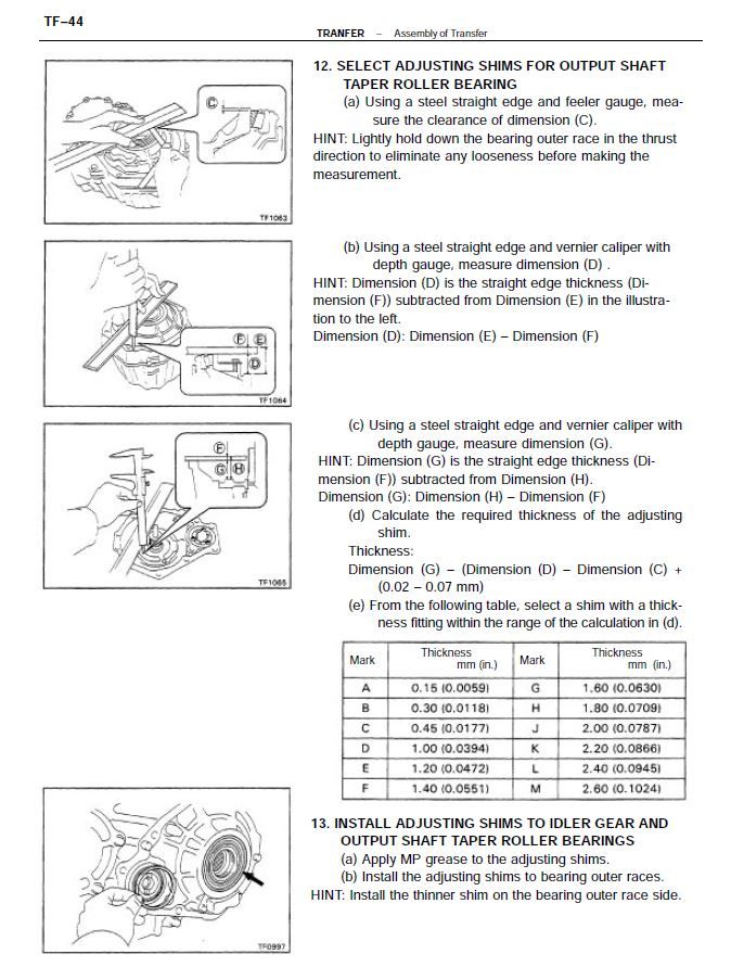

Measuring the size for the rear output bearing shims I noticed what believe to be an error. In step d it says to subtract measurement d from d. Which would equal 0. I believe what it intended to say is subtract c from d. Anyone ever noticed this? Or let me know if I'm wrong.
Bound to be a mistake...
Spending 3 decades working as a dealer tech, I can tell you one thing, not uncommon. We would get service manual update bulletins every now and then. If we would find one or when the bulletin came out, we would mark the manual with the correction. When the electronic versions came out, they would update the software pretty regularly. When it came to our certification testing, most of it was looking up specs and procedures. They would purposely target the errors. You had to verify everything.
