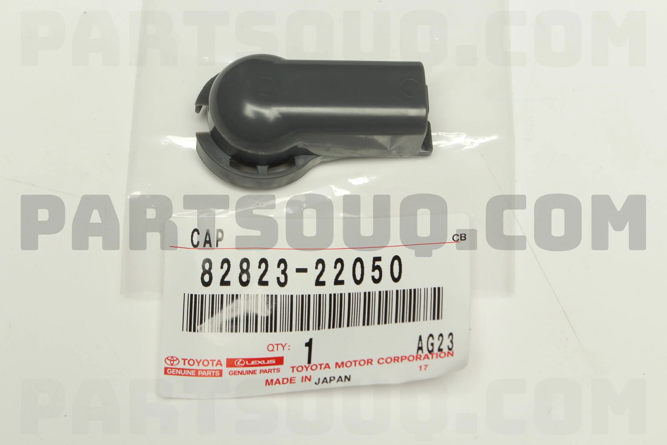

Boot, not properly tucked in
Above pic we see the protective cap is on hot lead.
