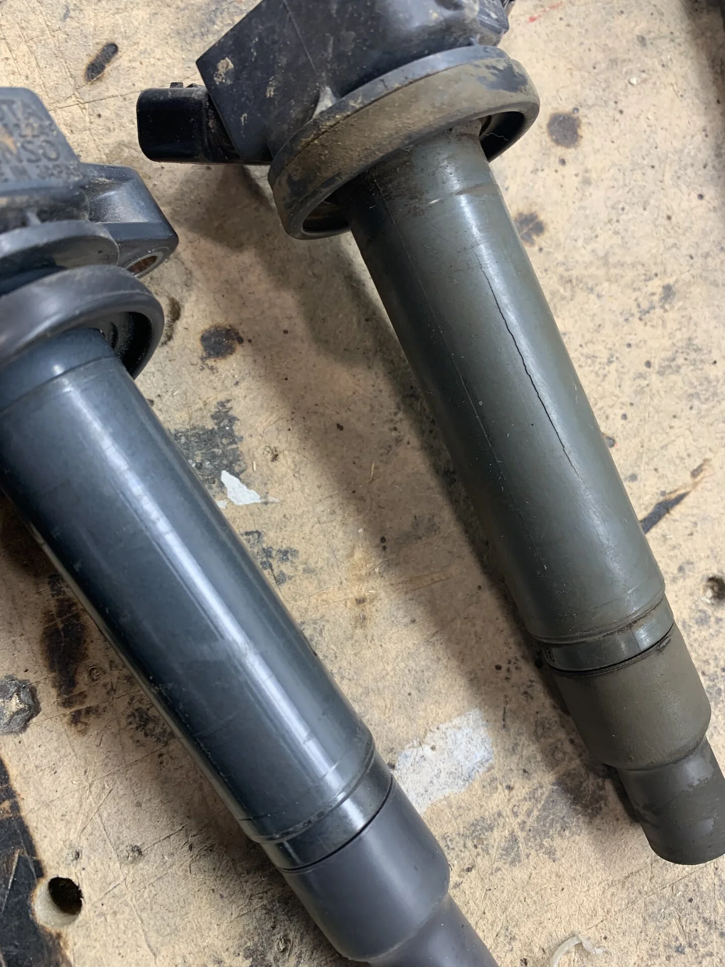

This weekend I replaced spark plugs. Two on the right bank came out with very little pressure. On the left bank, one of the coils was filthy. I pulled it and the spark plug was barely in there. There was also a crack running the length of the coil, probably from high pressure blowing past the plug.
Thanks to @2001LC for the post about plugs backing out. Great info.
Replaced all plugs with Denso Iridium TT and got a Toyota Denso coil from the local dealer. While I was in there, I cleaned the MAF Sensor and Throttle body. Both were in good shape.

Above are two coils. Left is what most of them looked like. The right is after wiping it down, note the longitudinal crack in the middle.
I had this exact same issue, and also did the job after seeing 2001LC's post about it being common.
