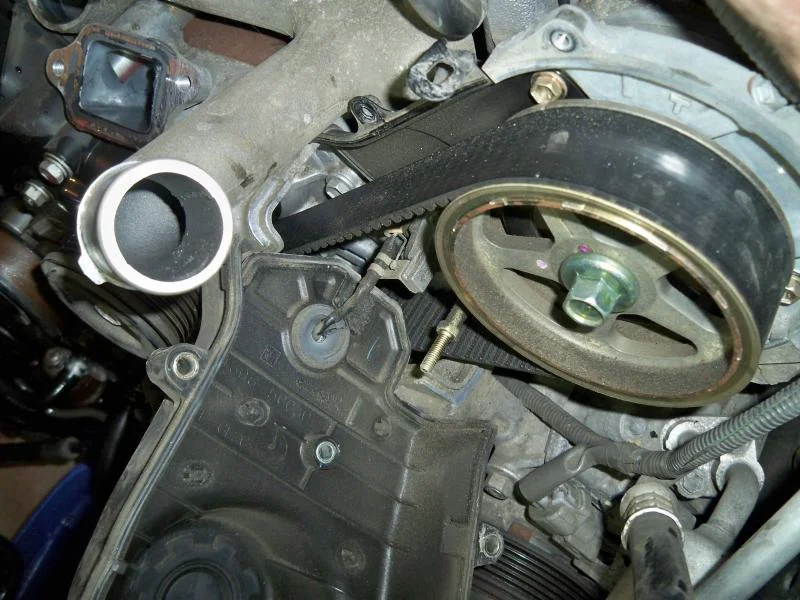

For others, this is the wiring we're talking about:
https://forum.ih8mud.com/100-series-cruisers/431177-timing-belt-dummies-writeup.html
attachment.php
Must have run wire around edge of cover instead of through hole, I suppose.
