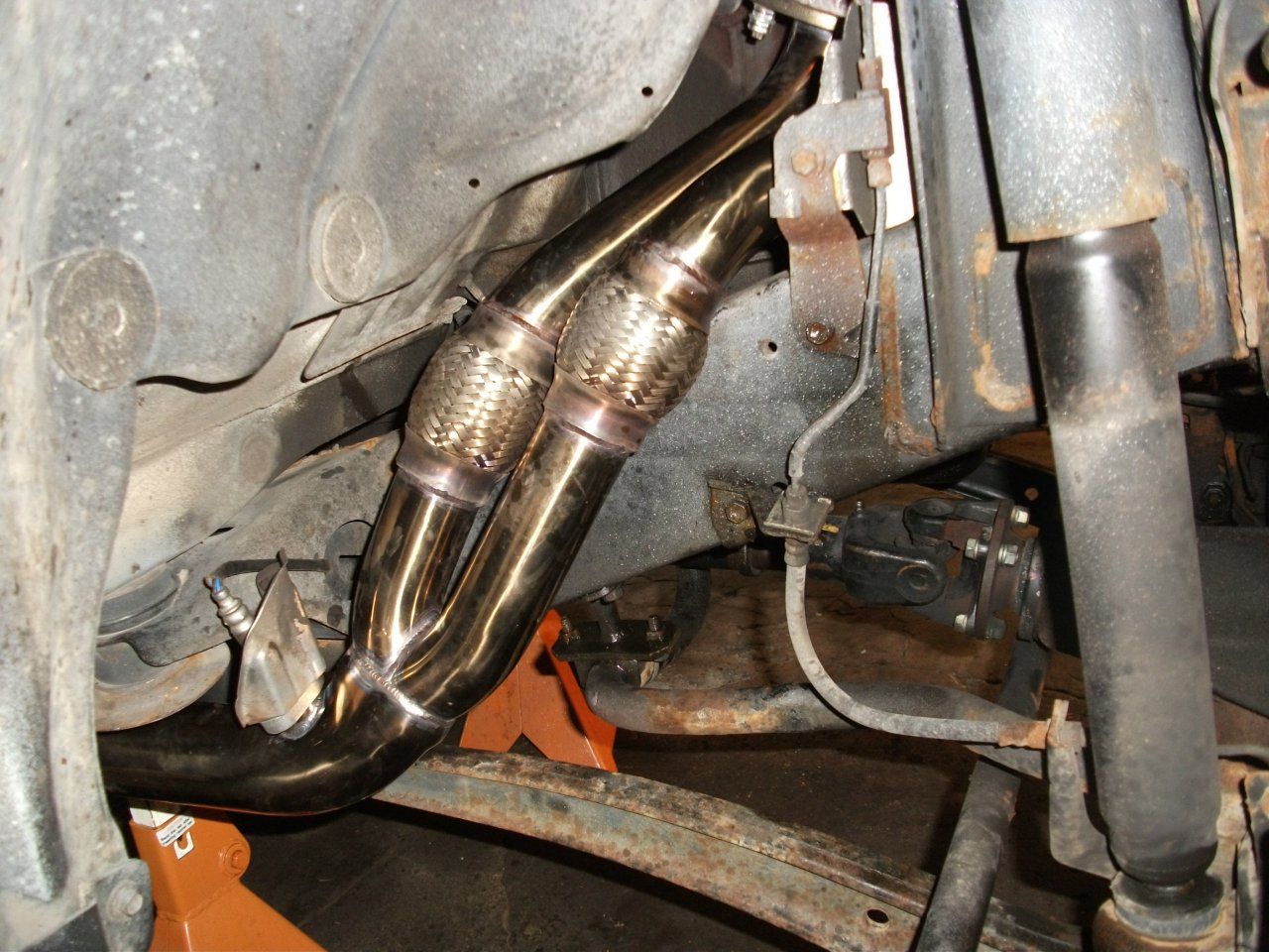

Let me start off by saying that I was very impressed by the quality of this exhaust at first. I put it on and then things started to go wrong... there was always a rattle around 1750 rpm and shortly after I put it on the metal on the flex connector began to come off. It wasn't until a few months ago that I noticed that the rear axle had hit the exhaust pipe and put a dent in it. Shortly after that I heard a rattling coming from the exhaust bracket near the cat... I tried to bring it to the local Toyota dealership to have them fix the bracket and the flex connector and they tried to sell me a brand new exhaust system. I original spent the 1350$ on the ems exhaust because I thought it was going to last the "lifetime of my cruiser" and I figured that was a better investment the few hundred dollars that my factory exhaust needed to be fixed. Has any else had issues like this?? How good is ems about covering their lifetime warranty?
How old is that exhaust? It doesn't appear to be the current version the flex section definitely looks different.
Of course the dealership tried to sell you a new OEM exhaust that is how they make their living. The brackets that broke would simply needed to be rewelded. Just find a welder than can do stainless. (but that exhaust doesn't even appear to be stainless?)
Can't be stainless. Must be an early version...
Exhaust shop and 15 minutes will fix you... They can also probably make a few adjustments to take out any areas that might have sagged are are now rattling.

Yes it is the 304 stainless. hence the 1350$ shipped. I got it a little more than a year ago... last august.
You won't know until you call them. Taking any exhaust issues to a dealer is a mistake, especially with an aftermarket, non-EPA approved system. Their only answer has to be, "buy a new, factory exhaust system".
A good exhaust shop can set you straight quickly, but you may chat with EMS first. Broken pipes, rattles, etc can also mean a bad install job.

Did you sneak into my shop and take a picture of my EMS exhaust? Mine looks just like that after 1 Ohio winter. My mesh at the flex pipe is about gone and what is left looks identical to the one on the right. New I could have shaved using it...

This is mine after less than a year. I tried multiple times to get EMS to take care of it. I even filed a complaint with the BBB. They couldn't get a response either. Now I'm replacing the whole exhaust again. Absolutely ridiculous! Do not buy this exhaust!

No all the exhausts were built in 1 or 2 factories. There were very few custom exhausts built in house. I know the guy who fabbed the original exhausts and then they would be sent out to be duplicated. Parts were cheapened and it looks like steel was also cheapened. They were all specced as stainless so looks like the outsourcing might end up hosing all of us.
I was pulling the exhaust off today to replace it. The flex joints were so weak I just gave the pipe a little tug and they both pulled apart. That is exactly what I was afraid would happen driving down the road. Complete garbage.
Yeah the rust conditions where you are look terrible. I can't believe that is 1 year. I am really surprised any exhaust survives. Sorry to see that the stainless ended up being s***. I guess I will have to keep an eye on mine, but last time I looked mine was still shiny after a year. What does a normal steel exhaust look like up there??
