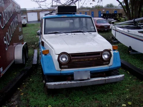

I hope you will allow my entry into your rare space, I'm the owner of a 40 but have always had an attraction to the FJ55's so imagine my reaction when a neighbor down the street told me that he had a Land Cruiser older than mine but it was a wagon. That conversation occurred a couple of years ago and my attempts to have him show me the truck went nowhere. Then a few weeks ago I had a knock on the door and there was George telling me he wanted to show me Elsie. So on a cold rainy day, in minutes I was on my way to a storage yard to see a 72 one owner pig that had been parked for close to 10 years dying a slow death.
Here she was, a remarkably straight blue and white beast sitting in the weeds, an aftermarket AC bolted to the roof and dripping water into he cab, tires flat as pancakes.

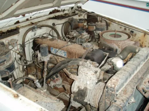

Under the hood was the unmolested F155 with less that 50,000 miles waiting to be brought back to life.
Weeks passed, Geaorge was willing to sell at one number and me wanting to buy but knowing that I didn't have space in the garage for a project like this. We finally agreed to we would return her to the roost and that I would help him get her road worthy with help from some of the WALCS members. Today was the day to get her home. We pulled the wheels off my 40, grabbed a bottle of brake fluid and rolled up to make the rescue. I will let the pics do the talking.

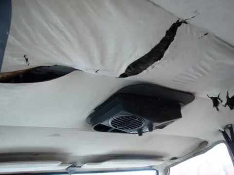

That AC unit is something else. It looks like a 5 ton house system that was adapted to a cruiser. Your gonna have a lot of fun with that project. It's a lot of work but worth it.

That AC unit is a kick! I bet Elsie get cold inside with that!

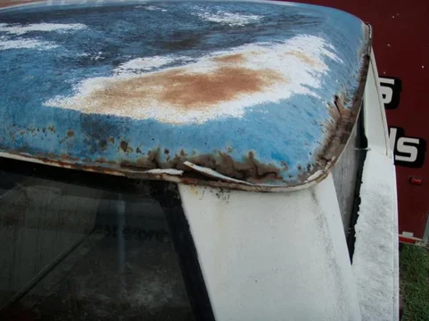

Couple of dents in the roof but the biggie is this DS rear corner, this is the only place where the skin has opened to the elements. Thinking of cutting my teeth with the MIG but may grab Riley from Colvin's around the corner for this since he did a great job on my 40 sill last summer. The holes from the AC will need to get filled as well.
Head liner is self explanatory, water logged from leaking I'm afraid of what lies beneath. Pulling up the mats the floors look pretty solid but we need to strip the interior to have a real good look.
Most everything under the hood looks doable but I haven't tried to see if the motor will turn yet, maybe this weekend.

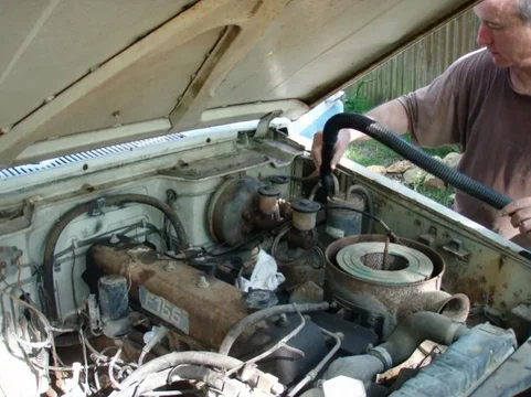

Was out front this afternoon and heard George with the shop vac, very unusual sound from that end of the street. Walked down to see what the trouble was and

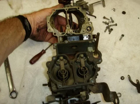

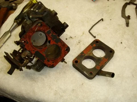

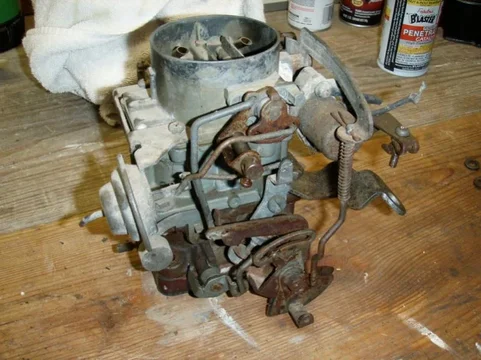

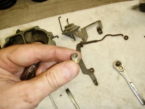

Found him under the hood cleaning years worth of bs. This of course turned into a minor wrench session on the spot. Still curious about the state of the motor so I pulled the crank from the rear seat and turned her over with effortless ease, smooth as silk. Knowing that a carb kit is days away I pulled the carb and started tearing it down for a bath.

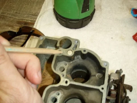

I have never been into a 72 (Jan 11, 1972 to be exact) so I will be looking for help. First up how can you tell the difference between the Venturi? On my 76 it was easy but when I pulled these off the two sides looked identical so I marked the primary with a sharpie for now
Second, I could not separate the insulator from the base of the carb. I did not go at it too hard because I didn't want to bugger up the insulator, suggestions? Need to get it off the get to the third screw holding the base to the bowl ( assuming there is one accessed from the bottom like the later years)

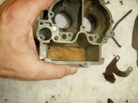

Carb is pretty much a mess, here is he issue list so far:
About 1/8 inch of grit in the bowl, fuel tank will need work
Weight in the pump exit circuit is stuck
Missing PV jet
Permatex everywhere
And finally no retainer clip holding pump inlet check-ball in place, going to have to see if I can find one of these or make one.
