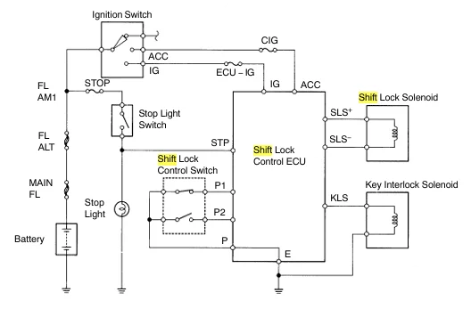

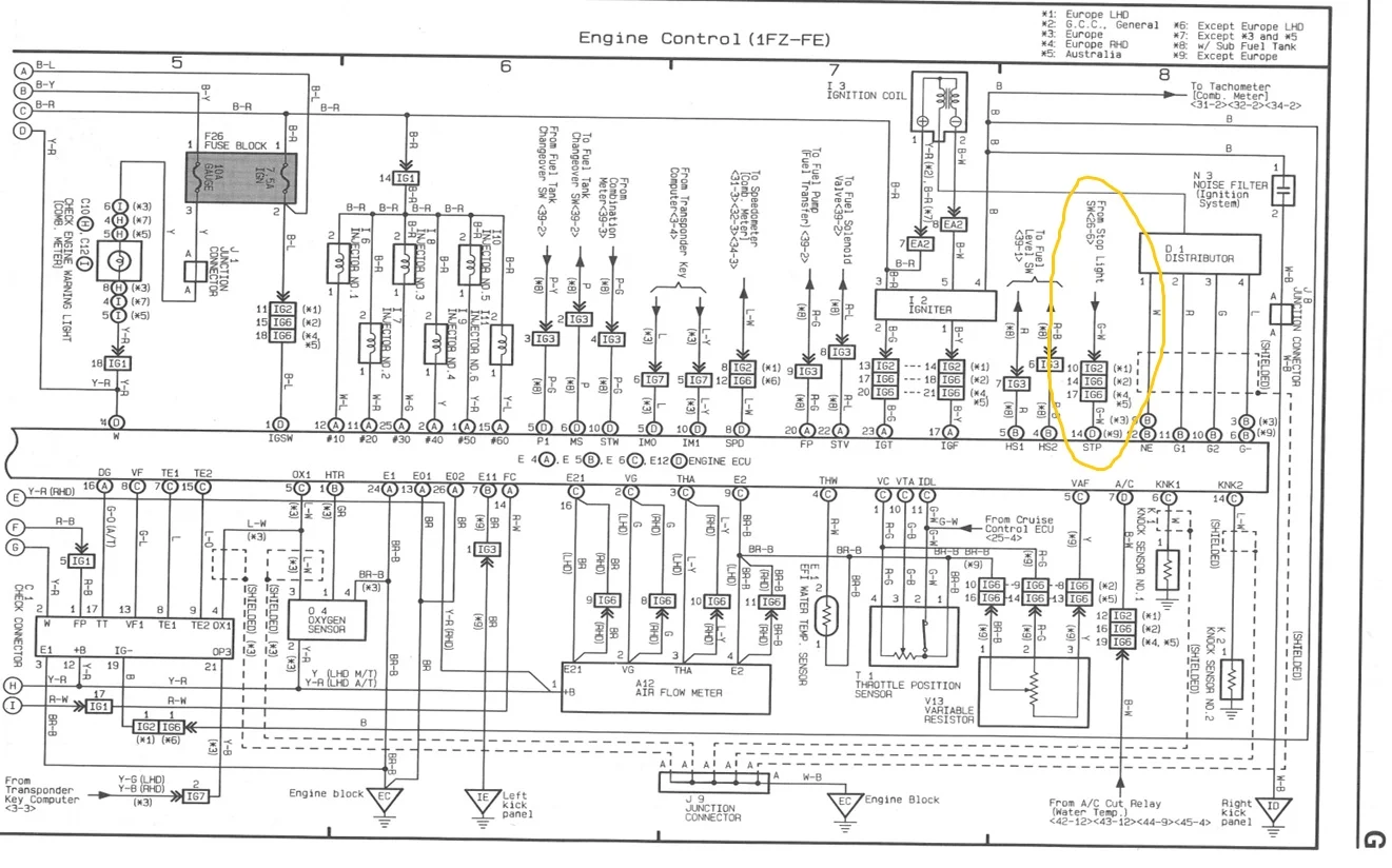

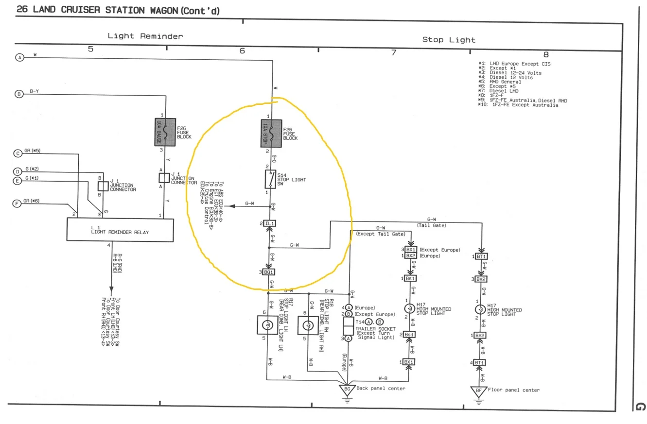

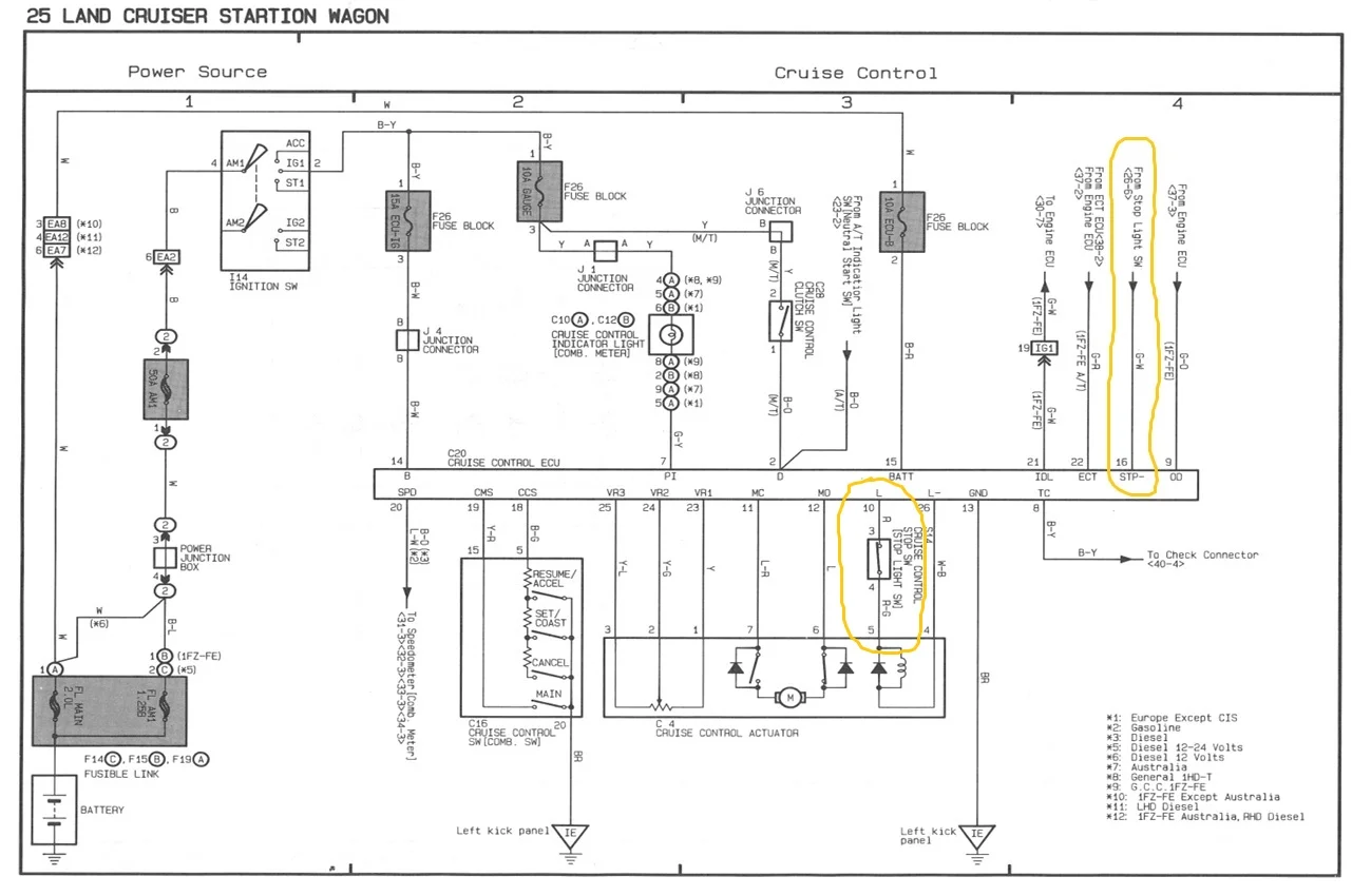

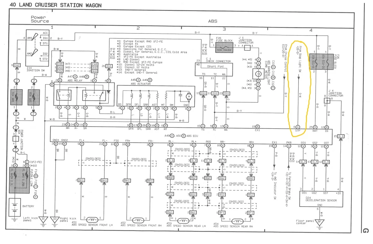

Pictures of the relevant diagrams, if anyone has anything that I missed here that could probably help too, but checked both the FSM, electrical supplement, and RS3000 manual. Based on the diagrams its the Green-White wire coming off the SL switch going to each of the above ECUs. The electrical supplement manual shows the first four ECUs above but doesn't show the Shift lock ECU at all, which is instead shown in the big main FSM, it is kind of odd that the diagram shown in the FSM only shows the connections to the shift lock control ECU and none of the other components in the supplement...

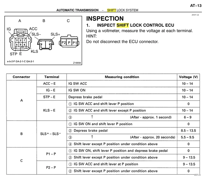

As you've discovered, the EWD is not the only source of info. The FSM actually provides test procedures for electrical items, such as the Shift Lock circuit found starting on page AT-12

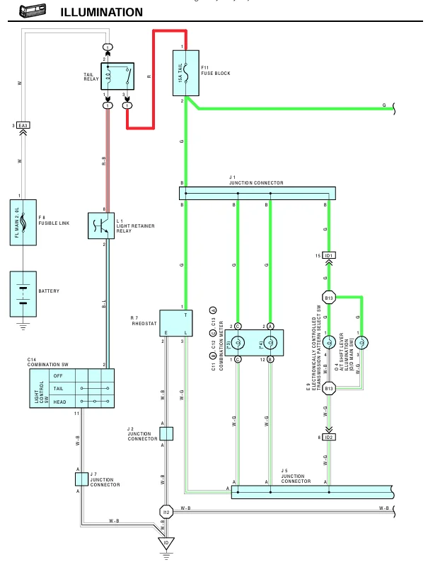

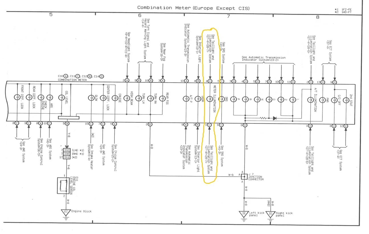

The combination meter backlight has NOTHING to do w/ any of the other circuits you mentioned. you have backlights everywhere else?

Yeah I suppose I should just run through the test procedures in the FSM…
Also what kind of manual is that with the wire colors in your last pic? Looks nice! Where might I find one?
And yes I do have all indicator lights working on the combination meter, except for the main illumination/backlight. Suppose I’ll just have to take a look at the bulb and rheostat.
That's the EWD. Look in the Resources section of this site. EWD and FSM are there.
I believe there are two bulbs. You might have something simple as a couple burned out bulbs. Rheostat also controls dimming of everything else (like the shift pattern, etc), so if everything ELSE dims, its not the issue. Does your 'D' light work? that's the one that usually doesn't :D
Yeah all shifter position indicators and warning lights work. Just not the backlight that illuminates the speedo and other dials.

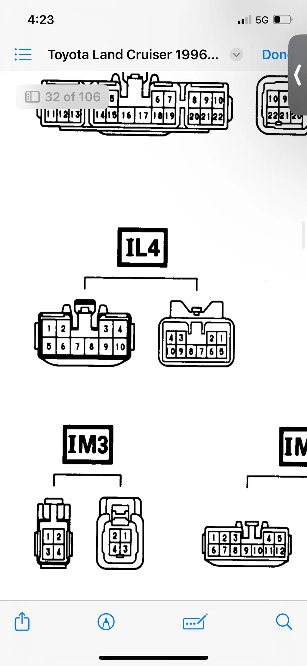

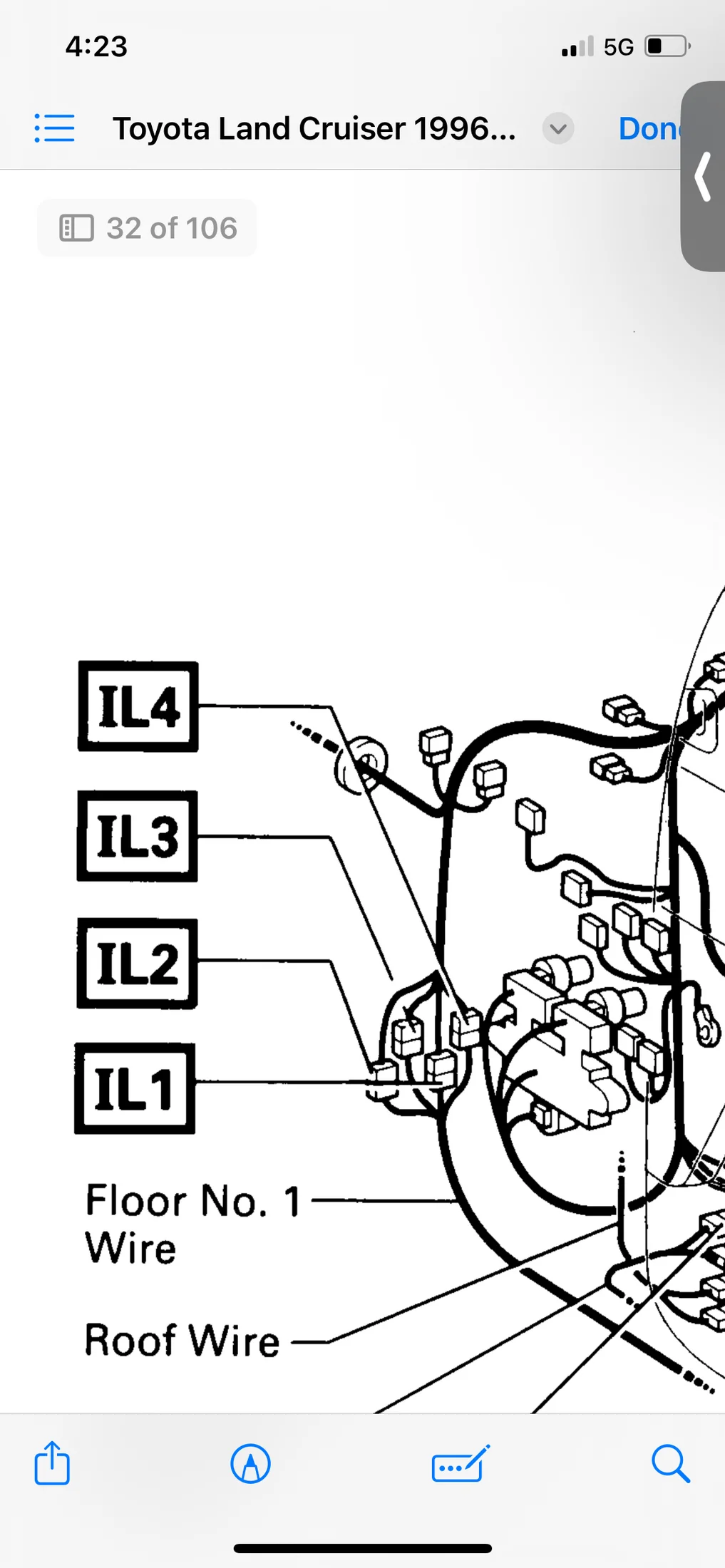

Probably unrelated but I might as well ask while I have the left kick panel removed.

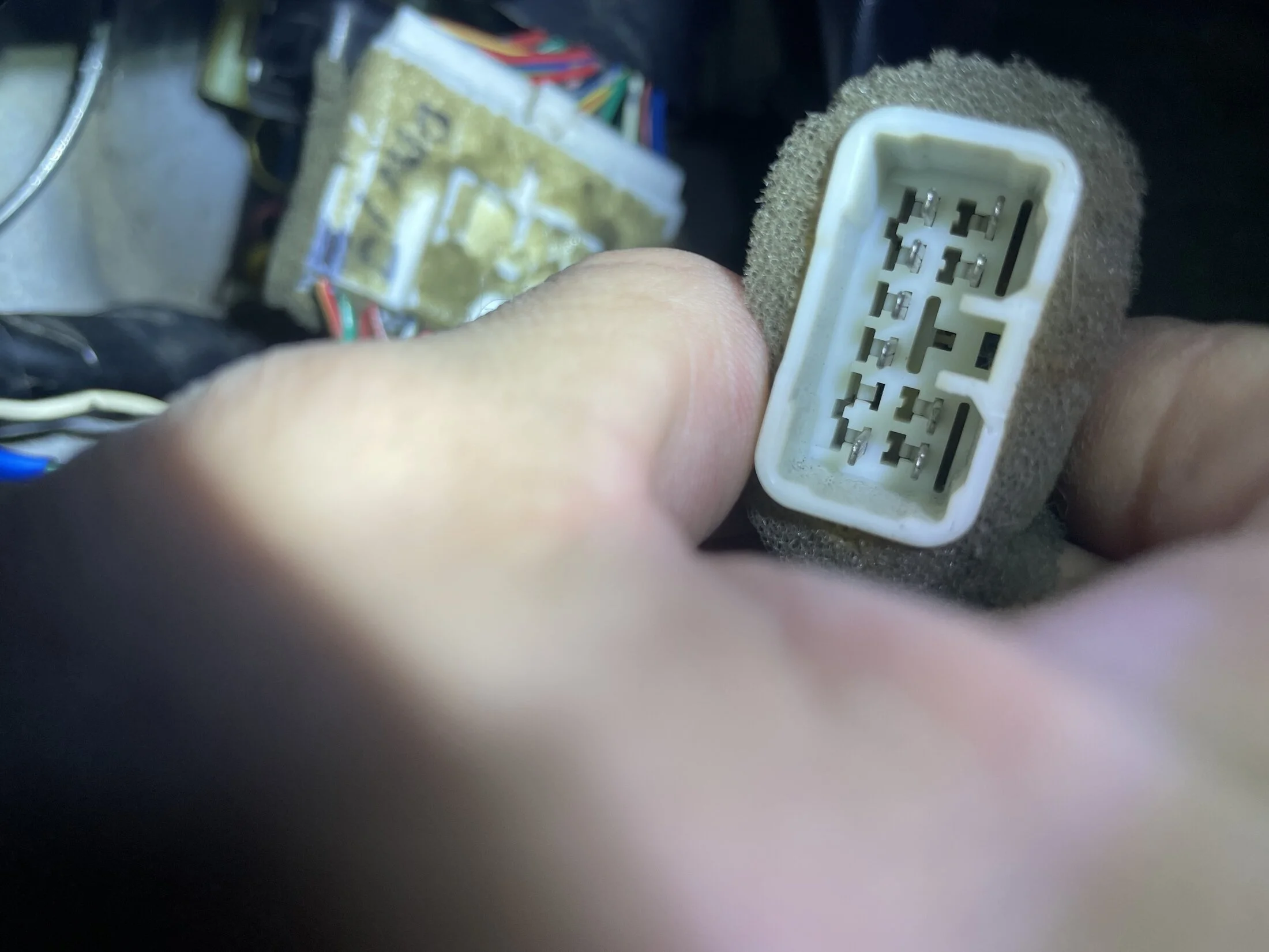

I found this connector unplugged, with no female connector nearby. Also having a hard time even identifying it with the EWD, 9 pins. Possibly connector IL4? Although this seems to go to the fuel gauge and fuel pump and those are working fine.
Any ideas what this 9 pin connector could be?
what vehicle and year? there are differences in the wiring between LC and LX, and years. the 1996 LC EWD I have doesn't even show a IL4 connector. the only connector that looks like that is labeled II2, and its in the passenger footwell serving functions like door switches, power seat, and rear heater.
1997 1FZFE LC
Yeah I noticed that connector too but location is different like you said. Oh well. Assuming it’s unrelated to my current issues since it was completely unplugged when I found it.
