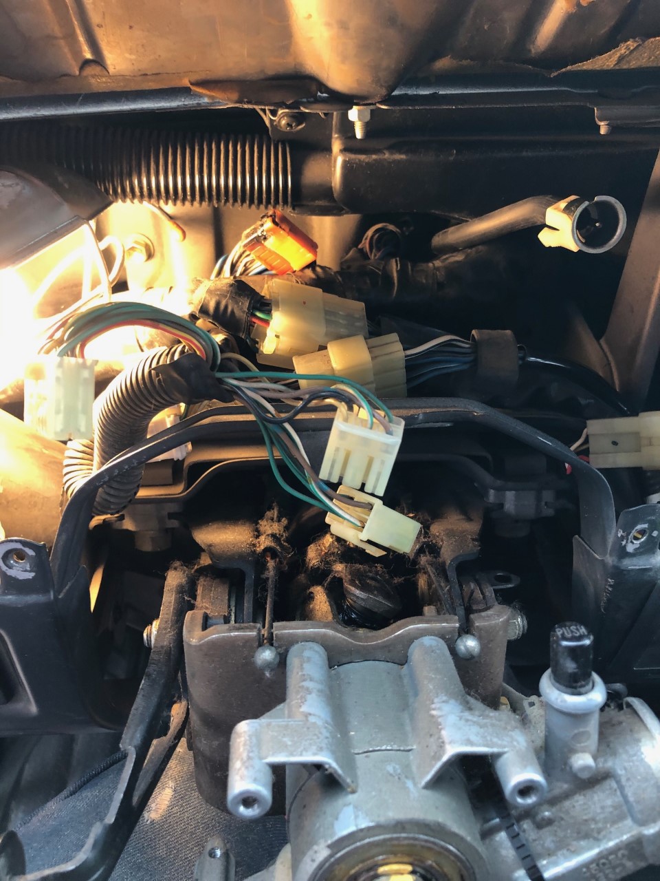

These trucks have notoriously finicky grounds behind the instrument cluster. What you are seeing is what I and other have experienced: a bad ground causing resistance in one circuit that leads to problems in other circuits that share a common ground bus. Often it's headlights, signal lights, and instrument cluster lights that display odd behaviour. I'll see if I can find a photo of the common trouble spot.
That little orange connector is what was causing my problems. Several circuits ground there. I pulled the bottom off it, pulled out the multi-prong connector, cleaned it up, put it back in, and wrapped it in e-tape. No problems since.
That's behind the dash?
While the dash is easy to take off (only a few screws), Im always cautious and hesitant to mess too much as the plastic is going to be quite brittle after 40 years.
But I'll try to get on it today
Yes, it’s directly behind the gauge cluster. Removing the bezel can be tricky - especially disconnecting the speedo cable - but if you go slow and don’t use too much force, you should be ok. It’s the right side of the bezel that is the most fragile and prone to cracking upon removal.
