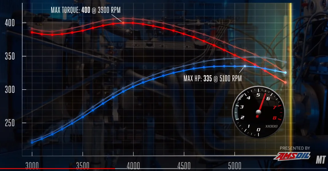

Our fan is a little over 18.5" in diameter, so slightly bigger than theirs.
Our RPM range is the same for 1FZ guys (5500 rpm), 3FE doesn't have quite go as high.
We have larger clearance to the fan shroud so ours is again worse. (completely open makes it draw more hp, having less precise shrouding makes it more "open")
So about 15 or more horsepower when the clutch IS NOT engaged. With the clutch engaged, probably way worse.
The plastic flex fan (so no clutch) dropped 23 hp. Ours is probably worse than that engaged because it's not a flex fan.
That said, an electric fan simply can't dream of competing with a 15 horsepower fan. It's just straight up incomparable. you're talking a 1 hp (at most) electric, and even with better, tighter shrouding, you just can't beat having literally 15-25 times more power to it.

IIRC from the wit's end turbo thread dyno results, stock only gets 130-140hp at the wheels, so that 5hp at 3500rpm to 9hp at 4500rpm is definitely enough to be felt (about 3-7%). But you'd probably get just as much gain by going from 15w-40 to 5w-30 oil, (that's not something I'd risk, I like my rod bearings how they are).
I don't think you'd be able to feel a gain at normal cruising RPMs though, it was down to 4hp at 3k rpm and it just keeps going down from there.
