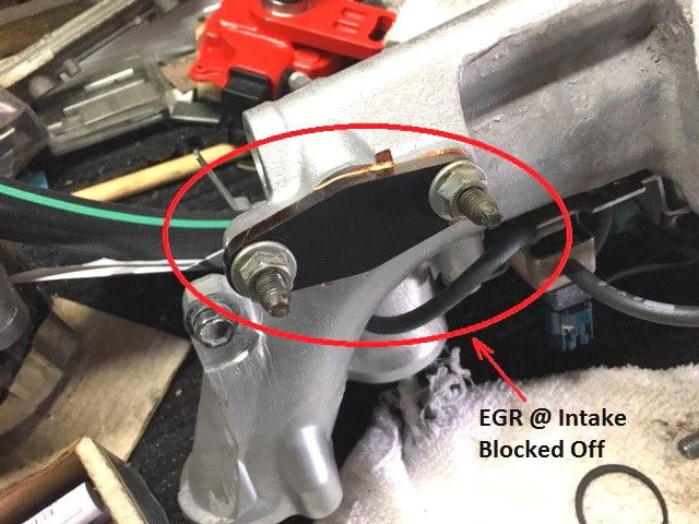

In the middle of deleting the EGR on my 96 and have a question. Have block off plates for the pipe off the head and the upper intake manifold but thought of stuffing some high temp steel stick or equivalent into the exhaust port on #6 where it feeds to kill the flow completely. Exhaust manifold is off so its no extra work. Dumb idea?
I don't see the value in doing this. If you have the ports blocked at both ends of where the pipe was then you are good to go.

It prevents hot gases from filling the runner that goes from one side of the head to the other.... right back there at the
#6 cylinder. Number 6 cylinder seems to be the most common spot for failure, so we don't really want any additional heat back there.
There are good and valid arguments for both positions (delete and block EGR or not).

All I know (in my case) is that a couple of the key-chains happened to fit the ports perfectly.....so why not use them.
